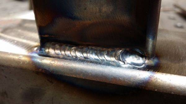

    You have to pay to play young grasshopper! Not sure if you have Tig welded much stainless but it LOVES!!! Argon and the more gas coverage the better. Everyone I have talked too on these cups say it's worth the money hands down.
    They are not for heavy pipe/Fabrication welding they for the delicate work.

    Here is a side by side of the #14 toxic cup and the standard #8 weldcraft cup.

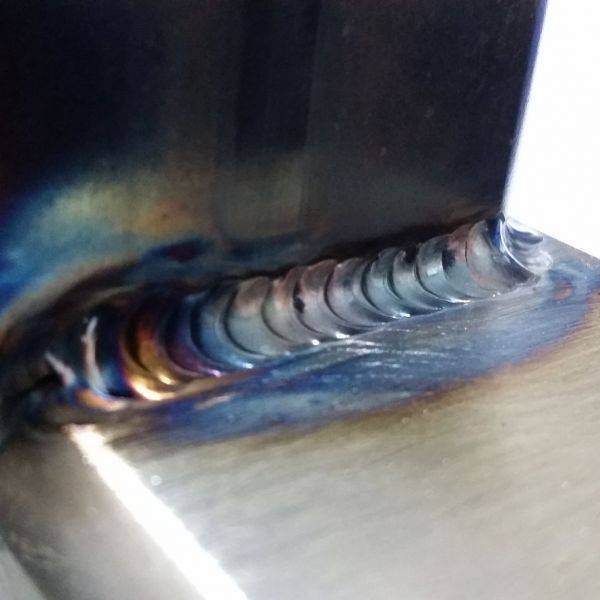

    I little test coupon on mild steel. Keep in mind I have very limited time behind the torch so the #weldporn will not be posted just yet ;)
    The cup is nice the most thing I like about it is the tungsten stick out you can see more clearly.
    Settings
    .120 Mild steel
    Miller Dynasty 280 water cooled
    peddle down dabbing
    140A
    30cfh gas flow
    3/32 tungsten stickout at 1"
    3/32 filler rod

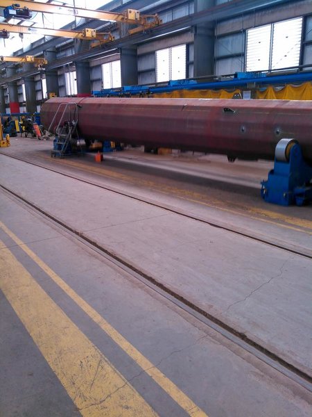

    2nd day at my new job. These are some huge poles we're welding
