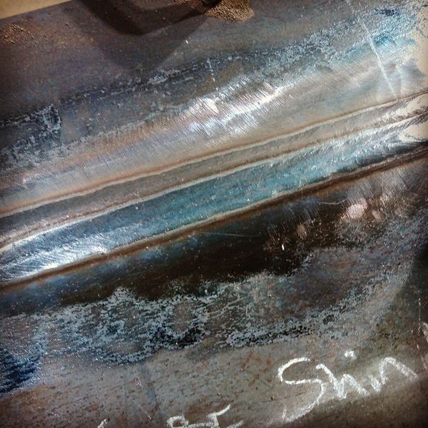

    Flux and sub arc done. Now time to knock out metal core

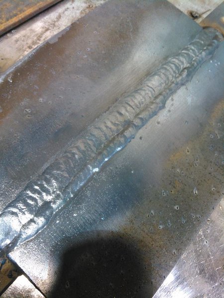

    Cap on FCAW and metal core was too wide. Gotta try again tomorrow morning. On another note, when welding flat .045 flux core, do y'all push or pull ? I'm getting not so great penetration on my backing strap and I think it's cause I'm pushing and the flux is getting in front of the tip and cause a lack of penetration. Flat of course. Might try pulling it tomorrow.

    AWS says always push solid, pull flux.

    Hmmm. Not familiar with flux but I'll bring it up to them tomorrow and see if they'll let me test by pulling.

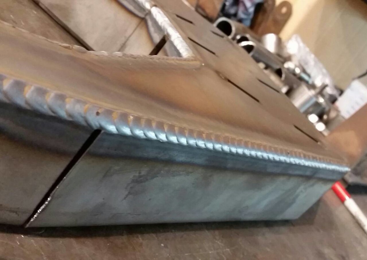

    Finally getting the new MM252 dialed in

    Looks robot welded.

    Reserected from the dead.
    I was gonna say the same thing. Check the back of that dudes' neck for a bar code/serial number.
