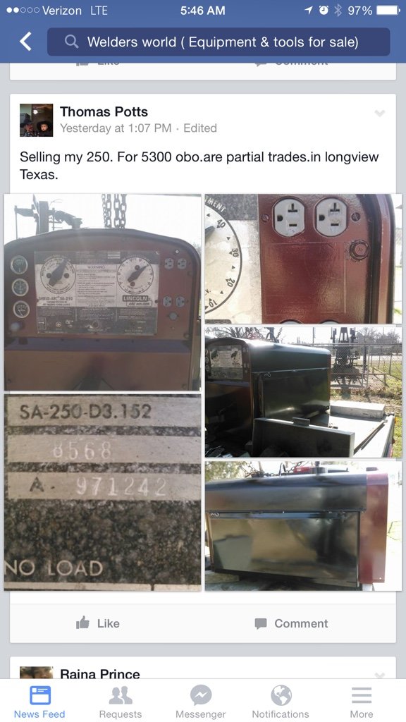

    I doubt you're on the welders world Facebook page, but there's welders for sale in Texas pretty often. 42cedb2ee27211a8385789c8e80fdca1_474cbcdcd23e8c0f246c6a0ec201256bfc35680d.jpg

    I'm on the page now. Thanks for showing me that !

    So many welders for sale on that page :goingcrazy:
    I needz loan :drool:

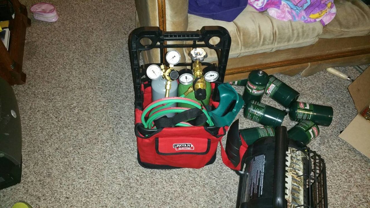

    first going to melt 100grams go 18k gold to make something. Then braise a 4 way mixing valve. (overkill)
    Cutting and welding. this is just the start.

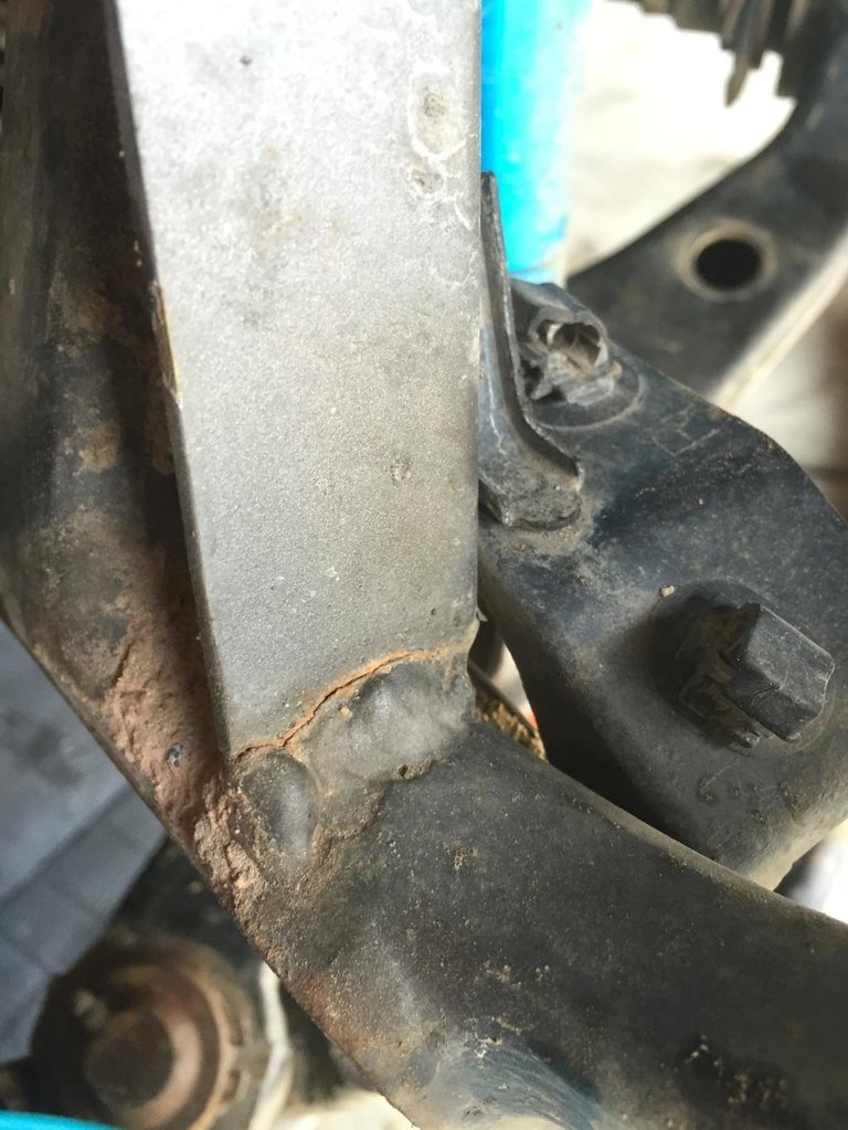

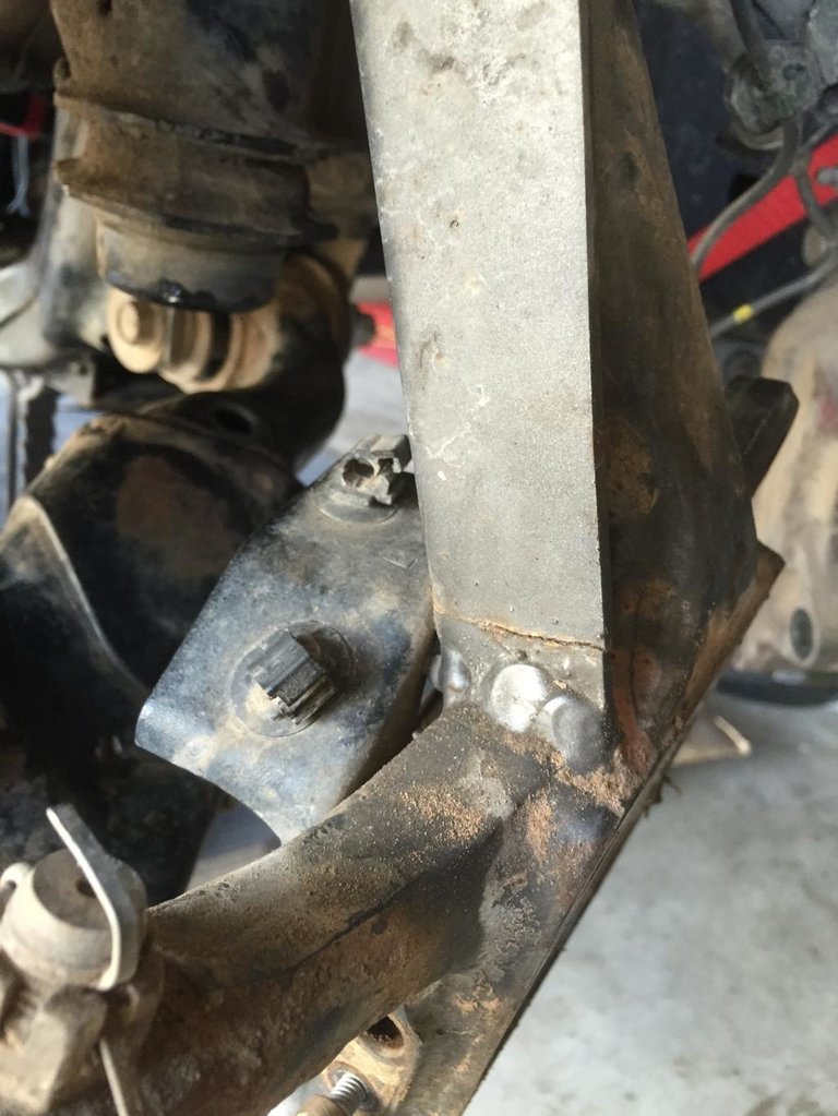

    Cracked my TC spindle gussets, just re-weld, or sign of a bigger issue? Is this common? Shitty weld? I was thinking of adding a gusset down to the tie rod arm as well, similar to the sway bar version.

    Although it looks like the failure happened on the gusset side, was the proper pre-heat and post cool/Ni filler metal procedure followed when these were welded on?
    Those welds do not look very sound, either.
    I would say a whole new set of spindles, IMO.
    The overall integrity has already been compromised.

    I did pre-heat and slow cool them, as you said the failure is on the gusset side, would the treatment on the cast section affect the gusset as well?
    Yeah, not super proud of those, they were hard to reach with the nozzle, the rest of the welds look better, checked the rest of the spindle and they look good.

    I guess it depends on how much the spindle moves without the gusset. If the spindle flexes during normal driving/wheeling then the failure comes from trying to stop that movement with an inadequate brace. The brace is going to be the failure point in that situation.
    So, which direction of movement caused the failure? That's the question. If it's shock loading from the tie rod, then your extra gusset may help some. I say some, because the gusset doesn't brace the spindle in the direction the tie rod forces are coming from. In fact, I don't know why they would add that gusset in the first place.
    It should be pretty easy to weld that gusset up again though. If it were me I'd use a cutoff wheel and open up the crack. Lay in a nice hot bead and go with it. If something else breaks later on then pick up a new set of spindles. Just my opinion.

    Thanks, that is kinda want I was thiking and planning to do as well.
    I would think it is from the spindle pivoting/flexing down and putting that spot into compression/flexion at that joint. I think it is a shitty weld, but being stressed excessively at that spot. In ding some research, others have cracked theirs there as well.

    Yeah, I'd imagine that you should be okay. I don't know much about these gussets, but it seems like there's a little debate about the overall design behind them.
    Seems like most of the guys weld them without removing the spindle from the truck. Which, quite frankly I take as being asinine. Most of the install pictures feature less than passable welds as well. Sounds like you're on the right track with doing the proper pre-heat/post-heat and the fact that you had them off to weld them initially.
    They're forged, rather than cast. That being said, I'd look for a new set if any further cracks appear.
