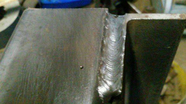

    Got to break in the eastwood today. Practically built a hay ring (it was an old one and in 5 or 6 pieces i put back together) and i was impressed how well the welds looked even in the spots i couldnt get good and clean. Then i made a platform for the machine to sit on so the side door could clear the brace on the cart we had. This was prolly a top 10 weld for the day, had a few better and alot worse but over all really happy with everything. About 4 hours of cutting grinding and welding total.[​IMG]

    Just realized that pic looks severely undercut but its an optical illusion. Its actually just more than flush.

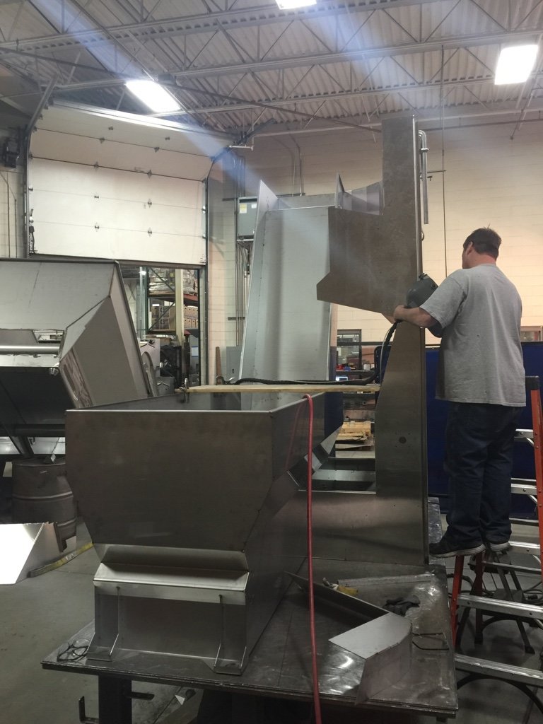

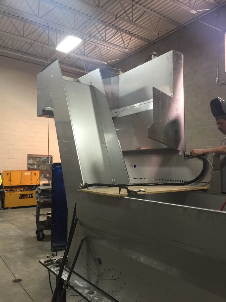

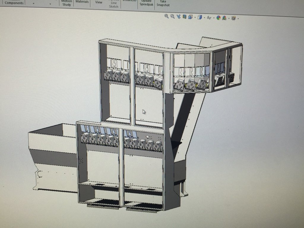

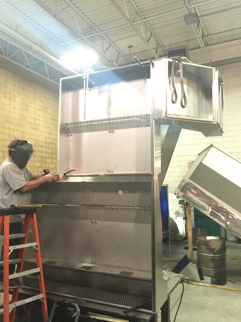

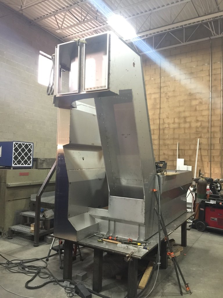

    The first project I've been designing and managing at my new job is finally getting welded up. I ran into a few hurdles, so it's been a lot of long days. I like the overtime though. I think we scrapped over $2000 of 304 12 gauge due to the k factor in solidworks not matching our press brake bend allowance.
    All of the tabs lined up perfectly and this whole thing was tacked together without any filler rod. Only fusing at the tabs.

    That's sick! I want a job like that
