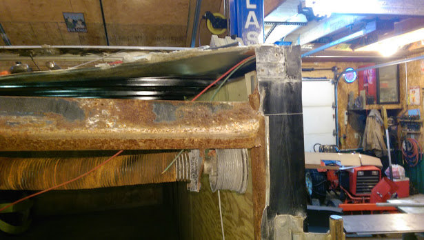

    Quick question on how to price a repair job.
    I repaired the corners on the fold down door frame on a steel, covered trailer. As you can see, the torsion spring door assist, cross bar had copletely seberated from the door jambs. I had to remove all the aluminum cladding and sheet aluminum to gain access to the cross bar. Basicly, the only thing holding the door frame top bar in place was the aluminum roof sheeting.
    I spent way more time removing the aluminum skin than I did actually welding in repair plates on the 4 corners of the door frame. I figure I have a good, solid 6 hrs into removing and replacing the door torsion spring assembly and replacing the aluminum skin. If I spent 45 minutes actually welding in the repairs, I would be suprised.
    I have no idea what to charge for this repair. Anyone want to toss out some numbers? Mind you that I do not run a fabrication buisiness per say, just word of mouth gets me all the work I need.
    I'll prolly put another hour in checking wheel barings as well.
    Sorry, ran out of time before I could snap an after picture.

    As a side job, I'd think maybe $200.
    Seems like it would be fair, cheaper than any shop would charge him I'm sure, but still decent money for your time.

    I did a swing open door frame repair on a 53' trailer, and repaired some rust holes in the C channel frame. It took me 3 hours. I charged $100. It was -12 degrees when I did it. Eff that.

    I like $200. That works to 30/hr.
