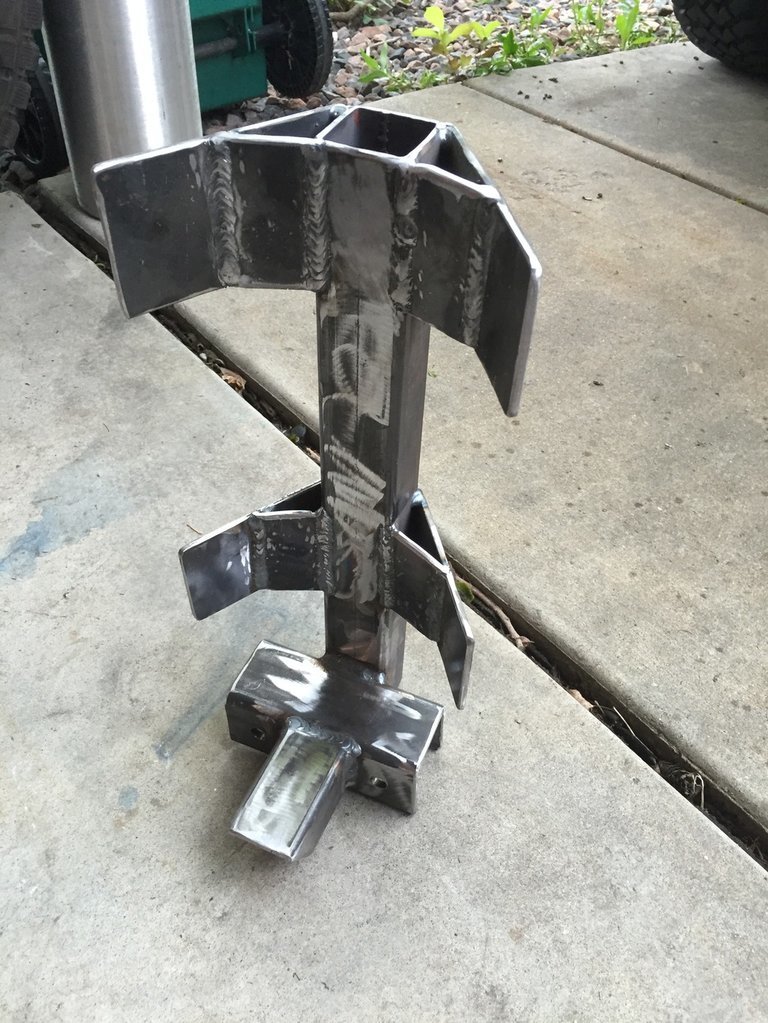

    Here is what I came up with, will bolt to the swingout I just built, all 3/16"

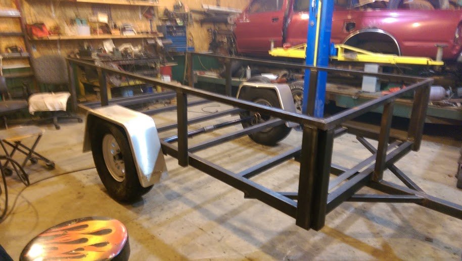

    Decided to build me a "scrap iron" trailer. Not to haul scrap, its just made mostly out of excess iron that I had left over from previous trailer projects. I always buy just a little extra every time I buy the materials for a trailer. After a year of so, I build me a trailer to keep or sell.
    Here is an hour and half of work. Took me some extra time because the axle was way too wide. I had to cut it down and weld in a sleeve.20150518_153434_9271caaa69eab7aaf7741a934c740942c7949758.jpg

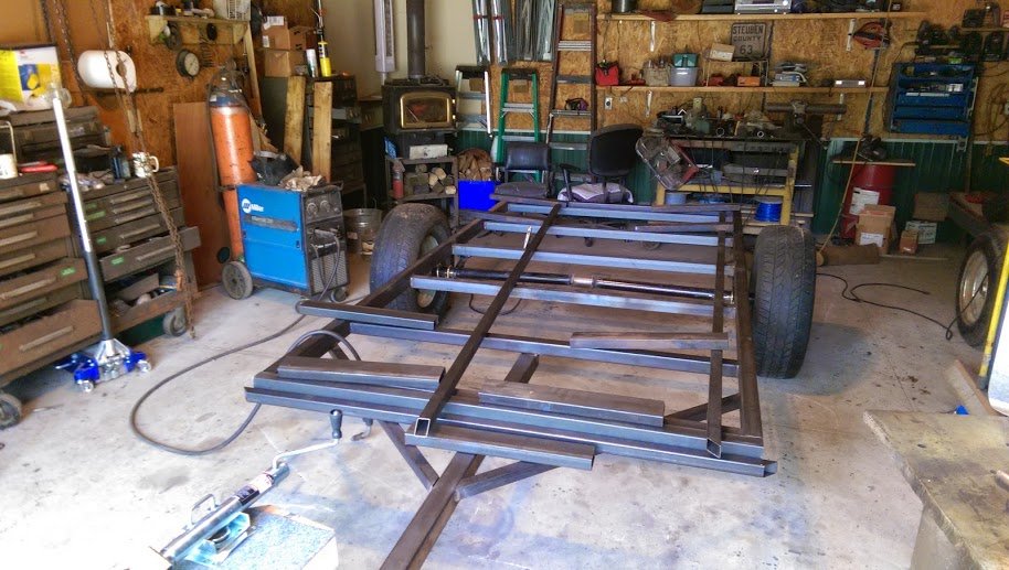

    This is this mornings progress. I only get an hour or so a day to work on the thing. Been working 12 hour night shifts for the last 5 nights.20150520_075003_b172e6cd1a70df8cba67acb0da4a358abb42ff7f.jpg

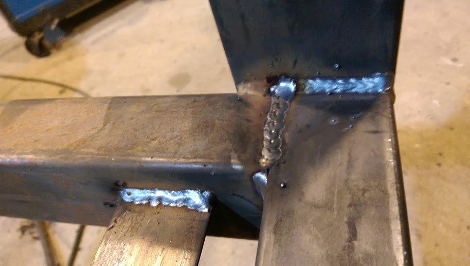

    The tube steel is 14 gauge, so burn thru is a pretty big possibility. To save time moving from thicker to thinner iron, I just do more of "spot" type weld.20150520_071753_5719aa2db3ee998b2573cb53570f3465209f9415.jpg
