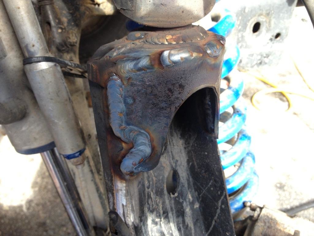

    I'm a welding fool today. Going pretty well thus far. This us on my tundra lca bushings were siezed. Cut the arms out and pressed out the bushings. Welded straps onto arms to gusset the bushing eyelets. Don't wanna have a second Gen oops happen lol
    Then straightened a few bent tabs back and welded being them. They will never bend again. Half way done. One more arm to go.

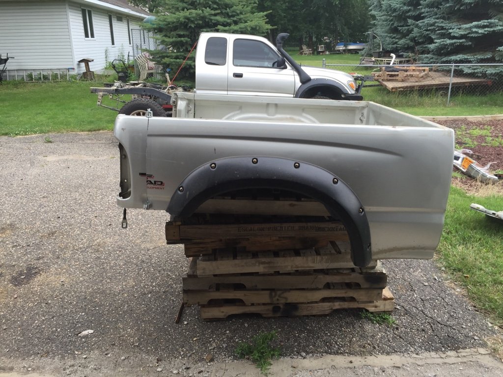

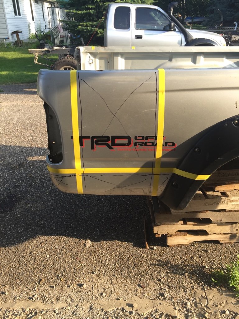

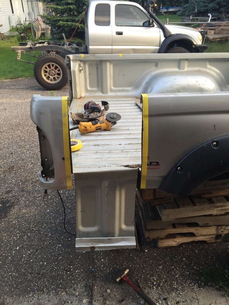

    I started my new project yesterday. Body work isn't my favorite kind of welding...
    45acp likes this.

    I've always wondered, that's pretty thin metal huh?

    Ridiculously thin. It almost cut too fast with a cutoff wheel.

    when you do the other spindle make sure you run it way hotter and go way slower, make sure you are preheating the cast too

    Ur decal looks a little screwed up now

    Already done. I did preheat the cast with a torch. Not crazy hot but hot... I felt like I had a decent puddle? Melted the cast first and swiped over to the gusset and back. I'm learning clearly but I think it came out decent?:confused:

    Pretty sure the spindles are not cast.

    Yes they are.

    Every year of Tacoma spindle is forged not cast. Your are correct.

    Well I was wrong, I admit defeat. They are forged.
