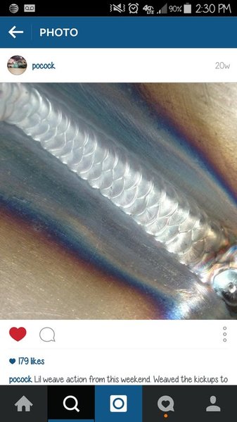

    My friend showed me this "fish scale" weld. Thought it was trick.
    95 taco likes this.

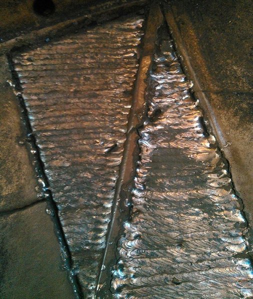

    So. Much. Welding lol. Yes theres a crack and couple nonfused spots. We were filling in cracked spots on a wheel. Some chunks of steel had worn out and broken off over the life of the wheel and we were welding it the wheel back to being balanced for the most part. This was 4 layers of beads using some weird cast iron 1/8" rods. Think the rod said 646 or something similar on it. uploadfromtaptalk1441920877266.jpg

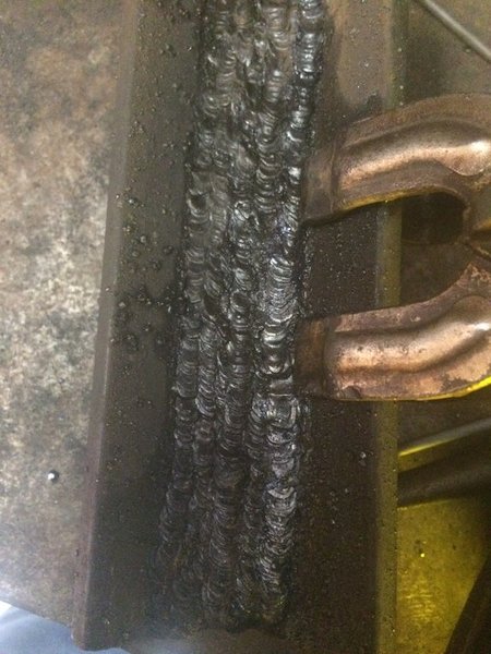

    Flat, trying to fix a decent pad to put my vertical on.
    And vertical.
    1/8" E6010 DCEP, current is set at 88.

    Practice practice. Stop trying to "time" it and watch the puddle. You should be able to watch it fill it and know when to move bases on how the puddle is reacting and flowing, not based on any kind of time figure

    Practice Practice
    Only use the numbers of the current control to get you close !!
    In my day all we had was a dial and a arrow pointing up .
    So many get into a bad habit of trying to use the same setting then when they have problems the get frustrated .
    Conditions change all the time .
