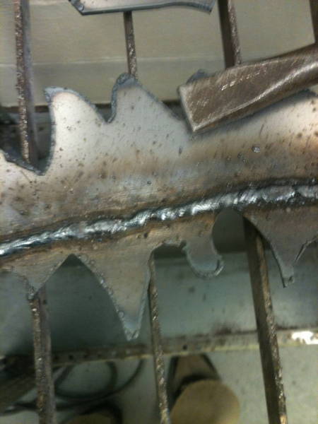

    I started my TorchMate water table today its a beast. 24ft of 2x4 .120 wall tube and 26ft of 1.75" .120 wall round tube so far I still need to weld on the 16g sheet for the water pan and then mount the TorchMate so I can cut the slats, gussets & feet for the casters. I'm over building the table so i can store 1000+ lbs of plate under the table.

    ^nice:cool:
    edit: what shielding gas are you using?

    75%/25%

    Jerry, man...dude. That is so nice of you to build me a table! You're awesome! Thanks!
    Seriously though. That's an awesome looking table.

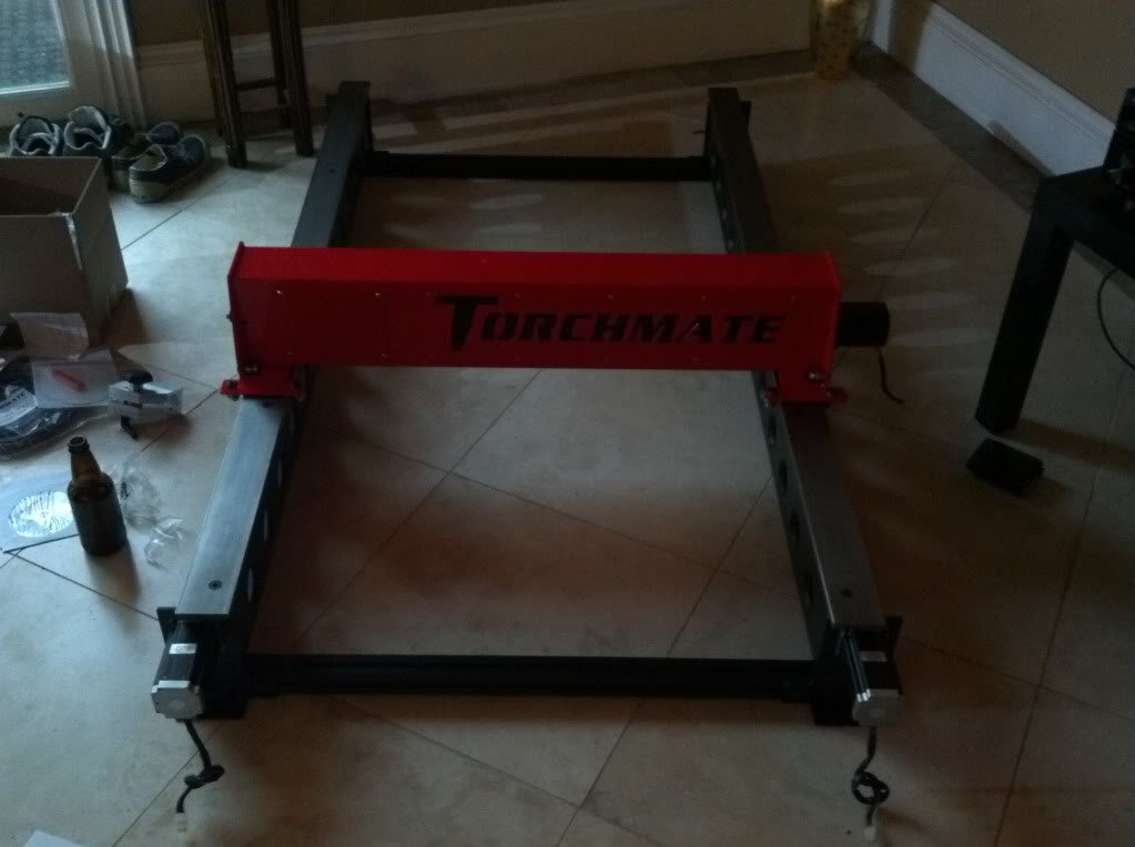

    Thanks man it will look a hell of a lot better when I mount this bad boy on the top of it :D

    now that's just beautiful welding right there.

    Thanks man I'm trying to make it look pretty :D
    I'm still waiting on my machine torch so I can't do any cutting until Tuesday :(

    Nice weld, looks like the kind of weld on bicycle frames, sweeeeeeeeet!

    gotcha. I was just curious if you liked to use a lot of CO2 for that thickish stuff.

    I forgot to ask. Which machine torch did you get?
