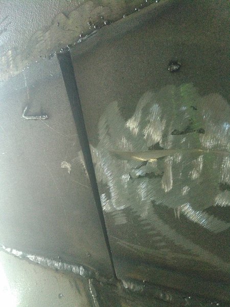

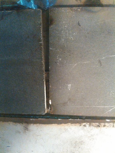

    I only have about 3 months shop xperience with fluxcore and this job is my first field experience with it. These gaps and fitment is killing me lol.

    Wow. Our welders would just laugh and walk away (while laughing) at that and tell the boss no way in hell they are welding that. Then tell the shipfitter to go back and try again lol.
    I cant remember exactly what the spec is (been awhile since ive dealt with it) but anything over a 1/4" and the welders can shut it down. Thankfully the welds usually work with us and will weld up to about 3/8. Course being short on nuclear stuff is a hassle so they work a bit closer with the fitters.
    But like anything we work to Mil-Specs and requirements so bit different than other industries.

    Believe me. I wanted to bust heads but the fitters have 5+ years experience in this field and I have... 9 months. And I didn't wanna be a typical welder cry baby so I just worked with it but the difficult part was planning the passes. Like the top part would be 2 stringer small weave passes to me while the bottom would be one weave. But it all needs to look uniform when finished so it was taking forever to do 10" of weld. Repeatedly.
    It all pays the same but dang it gets frustrating when you're used to dealing with WPS and gaps in spec.

    Weird something like that for the 5+ year ship fitters and the fitters would be getting a good talking to and then told to go fix it lol. Even on the non-nuclear side that wouldnt fly. But i suppose thats just cause the tolerances for government are a bit tighter.
    One hting i learned before my new job is to never piss the welder off as he can save quite the headaches! had a couple welds he saved a some explaining and headaches just by welding a *cough* bit of a big gap.

    Thats garbage, wheres your QC? Your boss?
    Are you letting the welders fit? :D
    Its time for you to grab a dog and a wedge or a hickey stick and make that right.

    :laugh: nope! The fitters are tacking tho... And yea I'm just stacking welds to cover the gap and get fusion. Ima spend some time grinding after its finished and try to clean it up. QC doesn't check till job is finished usually and boss just trust the fitter.
