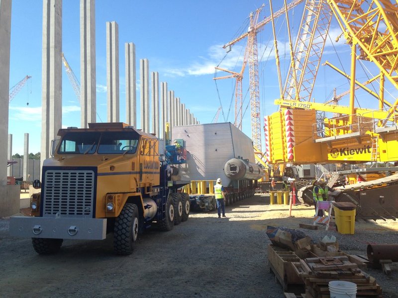

    4'' plate to 4'' plate. wonder how far the weld actually penetrates. sorry it's blurry. took the picture at 5 this morning.

    Here I thought you were having a bad day.
    Just what is being built ??
    Any Chance those welds could cause a serious failure down the road.??

    What form of transfer is this?
    Nah these are my welds from the same silo that we were working on uploadfromtaptalk1444428775189.jpg
    They couldn't cause a major failure but it is definitely gonna be a maintenance problem. The plates are fully welded on all sides so a couple shitty welds is highly unlikely to just cause the plate to fall off. However once cracks develop and coal starts falling through the cracks, its gonna need to be addressed.

    no idea. it's the weighted front bumper to our heavy-haul subcontractor
    two 4'' plates welded around the perimeter, with 3 holes on the centerline, with "dowels" welded in.

    I'm sure they had some sort of bevel in there. At least you'd hope so cause you'd get practically zero penetration with butt welding material that thick
