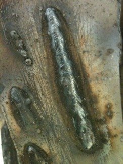

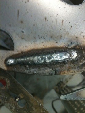

    Nothing to write home about but it's getting better I think. I had one okay lap joint weld and the rest looked like poo

    45° weld. Set heat to thicker metal and focus heat on thicker metal but enough so your puddle runs into the thinner.
