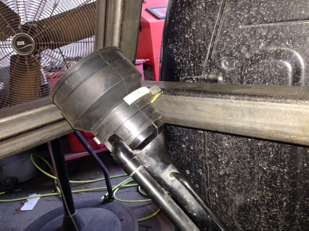

    Or you could use a plumbing fitting like I did. :D

    :rofl: I have plumbing fittings on my aux fuel tank filler neck.

    Whatever works!
    I haven't had a single problem with mine. Oh, and I may need to pick your brain on the tank. I need to add an aux tank in Bandit. 250 miles a tank while towing Smokey gets old real quick and I don't want to pay two grand for the DOT approved transfer tanks. :D

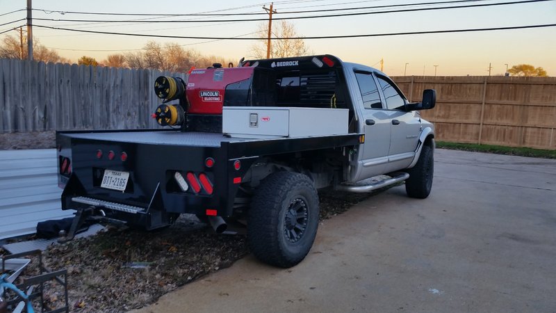

    Just do 1/8" all the way around. Most flat beds have 4" channel mains, and 3" channel bracing. Top on every flatbed out there is either 11ga or 12ga. I actually just had a Bedrock flatbed put on my truck yesterday. I'll post a pic in a minute. Mine came out to $2100 for the bed, $500 install, and $900 for the tool box.

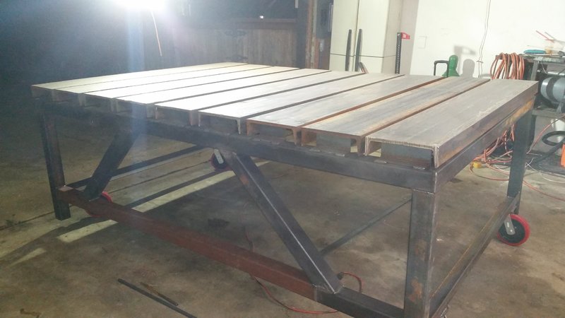

    And I built this table the other day. Best part it it didn't cost me a penny :D20151206_180906.jpg

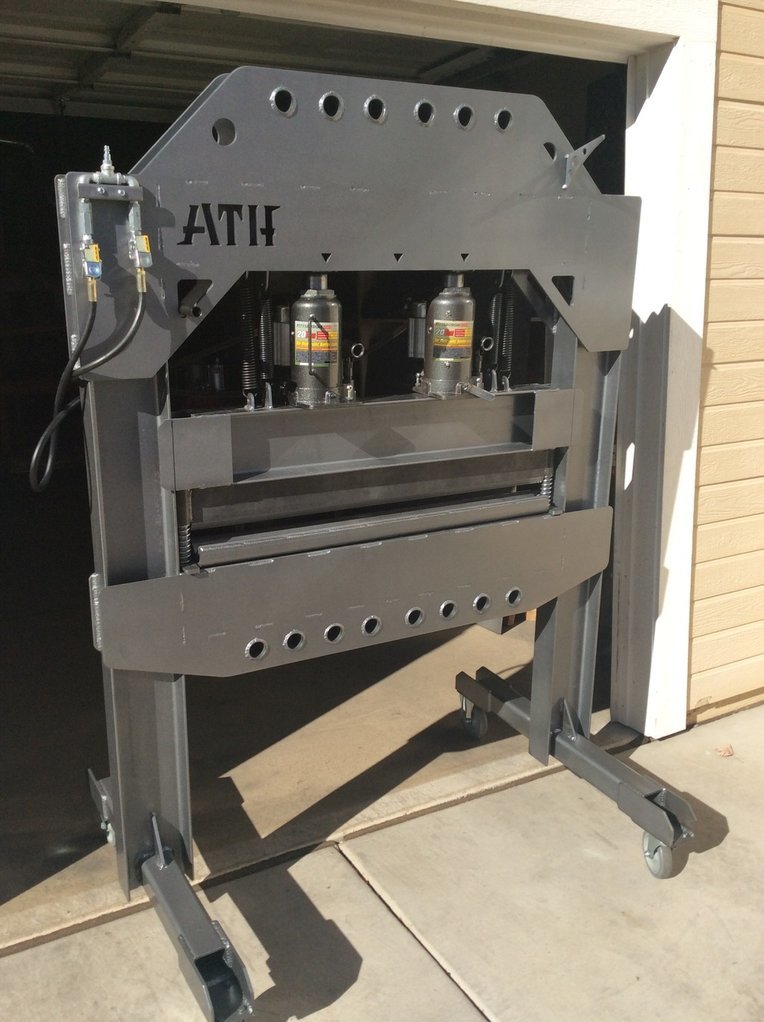

    It's awesome. I ditched the dual 20t air jacks because they were a pain to get even bends. I ended up getting single 50t air/hydro jack and it works much better.

    Nice table!
    Mine is similar but I left the slats spaced 1.25" so I could clamp to the table's surface.

    Do you have a picture of your setup? Does it bend heavier steel pretty easily?

    I posted a bunch of pics of it a few pages back on this thread. Here's another one though.
    It'll do 37" of 3/16" with ease, not sure what the max for 1/4" is but probably around 24".
    0F260E1F-9DFD-4EE5-B16E-0F2F239C93B9_zps_0efb45bbffc568b43e84906839592d1a60f3eb55.jpg

    That looks great. Thanks for the picture.

    They weren't spaced of yet in this pic, but I've got mine 1.5" apart. How did you do your clamps?

    Nice looking rig !

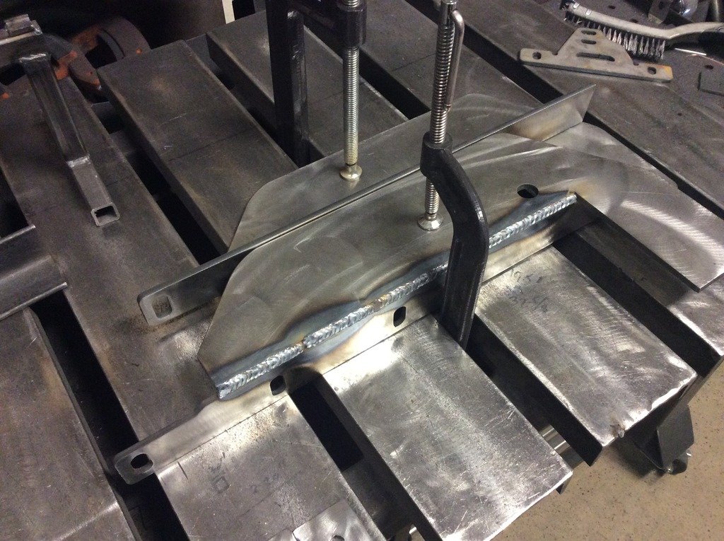

    Just using c-clamps. The pcs on the table are just clamped up as an example. You could probably make some slick clamps that hook into the C channel though :cool:
    00941C72-5B5B-4AA5-8551-83AF4EEB8804_zps_d8a99508084a197547daede7fd07af13250cdafc.jpg
