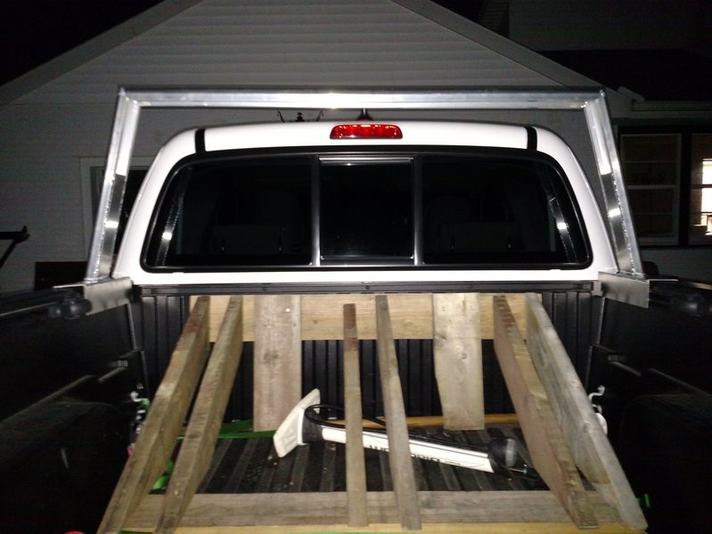

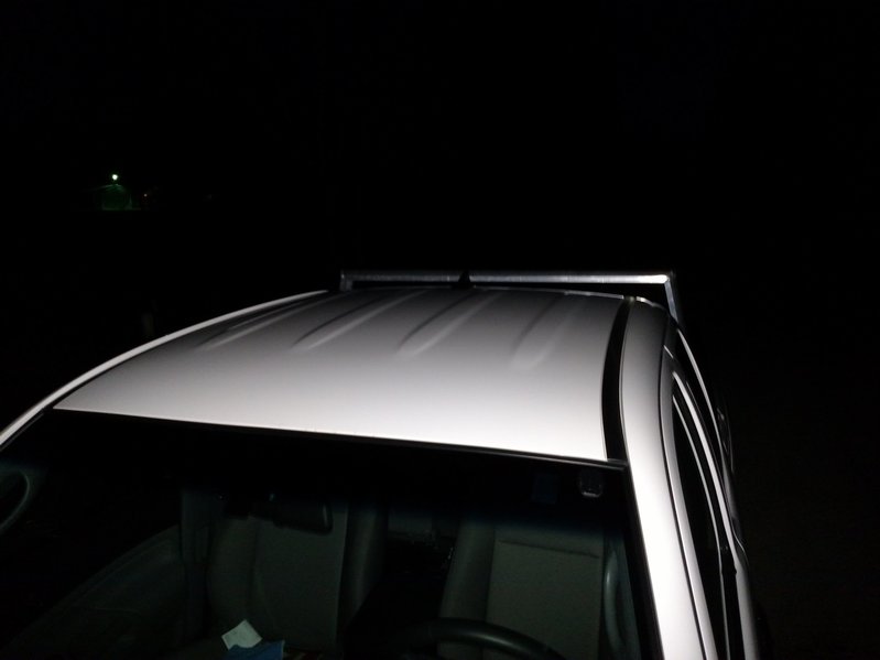

    Made a arch for lighting and tarp camping. Not quite done, finish up after the holidays

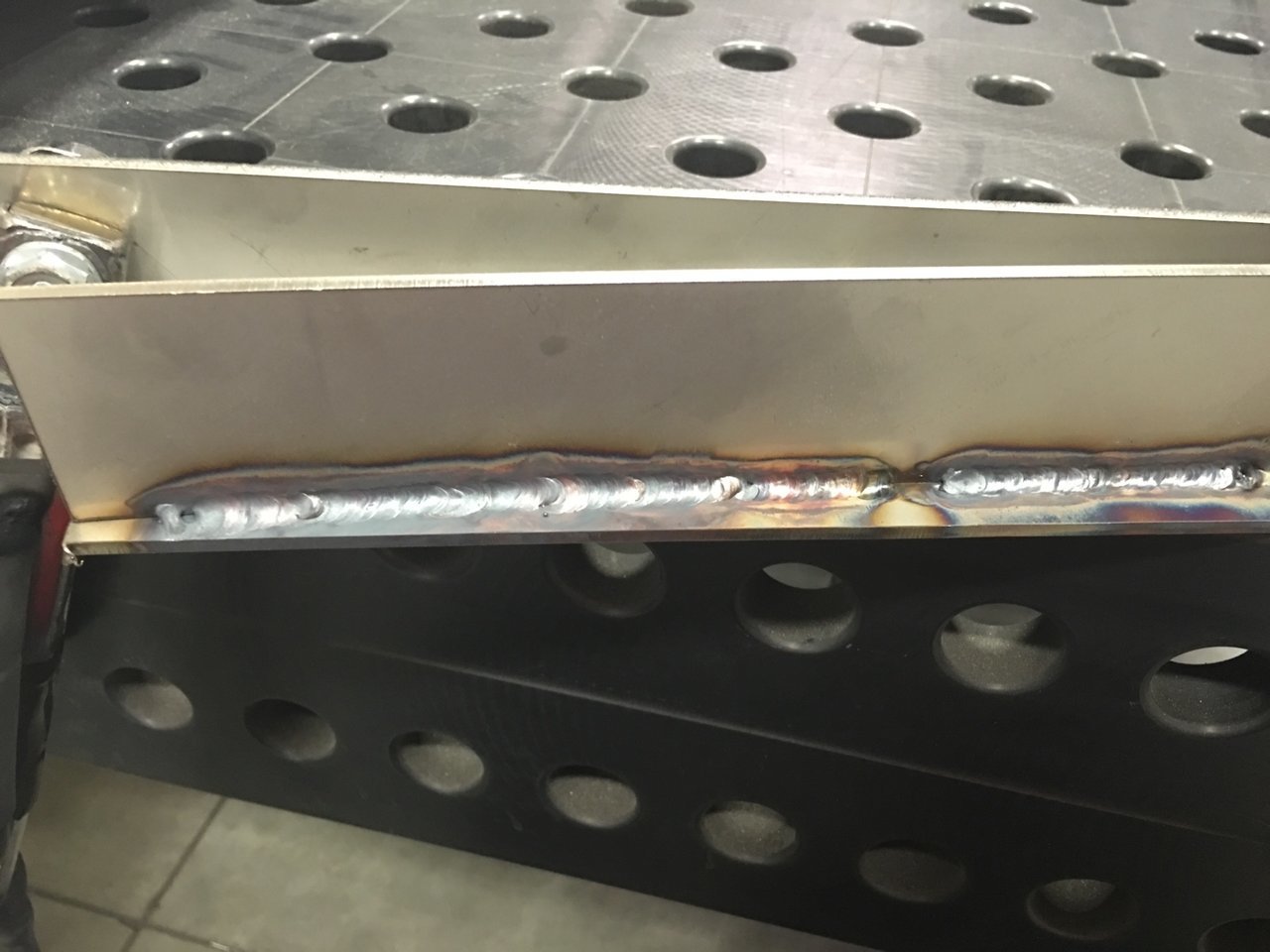

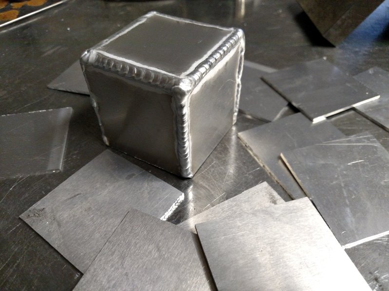

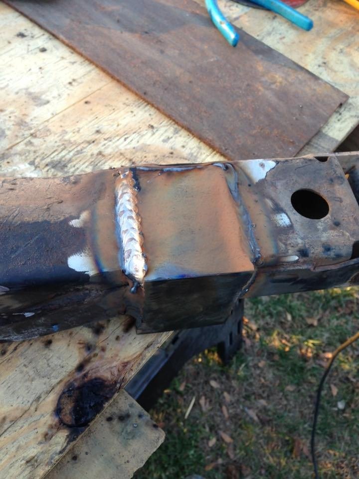

    My first ever attempt tig welding stainless. Self taught. I don't know how to control my heat at all. But I didn't think it was too difficult to grasp the concept.

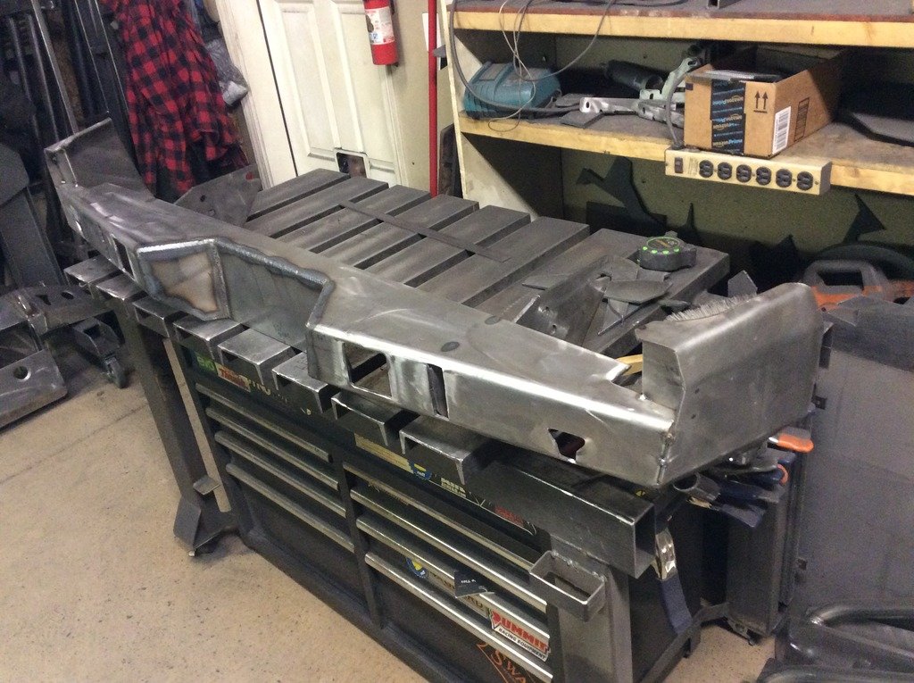

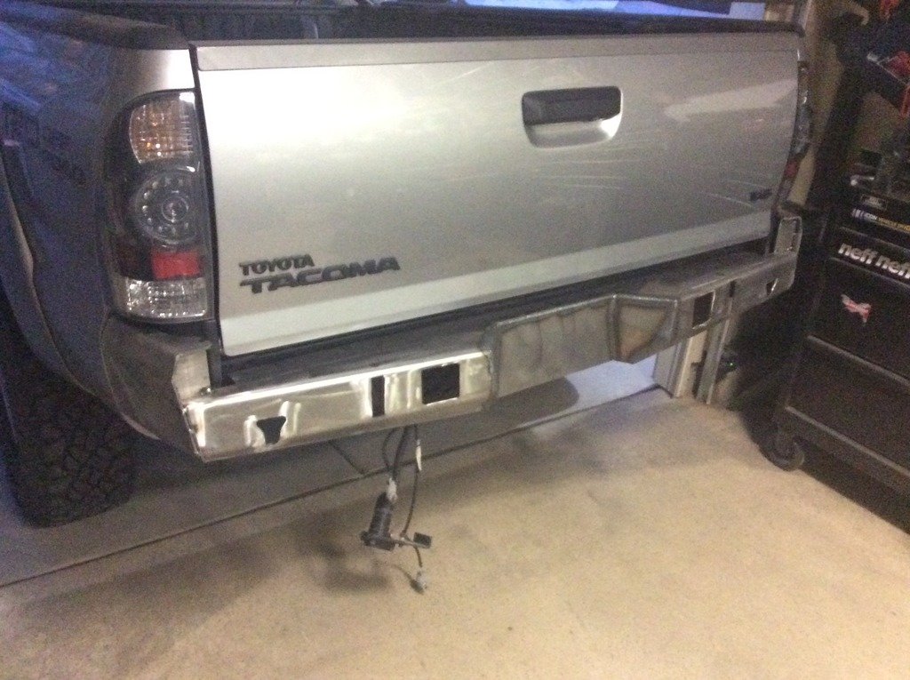

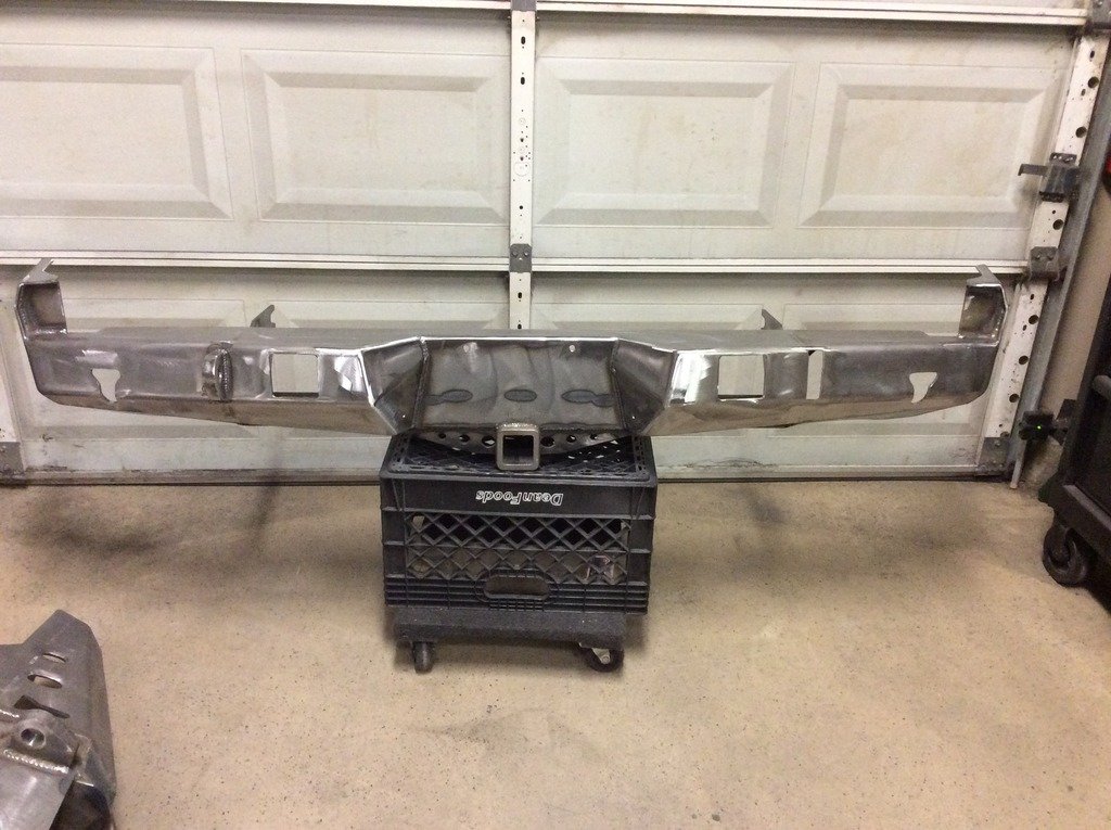

    Been working on a rear bumper the last couple days... Can't decide if I want to put the receiver behind the license plate or below it.

    Do you pull the same trailer ??
    Figure where the proper height will be and place it according .
    Easier to have a longer drop if needed then be to low.
    Is the receiver just for recovery??

    That looks great man! Behind the plate with would really make that bumper clean, but you would need to fab up a hitch. 3/16 steel?

    I pull rental trailers sometimes, I figure I'll need a drop hitch either way. It'll have shackle tabs for recovery.
    3/16" hrpo for the shell and 1/4" hrpo for the mounts.

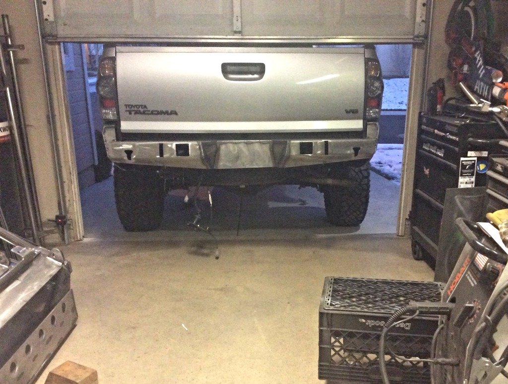

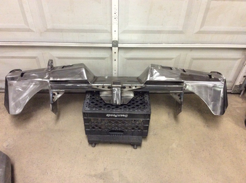

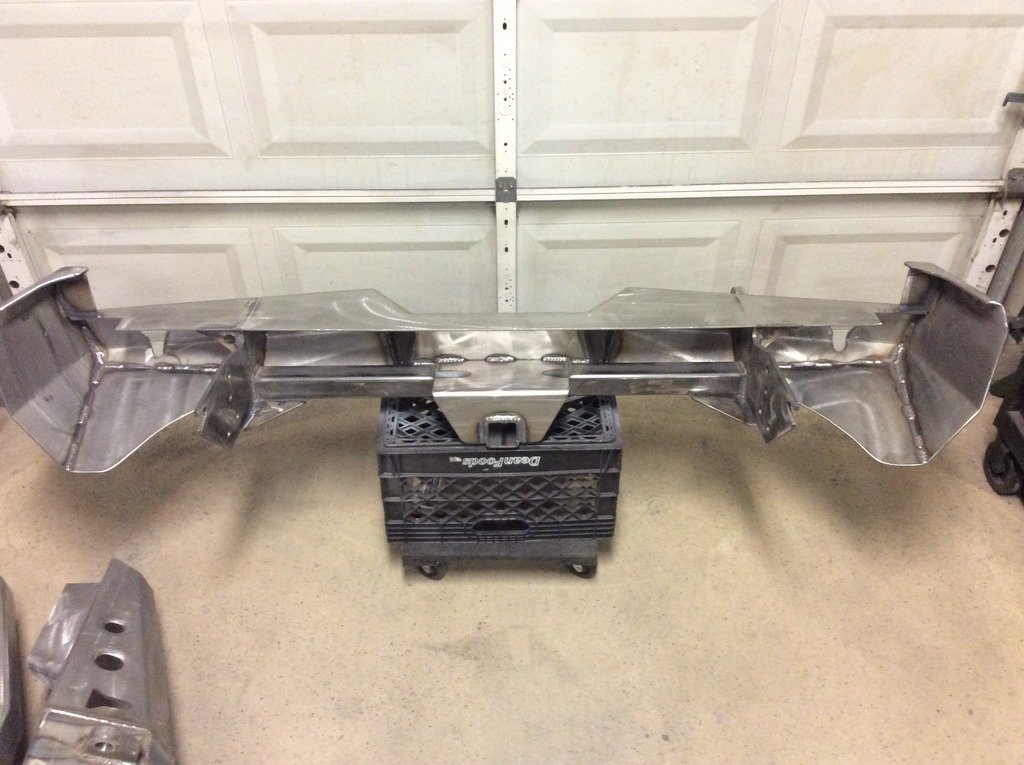

    Got some more work done to my bumper. I'm waiting on more shackle tabs to come in, and just need to tab the lights and trailer plug. Can't wait to get it painted and installed!

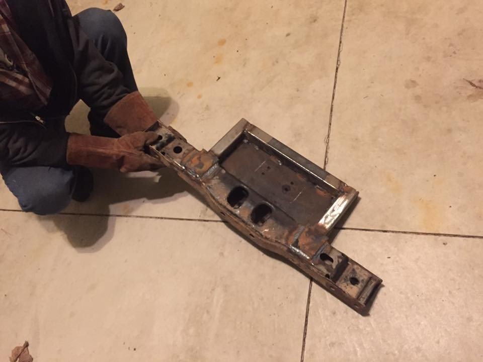

    Just made an extended crossmember for Homertaco's crawler box. 1/4" angle iron, 1/4" square toob, and 3/16" plate, might be a little overkill but rather be safe than sorry, plus is was all scrap metals I had lying around :D

    Lets see it with the paint on??
