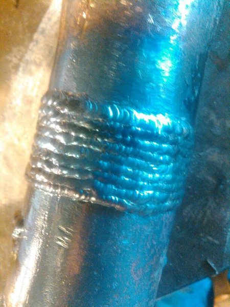

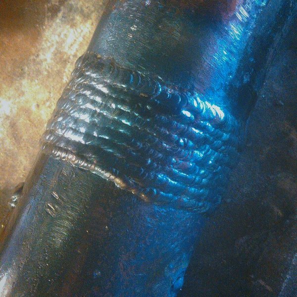

    I would say throw in more filler rod to get less of that undercut, steady hand an practice you'll be gold. X-ray will be your worst nightmare in pipe or bestfriend lol ..

    No undercut actually. Didn't even have to file any down. Picture really sucks lol. Yea x-ray sucks but can't be a structure welder forever. Tube welder is where the money is anyway !

    Kinda looks like undercut.. Never seen tig that dirty on the edges . An money is there just have to find it

    :notsure: can't see any shadow with a flashlight or catch my fingernail on it. Maybe because its old drill stem and its a porus dirty metal?

    maybe I'm blind. that top bead its not tied in on the other side maybe just the photo

    Definitely photo lol.my phone takes pictures as good as a potato uploadfromtaptalk1455906178255.jpguploadfromtaptalk1455906183234.jpg

    Have any pictures of the other side? The top side does look like it's a bit undercut.

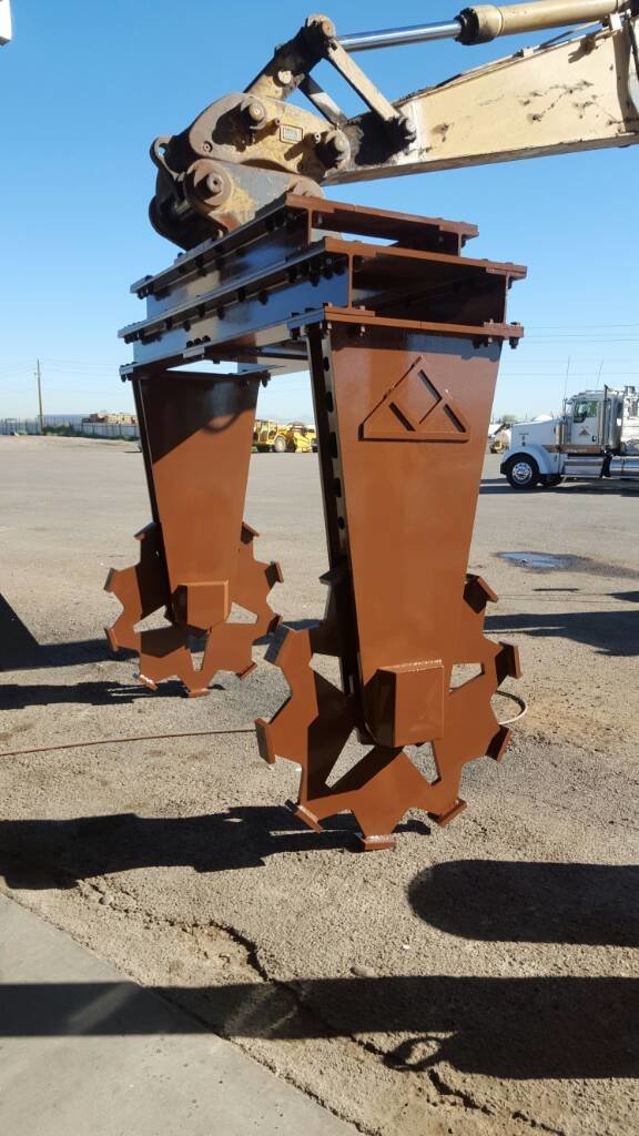

    We built this thing at work

    What exactly is that "thing"?

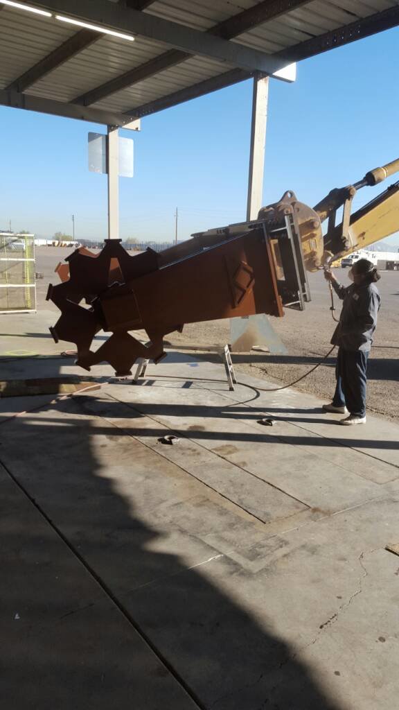

    It's a compaction wheel for an excavation 867fe7235ea7b25c2642f46df5feb038_2d5cedfc61326fc0700eb298fa0e1a1c90cdea14.jpg

    Had to look that one up. The one you built looks to have a very specific excavation to compact as the ones I saw had the wheels lined up side by side.
    Ya learn something new every day! :D

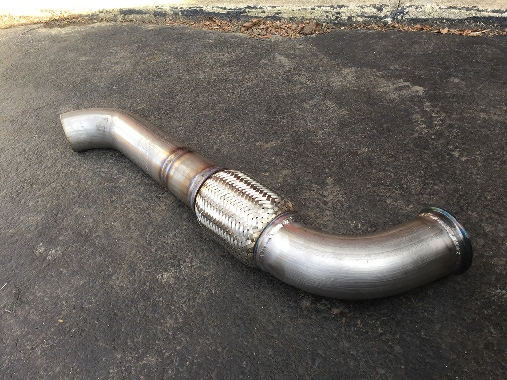

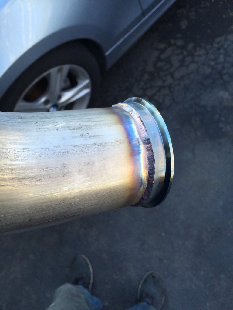

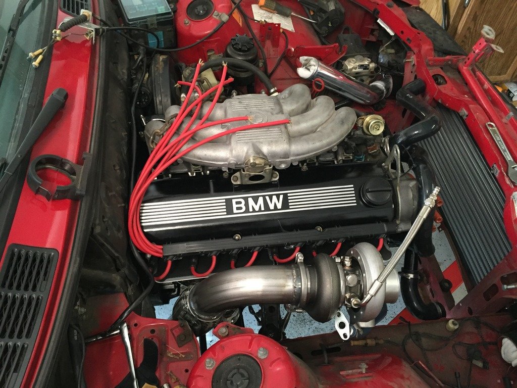

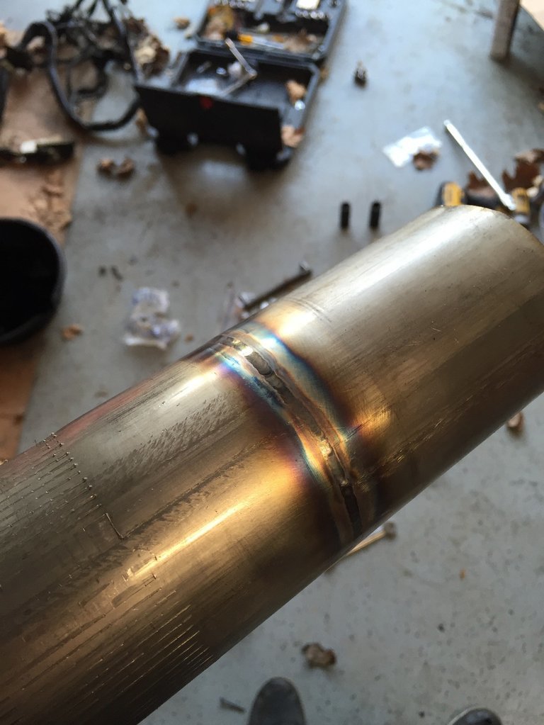

    Here's a downpipe I made for my turbo build. First time tig welding stainless. Not super pretty, I need to work on my consistency on round objects.
    Anyone have any advice on fusion welding on a non structural exhaust tube? I did not purge any of the pipe for this so there is some sugaring inside. I think it'll be fine but I can still run over it with filler.
