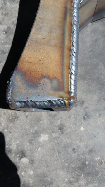

    Help. Tell me what's wrong. Gun angle or holding the wire at the edge too long?

    Looks like gun angle to me and possibly too fast travel speed, that bottom welds I see some undercut.

    Need more wire speed.
    My non-expert opinion.

    You might have been more specific what you were talking about .
    The bottom weld looks like you welded it last after you cooked all the water out and got the weldment just to hot
    Look at the HAZ (Heat effected zone) on the bottom compared to along the weld on the right side it was just to hot
    things can be to hot or to cold sometimes things need to cool down .
    Ends like that get heat soaked quite easy.
  13. Apr 7, 2016 at 6:38 AM

    Wire speed if I go up it kicks back if that makes sense. Self taught and trying to get my welds better. Never had anything fail but visual is my biggest problem. Machine is a Lincoln 175hd on gas, and that was welded on c and speed between 3 and 4

    I think they look fine. Maybe just a tad too much heat. That or increase your speed.
    I don't like to stop when welding, just one smooth, weld. On the plus side, doing it your way reduces burn thru.
    welding the outside of sheet steel joints is always hard to control heat. I cheat and weld the inside and grind the outside down.

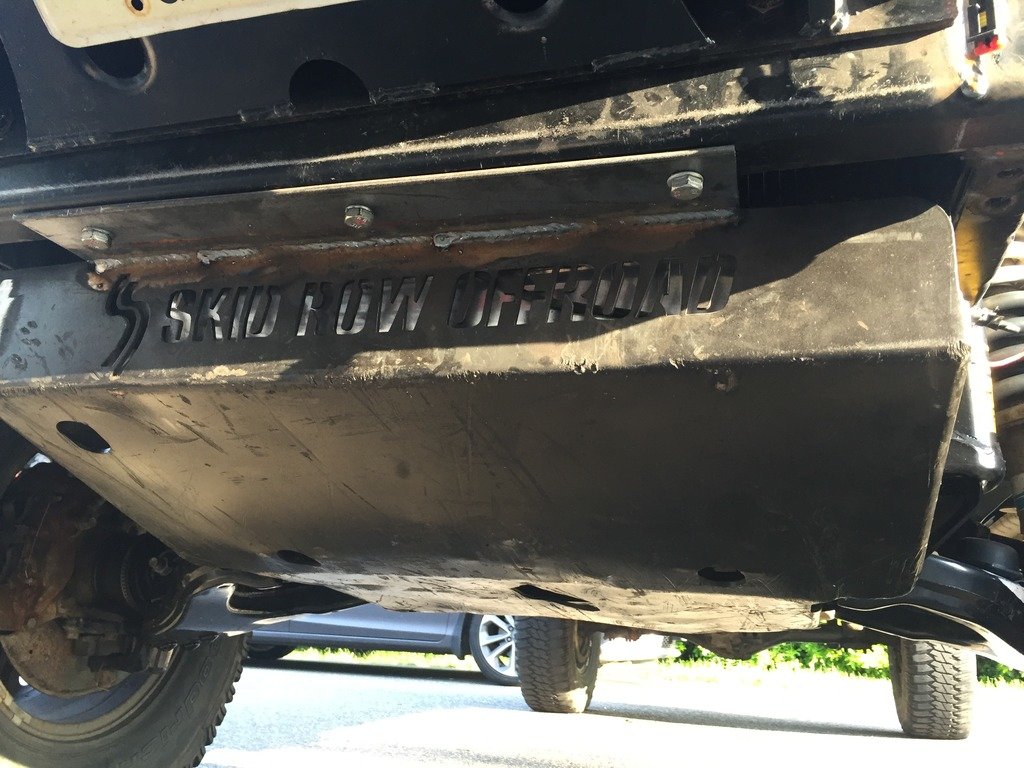

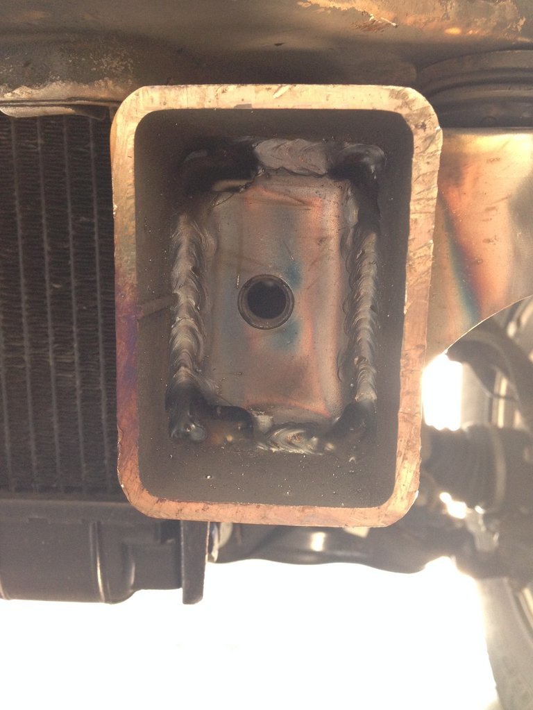

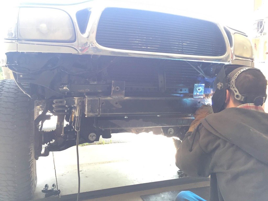

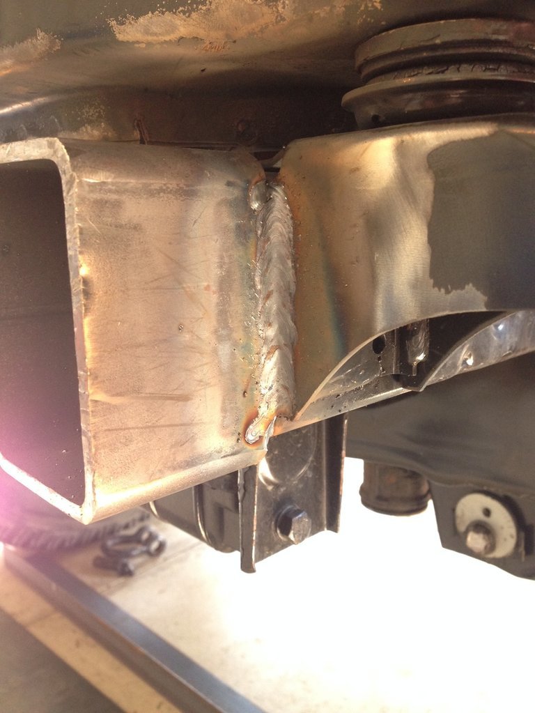

    Some frame horn extentions I welded up on a 1st gen to fit an addicted offroad bumper up
    05F3AE0D-EB90-4C9D-BCA1-648187C7326C_zps_3e70164368e9cb68235eed1f2dd712362029b9fa.jpg
    22485C7F-4B19-4EDE-AE7E-9720C1E1809B_zps_0ed59b2aceb5e5a4c2ae3faff04873fe1543f92c.jpg
    1B761DC3-419A-4E45-8F27-EBDD6857EFD1_zps_d202e841071e28f31d70b3472317e6846d22e934.jpg
    Modified the skid row skid plate to fit the new crossmember
