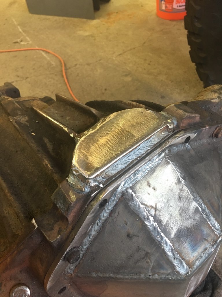

    Added a 3/8" plate to the bottom of my shaved axle.

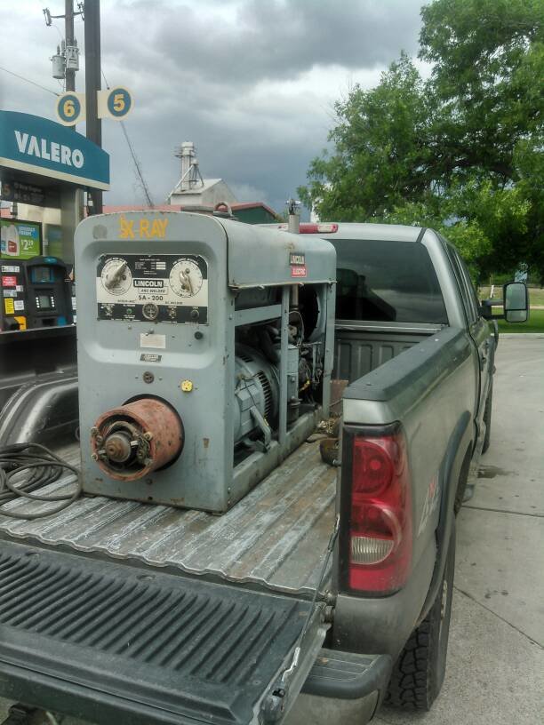

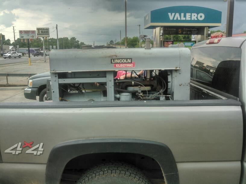

    So today. This 85 sa200 became mine 9076e60240b3619418578b80c51a7d81_942497b72ae6dce3abaf33ccc6d831afb44d9388.jpg84a01dbc026db4078146721bc593410a_6fb7debfacc115d051d657b21553f265031329f6.jpg

    I am guess the side panels are long gone.
    The cooling system is set up to work better with them on.
    Check the brushes !!
    Best of luck with the new addition to the family

    Brushes are great ! I didn't know about the side panels and cooling. I assumed it'd cool better with them off so didn't even think to ask.

    People mount them on trucks with no room to open them
    They get taken off and forgotten all about or used for some project

    So if this rig is going on a trailer, I need to find some side panels for it or just leave it?

    Your call !!
    With the rain your having I sure would not want all that water getting in .
    Gas engines can get a little finicky if there getting wet all the time.
    unless it is going to live inside most of the time .

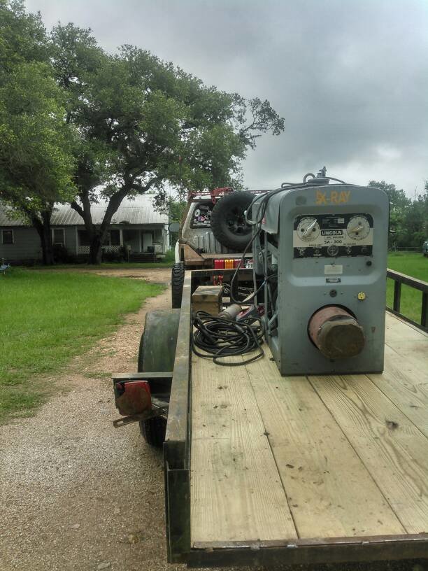

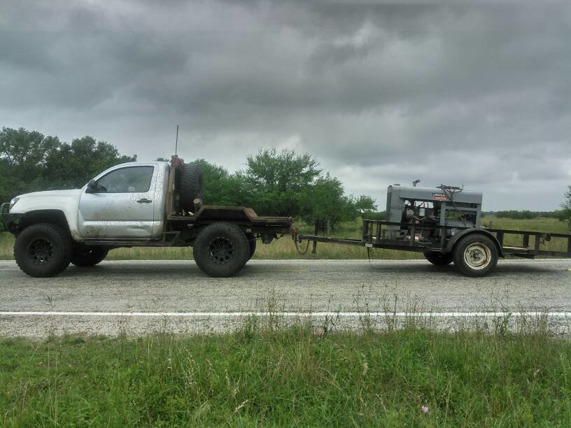

    5e3f1da00f87078f7927023064cab4bd_713fa8eeff1c7f51c7144ff924fcb0f26aba68a5.jpg69377dabb2f464f8120529ba3d1cc182_abf2a515614e6be6c4db6015ca839111d05b6d71.jpg :spy: my old man gave me a trailer we had laying around. After a new floor and tires....
    Should advertise for off road welding repairs with my rig :rofl:

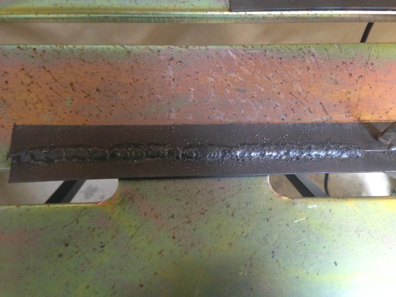

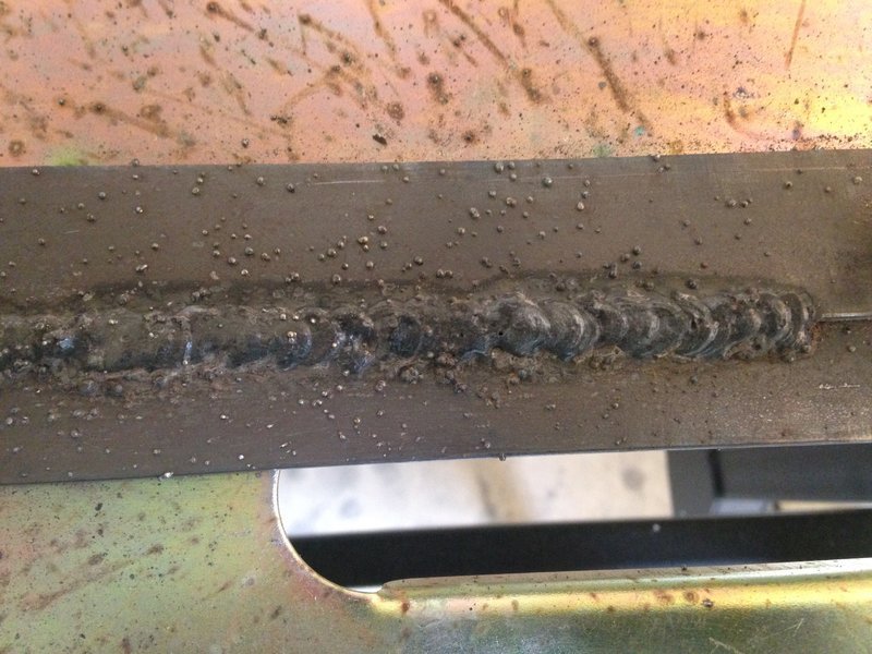

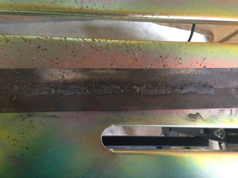

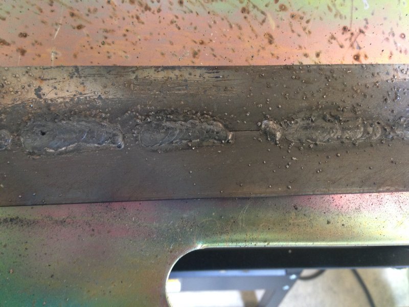

    Would like you guys' feeback and input. 1st day welding, trying to learn:
    EDIT: Im using at Millermatic 141 (MIG). Between the butt joint and the lap joint, i turned the amps down a little bit.
    Also, using Washington Alloy Co. .030 flux core

    You just might want to share just what process ??
    What Electrode / wire Etc.
    Just sayin
  12. May 17, 2016 at 2:11 PM

    what do you mean by "what electrode"?

    With shielding gas or without?
    It looks like you should slow down some, your bead looks like 6010 in the bottom 2 pics.

    Electrode is type of rod if stick welding (E.G. 6010, 6011, 7018)

    Without shielding gas, just the flux core.
    and what does 6010 mean? Im a complete newb and have no problem asking questions to learn. So i apologize ahead of time for the dumb questions.

    Thanks. I started speeding up a little because I thought the puddle was getting too big in my loops? should I change the wire speed to adjust this or turn amps down more

    I can't comment on how it should look without shielding gas.
    6010 is a stick electrode, the bead looks like this.
    If you were welding dual shield (Flux with gas) it should look like this.
    Pierce likes this.

    I have never welded flux core without gas before so I don't know much about it, but I wouldn't do the loops, loops are for MIG and 6010, flux core (The way I was taught to run it) you stay in the puddle and put the bead where you want it, straight line and your speed dictates the puddle size.
  19. May 17, 2016 at 2:19 PM
    #5759

    Makes sense. thanks.
    I am trackin the beads wont look nearly as neat and clean as with gas but for my location and what im doing, im going for function over looks right now (sadly haha)

    I thought flux core was still MIG, just a different kind of shielding (ie flux core). in all the videos ive seen (and yes ive spent DAYs watching to learn haha) no one has not done loops with flux core, its all been the same loops (unless they started running vertical T joints)
