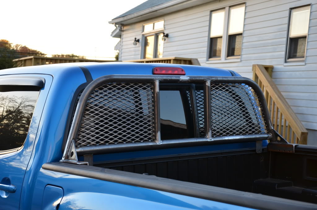

    Made a headache rack today for the truck. Was using my dads older miller matic 300, kelpt having issues with gas. Almost every weld that was more then an inch, gas would quit then start, thus leaving a 1/2" section that looked like shit and had to be ground out and re welded. Almost the same as working outside in the wind, like the gas would be blown away, but I was in a glosed garage and it did it the whole day..
    All in all I got the rack done, now I need to figure out the welder situtation..

    happened to me on someones welder before i found out it was because the line was kinked. Try straightening the line completely out.
    looks nice

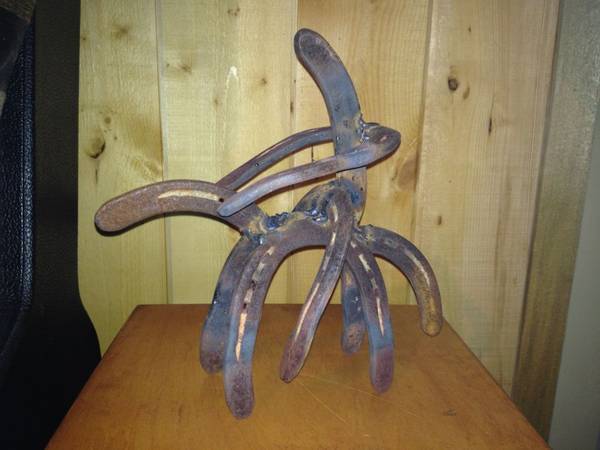

    heres my next project. Im going to add a bunch of stuff to it. I suck at arc welding but i decided to go with that style to keep with the country feel lol

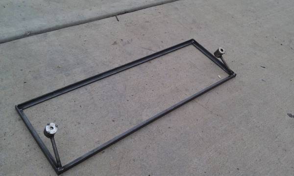

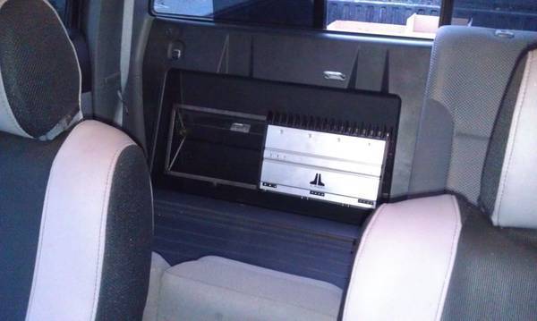

    Built an amp rack, i can post more pictures later.
    I built it to hold my two amps without cutting the storage tray, and it bolts to the truck so pretty hard for theft
    Started (two cups for upper bolt holes in storage tray)
    I added another one for the third bolt and re-enforced all mounting locations.
