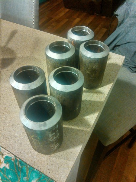

    Opinions? Help? Advice? Lol. 1/8 gap 3/32 filler ~75amps. Trying so hard to get a testable root. Its getting better but not where it needs to be yet :pout: KIMG0285.jpg KIMG0283.jpg

    Your making this hard on yourself !!
    I know low budget working with what you have laying around
    Can often cause drinking and divorce
    Do you know for sure just what your welding on.
    When testing for real nice new material either turned with a lathe or one of those fancy pipe bevel machines.
    GTAW clean clean clean and some more !!!
    I know you know this.
    Inert purge with coffer dams
    Just what code are you trying to pass.??
    What are you looking for in your passable root ??
    Are you cutting coupons out and bending them?? It is the only way to really test them Then they need to be prepared correct or more flaws then you have will show up.
    Just what machine are you using??

    I think I answered all your questions!

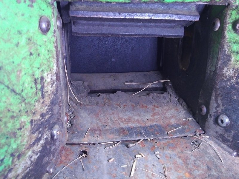

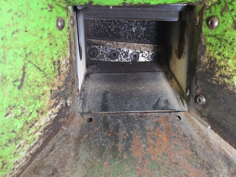

    Before:
    After:
    Replaced the feed table plate on the wood chipper.

    My bad it was a long day I am not at my best after work better in the morning.
    I have seen worse at the Local union training centers that passed .
    Just don`t teach yourself any bad habits

    Guess so. Bout time to go run some more beads!
    That's awesome man. What happened to ship yard welding ? But definitely learn Tig (gtaw) if you can! Tig is where all the demand is and the best paying jobs. There's 15 structural welders for everyone 1 combo welders. The demand for jobs and pay rates make that obvious. If you're gonna learn Tig and want to make big bucks, learn left handed and scratch start. Spoiling yourself with the foot pedal only hurts you.
    Lol I wasn't offended in anyway with your reply. I deal with a lot worse when I'm at work.
    I'll just keep practicing. Gonna try to backfeed some today. Never done it before so should be fun

    If your having a hard time scoring pipe coupons
    Use plates the basic hand motions are the same .
    4"x4" x 3/8" or 1/2" what ever you can score easy to bevel with a track burner.
    Lots of schools I get into use plates for practice because the prep work is easier.
    Plate is easier to come by as well.
