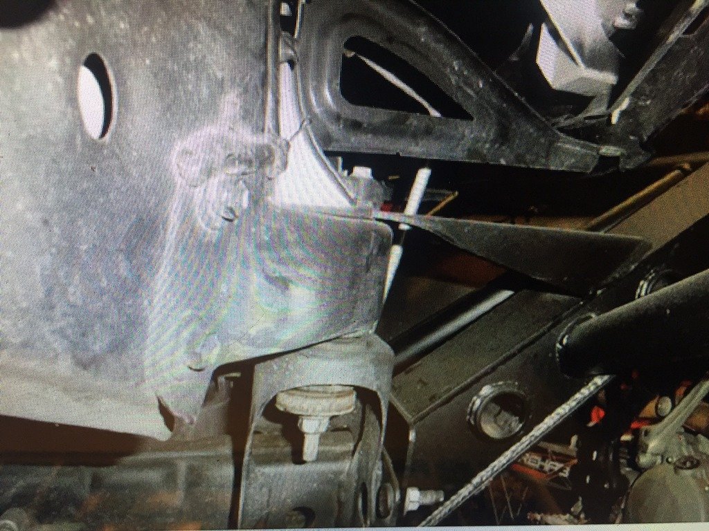

    Probably a dumb question but can someone please explain to me why they put a bumper mount on top of the body like this instead of a couple inches down so its on the same bolt but on the frame?

    Because it is cheaper and faster when building the bumper . Pretty many bumpers tie into that very same bolt
    Then most people would not want to be jacking the cab up to install a bracket
    If your not happy just redesign your mounting brackets and build them.

    Its not my bumper, I was just curious because I was going to add another mounting spot on mine and was getting ideas when I ran across that and was curious.

    That is the same bolt that I have used on all the ones that I have done.

    On top of the body like that?

    Yes on Top like that.
    Would you want to loosen all the cab mounts to raise things up without bending the mounts to install a bracket on each side .
    Now if your the type things need to be perfect a shim the same thickness as the bracket needs to be installed on all the cab mounts.
    To some the 3/16" or 1/4" difference would be huge.
    Paying the Labor to have this installed another 2 hours to the job plus broken hardware

    Yep. Take out that long body mount bolt, and slide the mount between the body and the radiator core support section of the frame, and your good. Let me find a pic of mine, or i'll get one up later today.
    Okay so I just looked through all my pictures and i don't have a good one showing the mount. So I'll get one up a little later today.

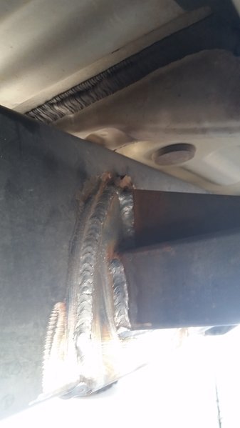

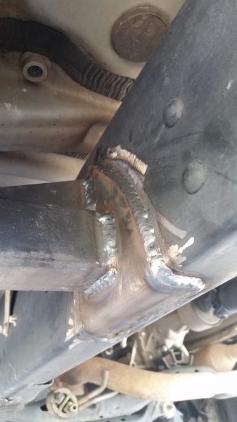

    Ok a guy said my vertical downs would not last and had cold lap. What say. I know the top part on the brace is ugly. Head and arms were having convulsions

    That is the thing people always hear vertical down welds are evil and should never be used!!
    Quite correct in most all applications but in your case I have been using vertical down on these Truck frames for years .
    Cold lap hard to tell from the pictures !!
    Slider brackets ?? I would not even worry unless your planning to be dropping the truck on them several times a day or you weigh 600 pounds like me.
    Timbo's Customs likes this.

    Timbo's Customs
    Timbo's Customs Well-Known Member
    Aug 8, 2013
    #110078
    7,266
    Timothy
    Lakeland FL
    2019 f250 6”lift 37s deleted 1997 T4r, tons and 4ds
    1997 t4r has super duty axles, 5.13s locked front and rear. 3 link front with 14" kings. Rear 63s.
    Yes sliders, I'm not worried about my welds never had one fail
