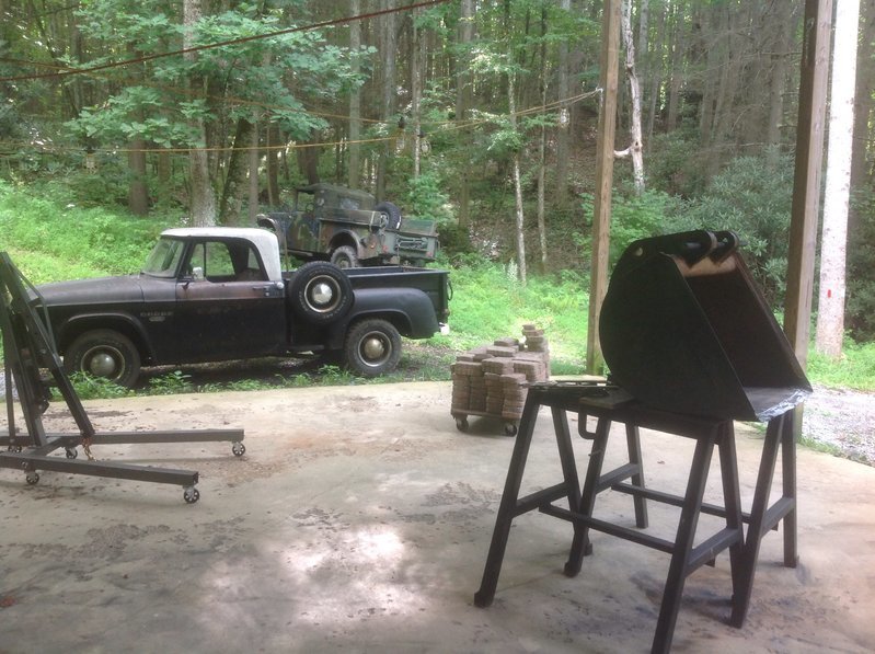

    This is my setup, plus a cutting rig, and a little Hobart Handler 140 mig...for the bucket above.image.jpg image.jpg

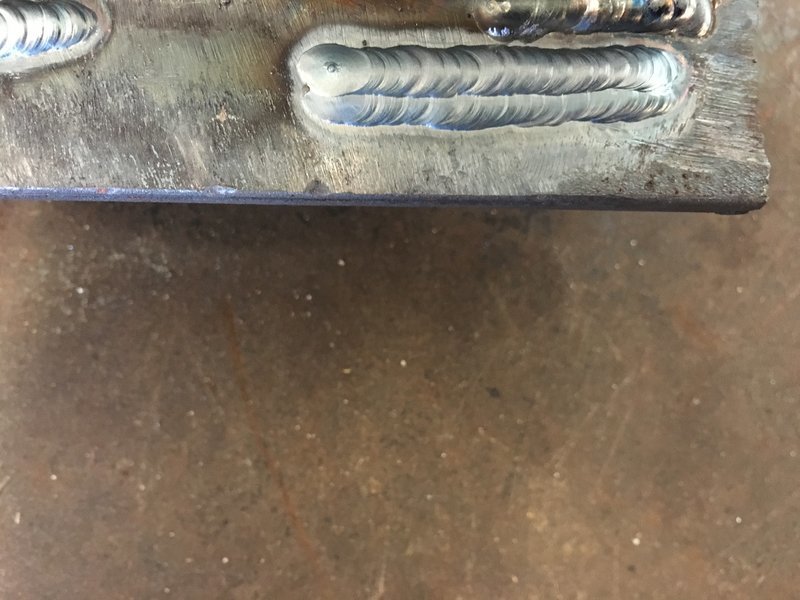

    Back to welding in the shop today, 6010 open root plates.
    3/8" plate 37.5 degree bevel 3/32" gap land is the width of the nickel or a little heavier 1/8" fleet weld 5p+ rod at 83 amps
    Still working on getting the puddle size/timing down but I think Monday when I go back it should be fairly simple.
    Do any of y'all know about arc force control (Miller machines)? the teacher doesn't know much about it other than 6010 welds better on 50 and 7018 welds better on 15-20.

    The Arc force is a way to soften the arc like 7018 or turning it up gives one a more crisp arc one gets from a 6010.
    Personal preference !!
    Changes output characteristics without increasing output current .
    Then one most often wants to change settings between different positions

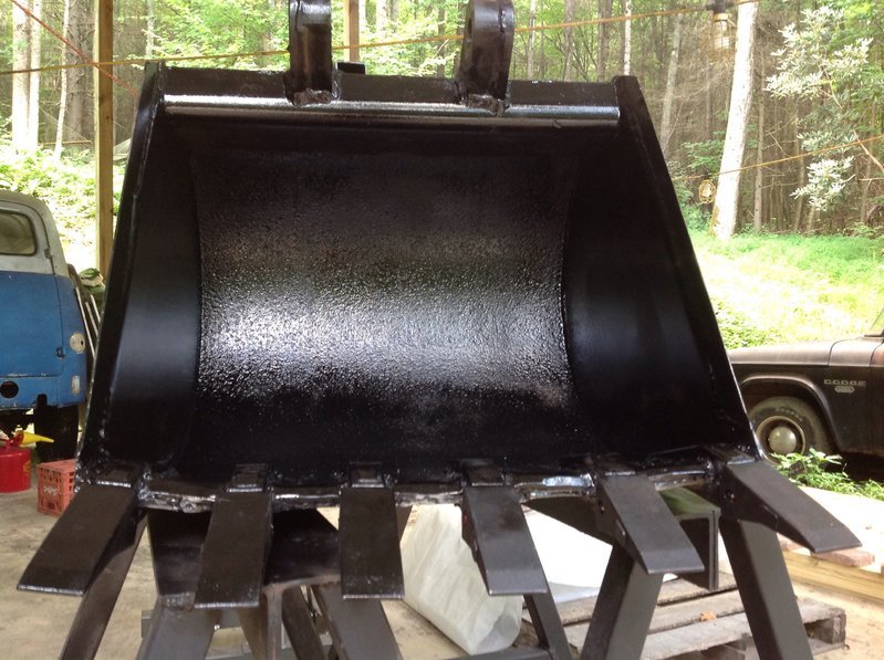

    image.jpg i just wanted to close out my discussion with the backhoe bucket, got it done today, teeth on, and just need to wire brush and paint the back...
    The cutting edge is reinforced with grouser bar, the stuff used to rebuilt dozer shoes.
    Howard

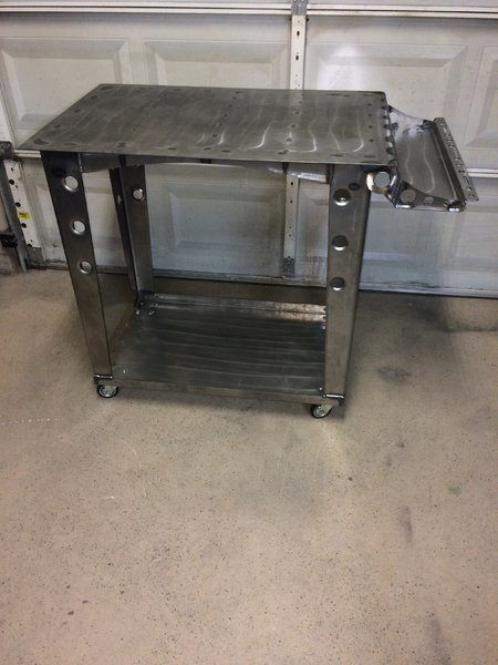

    All steel and no wood is def your best bet. just build your own to suit your needs. Here's a small light duty table I just built as an auxiliary to my main table. All 11 gauge cold roll.

    Could you post a picture of the underside of the tabletop? I'd like to see how you supported the top.
