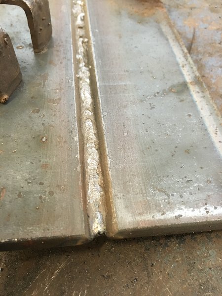

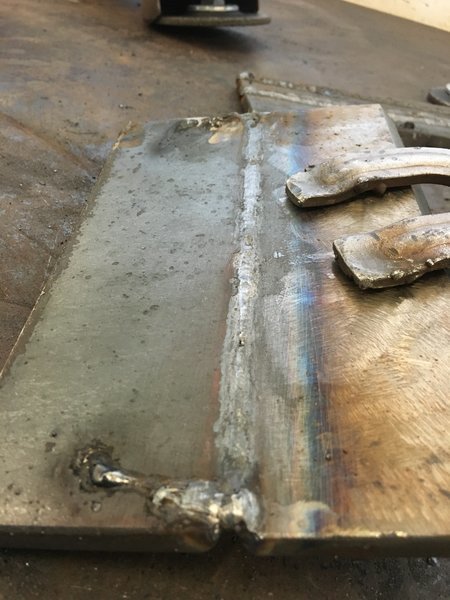

    Back to welding in the shop today, 6010 open root plates.
    3/8" plate 37.5 degree bevel 3/32" gap land is the width of the nickel or a little heavier 1/8" fleet weld 5p+ rod at 83 amps
    Still working on getting the puddle size/timing down but I think Monday when I go back it should be fairly simple.

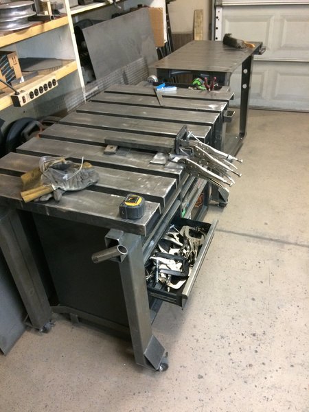

    All steel and no wood is def your best bet. just build your own to suit your needs. Here's a small light duty table I just built as an auxiliary to my main table. All 11 gauge cold roll.

    Could you post a picture of the underside of the tabletop? I'd like to see how you supported the top.
    Thanks.
    At The Helm[QUOTED] likes this.

    Thanks! It's just some 2" and 1" flat stock 90° to the surface. Ill grab a pic later.

    Thanks for the picture.
    I was thinking the table needed to be much heavier - I guess I was over-thinking it.

    That one is just a lightweight table that easy to roll around though... I'm mainly going to use it for cleaning parts and putting jigs on it that don't require a perfect flat surface. You could use a similar design with a 3/16 or 1/4 top and be good to go for a decent amount of weight load and warpage resistance.

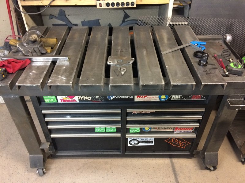

    Here's my main table built from 4x2 tube and c channel (so I can clamp to the surface). With the toolbox it's extremely heavy and cumbersome to roll around my garage.

    Very nice - look really heavy.
    Does it sit on wheels all the time, or is there some sort of foot behind the wheels?

    It sits on four locking casters
