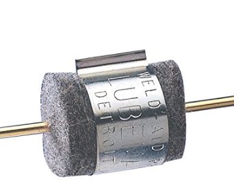

    Hey guys, does everyone use these cleaner/lube pads when mig welding? I just heard of them from my uncle who's been welding for decades, but don't feel like I saw anything in my Miller 211 manual when I set it up. Obviously, I'm relatively new to the welding scene; my medium of choice has been woodworking most of my life!

    Usually used on wire feeders where wire is exposed to dirt, if your wire is inside machine done worry about it. An earplug can work in a pinch

    Got it, thanks. Since the wire is inside the 211, that's probably why I don't recall seeing anything...

    One of those things !!
    Some people will not weld anything without them.
    Others say the lube causes weld contamination
    Myself I think it is more junk people buy on impulse
    If you work in a area your wire gets dirty there are ways to keep that from happening

    I agree. Also, if you are not going thru the wire fast enough for it to start rusting up, you need to buy smaller spools.

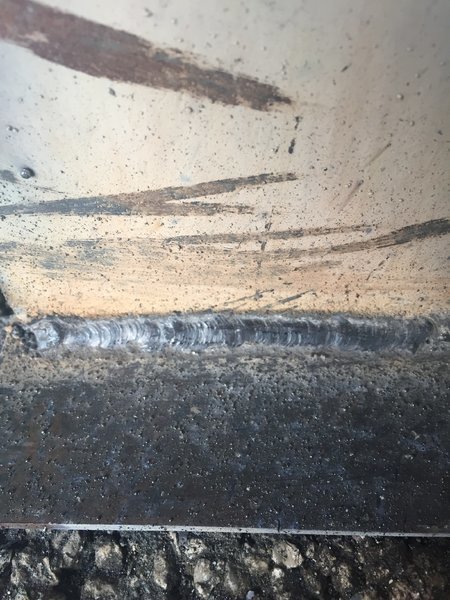

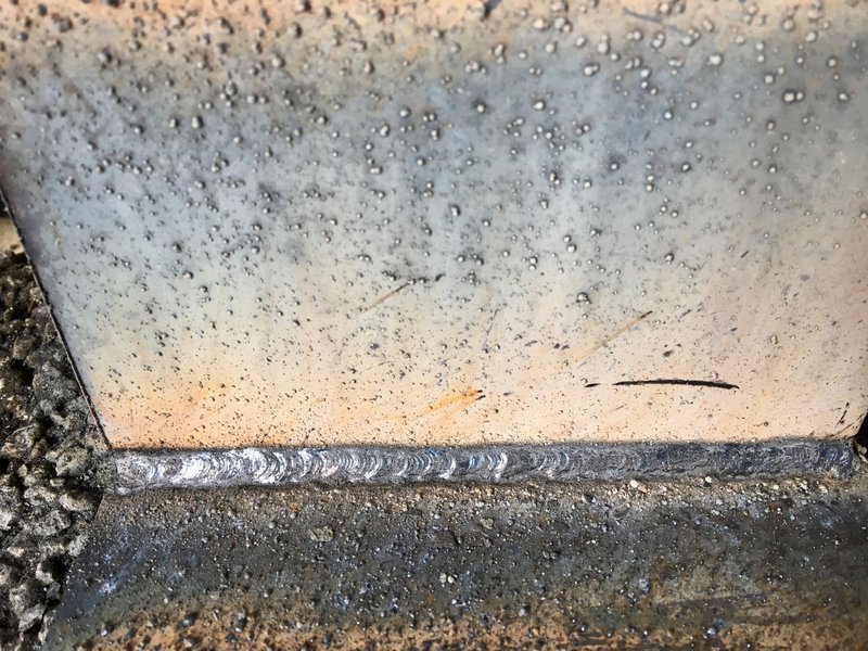

    Here's a couple beads about an hour after working with the machine. All fluxcore. No bottle yet. Not the prettiest but I'm definitely happy with the progress.
