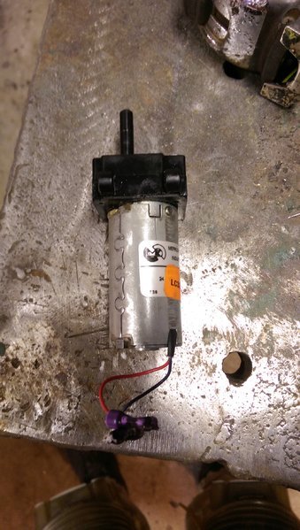

    Anyone else use a spool gun?
    I believe my gun is malfunctioning. Does the drive gear have lots of torque? Mine seems to stall out pretty easy, thus had issues pushing the wire out. I've only used 1 spool gun in my life, so I have no comparison. This gun has acted like this since new(20 years old).
    I bought a new drive motor/gearbox today and they are spendy. I just want confirmation that I did not piss my money away.
    Here is a vid showing me stalling the drive wheel with little pressure.
    https://youtu.be/sRx7gm9G0vw

    I used a spool gun at school but never applied pressure to the rollers like that, I do know they never stalled out even when the wire melted in the contact tip, the wheels would spin and tear up the wire.
    I can hook our spool gun up to our 211 tomorrow and see what it does.

    Those motors do not have that much torque .
    If I did not need to run out the door I could down load the service manual and see if the have specs for the torque
    All they need to do is pull and push the wire a short distance
    How much voltage are you getting to the motor ??
    Line loss dropping voltage ??

    That motor runs on 24 dc.

    Just got done swapping out the motor. Welder is running just fine. It pushed an entire roll of wire thru to the last 10".
    Here is what the bad part looked like in case you have never had one apart.14842539866811073190561.jpg
