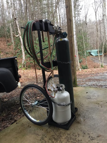

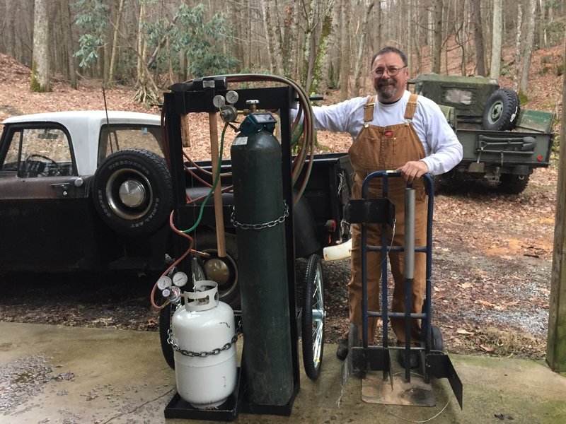

    I got busy and built a new torch cart, the wife calls it the torch trolley. Wheels are 26" and came from Northern Tool using a standard 26x2.125 tires and tubes, steel came from a local supplier, 2" x 1/8 angle, 3/4 bar and 4x 1/4" strip. And in some short pieces of 2" square and some 1/4" chain.
    Posed for the pics in a fancy new pair of Dickies Overalls...50D17462-9CC0-4788-8D8F-8C4824BC2048.jpg

    That aught to roll just about anywhere!

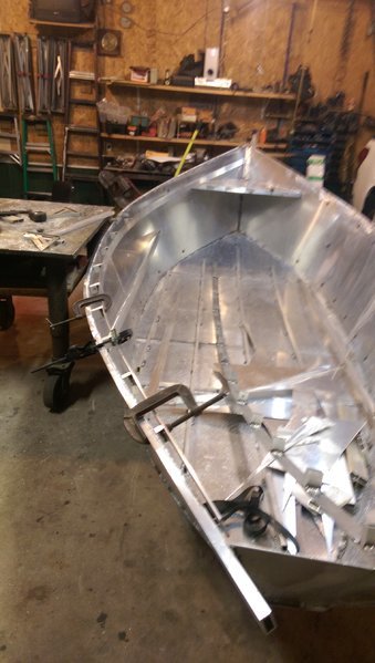

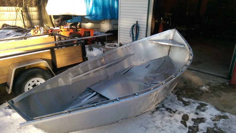

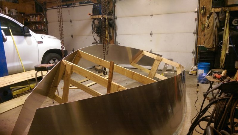

    Nice, how did you do your bends?

    Sorry I took so long to respond. Spent most of the day driving.IMG_20161124_112428.jpg

    I can`t wait to see pictures of the maiden voyage !!
    Since Jaws even crossing a bridge is scary !!

    Cool, old school, wooden forms...
