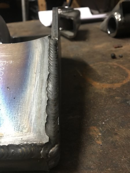

    What's going on here. Too hot. Too slow too fast. Every now and then I get in a slump and I am going against myself not holding in the middle long enough.

    Weld mix 75/25. .035 wire Lincoln 175. Heat setting C wirespeed 3.5 to 3.75. 4 it kicks back.

    Too hot and/or moving too quick not giving the wire time to fill it in.

    Looks like poor joint design although it might be the picture
    Lack of practice .
    Are you having trouble seeing the puddle ??
    Lens dirty or to dark ??
    you should be able to see your not holding long enough on the top toe of the weld
    Numbers don`t mean anything only to you
    .023 wire and slower travel speed your needing to move to fast for the wire your using at your skill level
    slower speed more control
    unless your doing production piece rate welding is not a timed event
    Timbo's Customs likes this.

    Fresh metal, 1/4 spring hanger.
    Granted they aren't dimes. Can see the puddle fine. Must have been moving too fast. I have more 1/4 plate I'll mess around with some tonight.

    Look fine to me.
    I always know I'm proud of a weld when I think it's a shame to have to coat it with paint:)

    Lots of undercut.
    Was late last night after work I decided I would weld them up. Was pausing at the bottom more and sweeping the top.

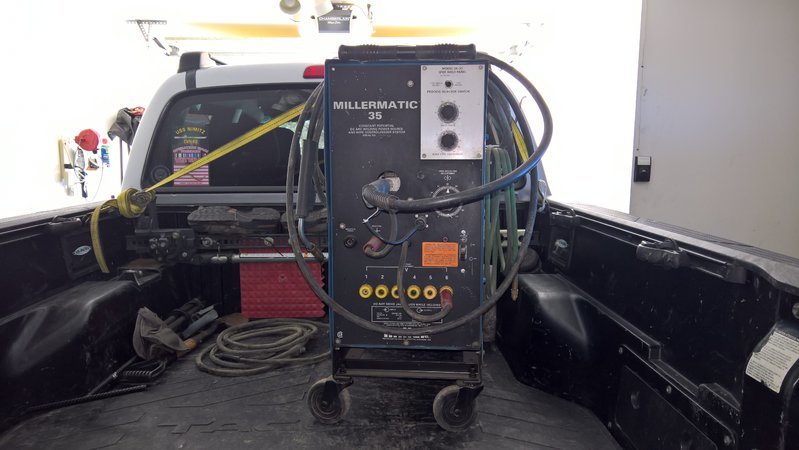

    Hey there. I just invested in a weld machine so that I may teach myself the art of welding. It is a Millermatic 35. I tried it out in the guys shop that I bought it from, and it welder beautifully. Currently I am lacking 220v in the shop, a welding hood, and gas bottle. I plan on installing 50 amp service in the shop, stopping by the local weld supply to talk about renting a small bottle of Ar/co2 mix. One thing I don't know much about is the welding hoods. I know I want an auto darkening hood, I just don't know which I should go with as far as brand. I don't think I should go with Harbor Freight as I wouldn't trust the safety of my eye sight with that. Anyone recommend a fairly inexpensive auto darkening hood that is of good quality? I don't mind having it shipped, I am still at least a week away from installing the power to the shop. I appreciate y'alls helpful input. Oh and a pic of the machine just for reference.WP_20170129_12_39_55_Pro.jpg

    I also started welding not too long ago. Didn't want to spend hundreds on a welding helmet so I purchased this one after reading reviews. It's worked flawlessly for me. But maybe some of the more experienced guys will be able to steer you in the right direction.

    The HF hood is just fine. I've used them for years.
    Amazon had one that is very highly rated as well.
    Do you need 50 amps for that machine? All my Miller welders are fine on 30 amps.

    I just don't feel I can trust HF with my safety. The welder is rated at 26 amps, but I plan on a larger compressor eventually as well.

    Just trying to save money.
    Welders are rated different according to the welding code book.
