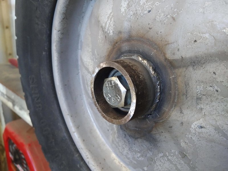

    Fabrication advice needed: I need to make (grind/file) the exposed end of the pipe perfectly perpendicular to the hub axis of the wheel it's welded to. Assume I only have the most basic of metal tools. Thanks!

    Perfectly perpendicular? Chuck it in a lathe.

    If I had access to a metal lathe that would be ideal. All I have is an angle grinder and some files.

    Find a way to keep the wheel spinning and use your angle grinder with a flap disc? Kind of the same idea as a lathe.

    I tried this with marginal success. I've got it pretty close, but I'm to the point where I can't hold it steady enough to grind enough off of the raised portion without slightly grinding on the lower portion. I'm thinking I might have to build some sort of jig that will hold a file in one spot while I spin the wheel by hand. Way more work than I'd like to do, but it may be my only option.
    Some background, this will be the mounting point for a bicycle disc brake rotor for a wheelbarrow that I'm adding brakes to. That's why it needs to be a perfect 90 to the axle hub.

    There has to be a shop some place close that will throw that on a Lathe and have it done in a few minutes
    Even if your an hour of driving from town you need to go in some time

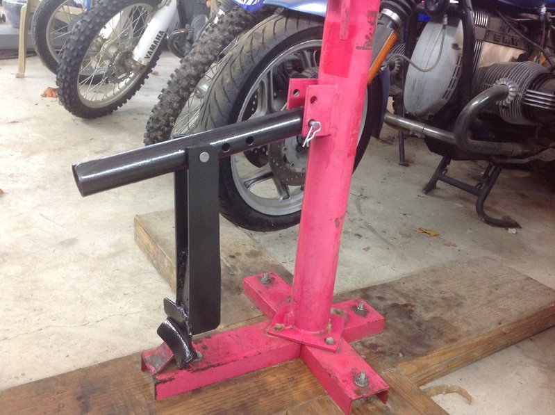

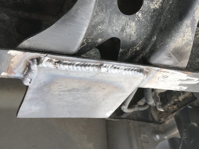

    Wow, I used to be able to get welds that looked that nice with a TIG or gas setup, but I cannot make a weld that looks like that with the MIG. Everything just looks like a bead of toothpaste. Too much wire? Too big a wire? Been going off the "table" on the inside of a Miller 210... weld mix, .030 wire...
    Any advice, GREATLY appreciated. Thanks!

    Were you by chance running self shielded wire and forgot to change the polarity back ??
    You do have the correct gas looking at the cylinder sticker
