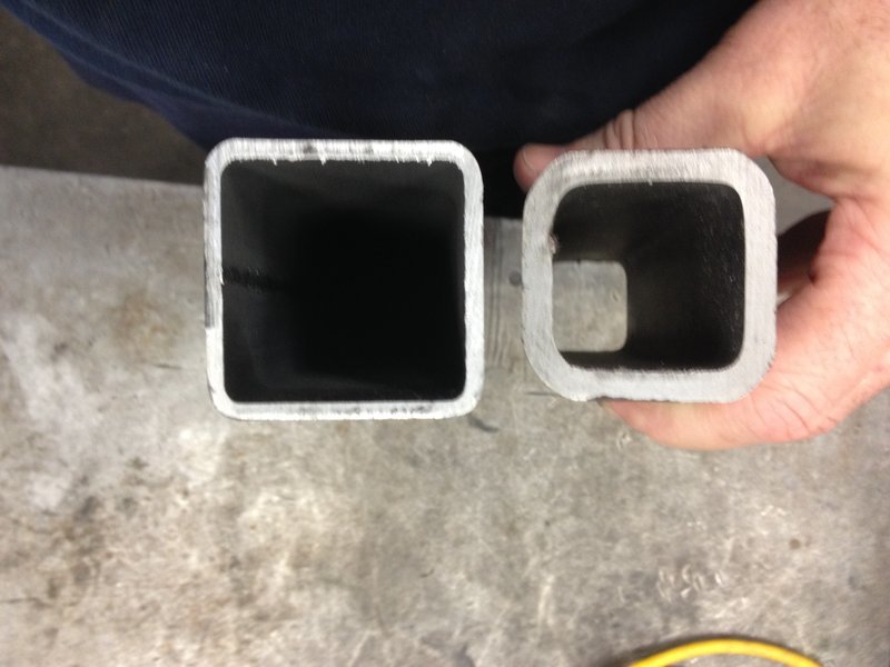

    it also depends on the thickness of the box tubing. both of these are 2x2 box tubing the one on the left is 1/8 the right is 1/4002.jpg

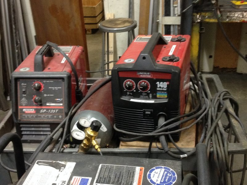

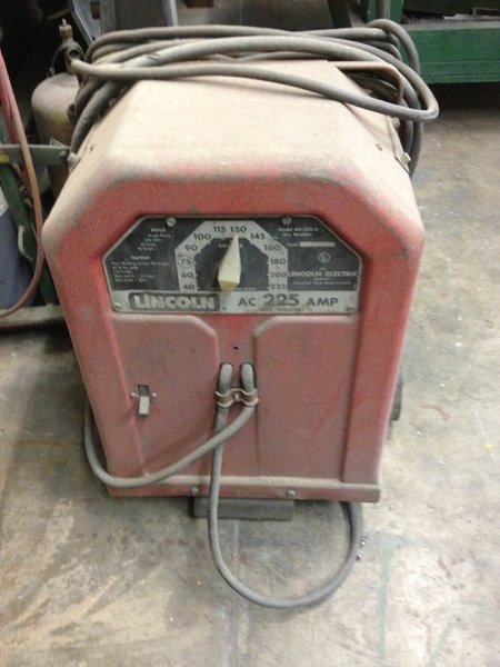

    The tombstone .......classic starter

    And you can use them to thaw frozen metal pipes. Saw an old timer turn his as low as it would go and attach the ground and the electrode to the pipe. It heated up the pipe and thawed the frozen pipe.

    Better than the AC Buzzbox I learned on.
