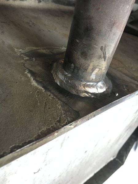

    Hi - could use some help: Did I stupidly make the wrong assumption - that my exhaust on my stock 2006 v6 TRD is mild steel? Is it actually stainless? And, i chopped the tip off and welded on a segment of the original exhaust to deflect exhaust away from my spare... It seemed to weld fine with regular steel wire. I would have thought it would have not welded if it was stainless. Anyway, questions:
    - is the exhaust in fact stainless?
    - am i going to be sad in short order when my weld cracks or fails (and therefore, should i tig it when i do the crossover re-route?)
    Here's the weld in question:

    I have never seen a stainless exhaust that was from the factory .
    Maybe the newer trucks
    Then most vehicles I get under have had the exhaust replaced a few times
    If things looked fine while welding and it did not crack in the heat effected zone (HAZ) as it cooled you should be fine time will tell.
    Kind of expensive to buy a spool of 309L unless you weld lots of mild steel to stainless
    Zebinator likes this.

    You can weld SS alloy will carbon steel welding wire with no problem. I do it all the time. The weld will rust, but it will be there longer than the exhaust. You got no worries.
    Did you take a magnet to the pipe? SS doesn't grab a magnet as hard as carbon steel.
    Zebinator[QUOTED] likes this.
