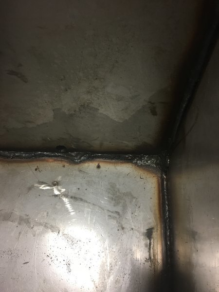

    Had my coworker weld up a stainless tank for an alcohol rinse. He's our main welder on days. 65 years old. I think it's time to hang up the torch. He welded the inside and outside corners and it still leaks.

    Just how big of a tank ?? Back purging not possible ??
    From the picture it looks like the prep work was never done
    What process ?? I would guess wrong filler for the type of stainless but it might just be the picture
    I would be embarrassed with a weld that bad

    We're not a full fab shop (paint shop) so we don't have the capability to back purge. It was mig welding 11 gauge 304 with 316 wire. He basically set the welder on kill and went at it. Most of the welds aren't tied into both sides. We ended up buying a $6 plastic tote to replace this abortion.

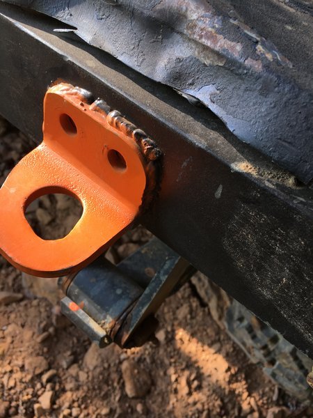

    Spotted this on someone's rig this weekend on a wheeling trip lol... I'm sure it's recovery rated

    Looks like my welds when I was about 10 when I had no idea what was happening .
    Or what to do to make it happen
