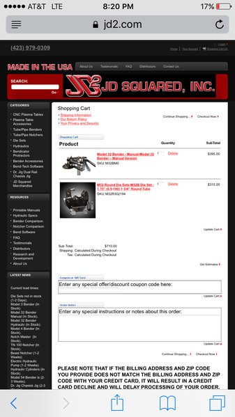

    Time to build a roll cage for the taco. Getting the 180* bends for more versatility.

    Are you planning on doing lots of work with this tool? It was easier for me to give the local muffler shop a pattern made out of coat hangers. They bent me 10 or 12 pieces on a previous job for a case of beer.

    Yea i gotta make a few bumpers, a couple exo cages and whatever else I can. Got some buddies that need work done and I need it for myself as well. Used to have one back in the day but sold it when I stopped using it cause it took up a bunch of room in the shop lol
