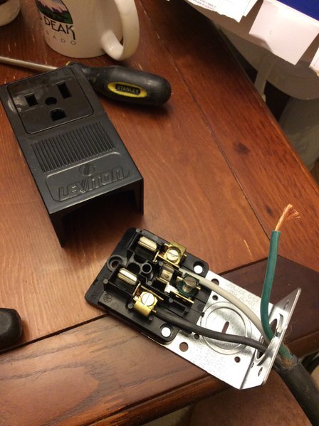

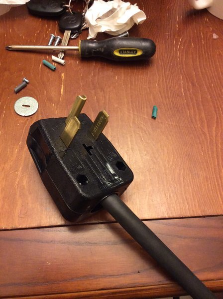

    $22 at Home Depot and now I have myself a 15' 14-30r to 6-50p cord. This will get me from my utility room to my garage.

    Just be real careful those male plugs tend to loosen up if your plugging and unplugging quite often!!
    If you lose a leg things don`t work and right away " My welder is broke"

    Can you break down the parts/stuff from Home Depot for me? I wanna do the same.

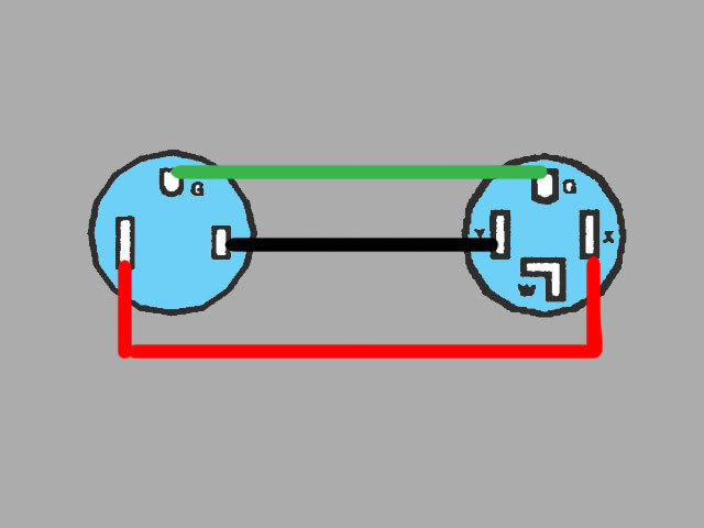

    Thankfully the 14-30r in my utility room is not being used by my dryer (gas dryer running on 110v). I plan on keeping the cord plugged in and hanging it up.
    • One 6-50r
    • One 14-30p
    • 15' of 10/3 SJOOW cord
    Disclaimer: I am not a licensed electrician. I am a web surfer. Do your research and verification thoroughly.
    Lol

    I made a mistake. Both of the plugs together cost me $20. I bought the cord last week and I forgot it cost $25. So my total cost was actually $45.

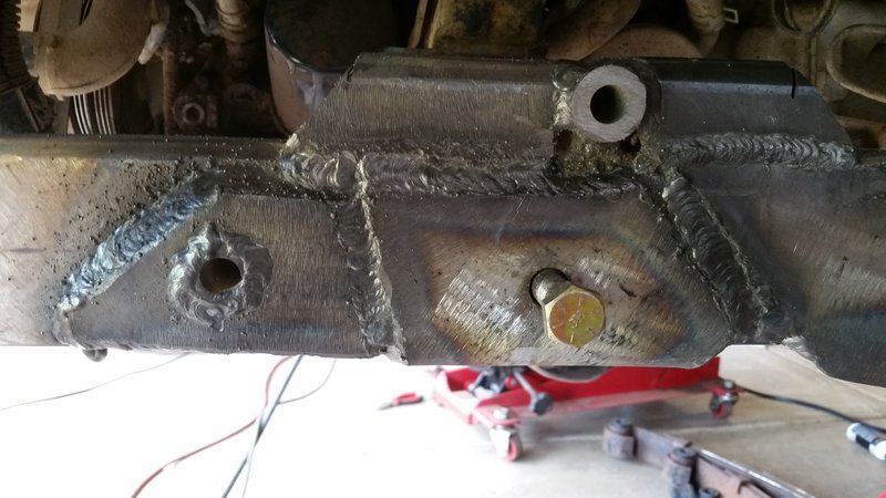

    Steering box mount in my new front frame section from my SAS last year. It hasn't broken off yet so i must have done something right. That upper tube got the gaps filled and a 3/16s fish plate welded over the top of it. This was all flux core with my hobart 140.
