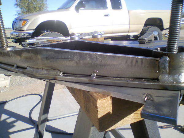

    should I up the heat or just slow it down a bit? Thanks for taking a look

    ya I was thinking thats running a little cold too. Bump the heat slightly

    It is cold out in most places right now. If you can't get it hot enough, take a torch to your piece first. It's tricky tho because you don't want to get it too hot to where your wire just punches right through the material.

    Thanks for the input guys

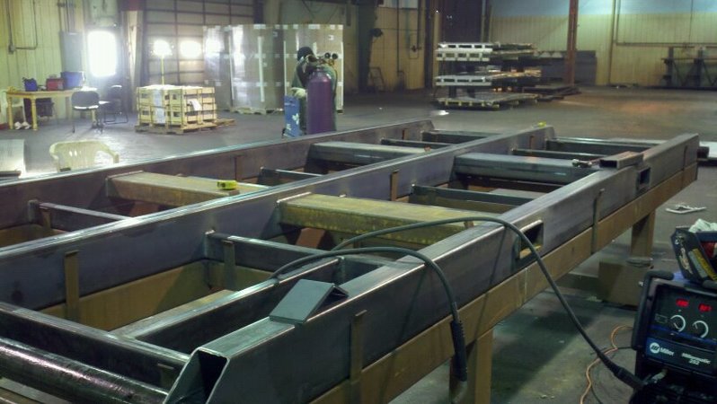

    18ft Skid for a heater.
    Will post pics of frac tanks later

    Drilling rig?
  16. Jan 23, 2012 at 7:53 PM
    #656
    dually
    dually Low and slow
    Jul 29, 2008
    #8205
    3,299
    Interstate underpass
    '16 Inferno SR5 DCLB
    No, I weld and fab for Mac Heaters. But pretty much everything we build goes to the oil field.
    http://www.macheaters.com/
