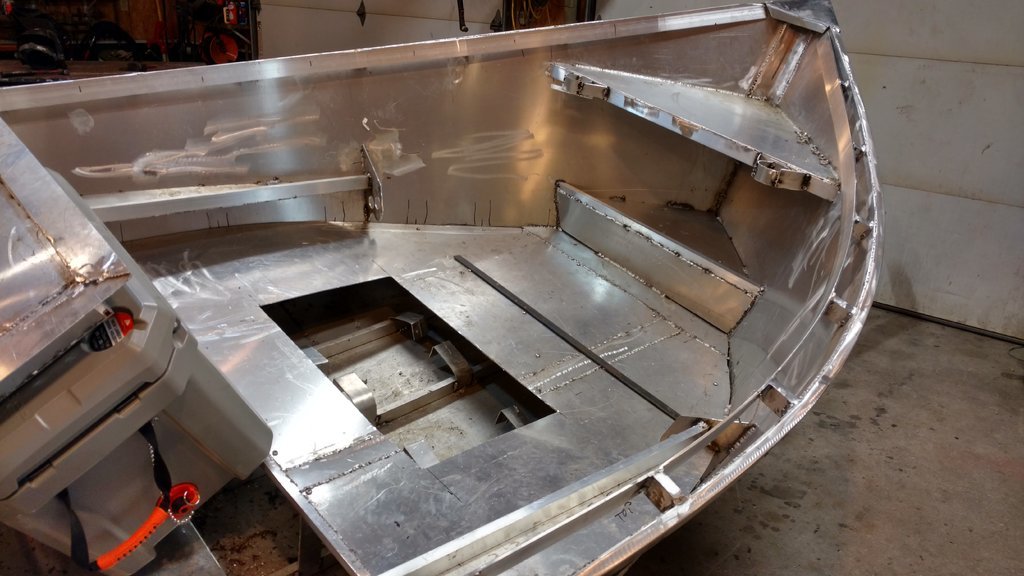

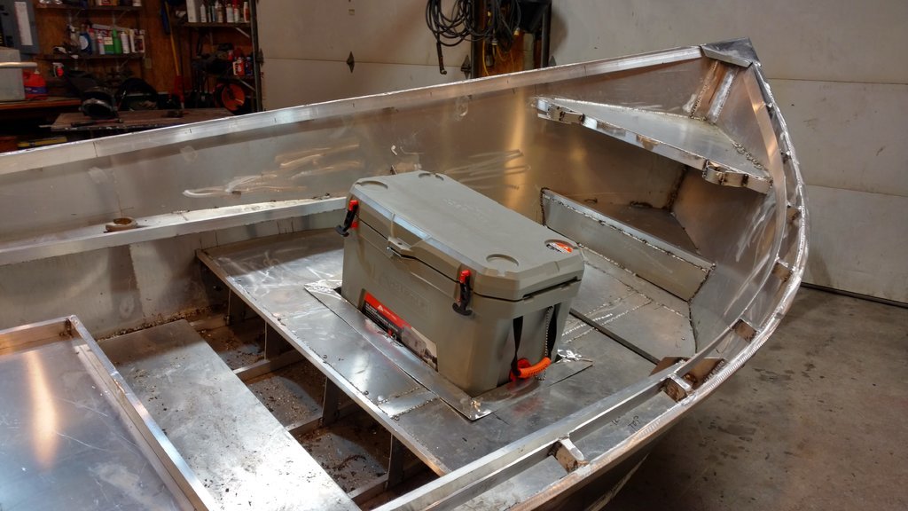

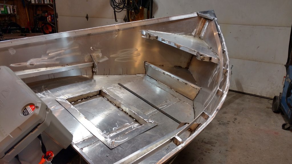

    Played around with the drift boat project. I found the cooler/seat base to be too tall. I cut out the floor, made a tray that is 3" deep. Much more comfortable height.

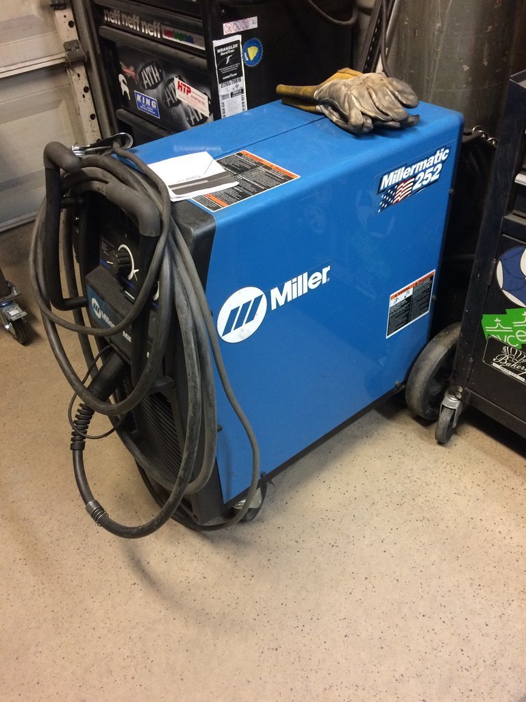

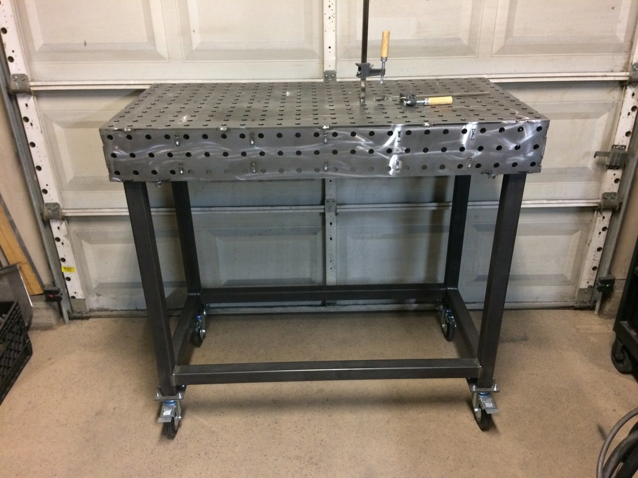

    Hooked myself up with a couple new goodies. :D
    The table from weldtables.com I'm thoroughly impressed with and well worth the money. I have the wrong legs on it (too tall) but the right ones are on their way. The 252 I picked up from work after they 'downsized' to a new 211 for portability. Very low hrs on it most of which were from me :rofl:

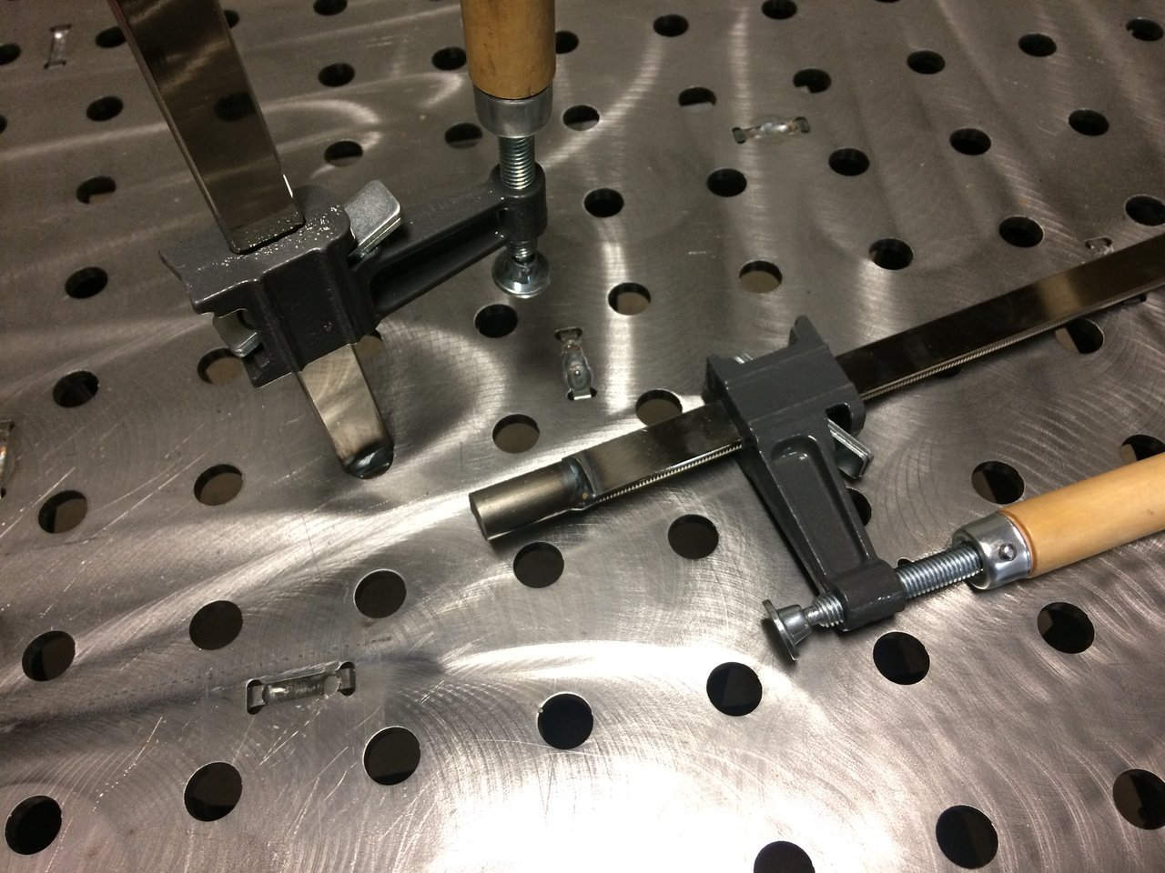

    Also after looking into clamps I decided to just make my own to start. I picked up some cheap woodworking clamps on eBay and modified them with 5/8" rod.

    I think you may grow to like the table on the high side. I actually increased me table height. Less bending over to weld on the table. I'm 5-9".
    Nice table.

    Yeah I actually do like like it up high like that for small parts. The thing is most of my welding is bumpers, so lifting 100+ lb peices on and off might get old real quick lol. It's 44.50" high now and will be 40.00" with the new legs so I think that will work well. My other benches are 36" so it'll be a welcome change.

    1/4 ton chain fall from an eye bolt in the ceiling. I'm done lifting over 40 pounds. The boss can kiss my ass if he thinks it takes too much time using the chain falls. He will really be upset when I take week of sick leave to heal my back.

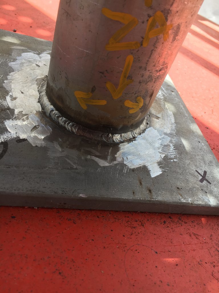

    Wanna know the trick to knowing if your welds are slick or not? Get your phone and take a picture of em lol. I swear this shit looked slick in my hands and then I take a pic and it's like ehhhhh.... lmao the struggle!

    How many joints have you done like that??
    takes some time
    Was the pipe beveled??

    I've done a few. It really did look better in person lol I'm pretty hard on myself when it comes to welds cause I wanna get slick at it.
    Plus it was basically conduit to galvanized plate using 7018 lol. Wasn't basic mild carbon to carbon.
    No bevel or anything. We are just building pipe supports so it's nothing crazy

    That explains the undercutting.
    Phone cameras are harsh. Don't take any selfies.

    Yea I was burning it cold to try and counteract the undercut but oh well.
