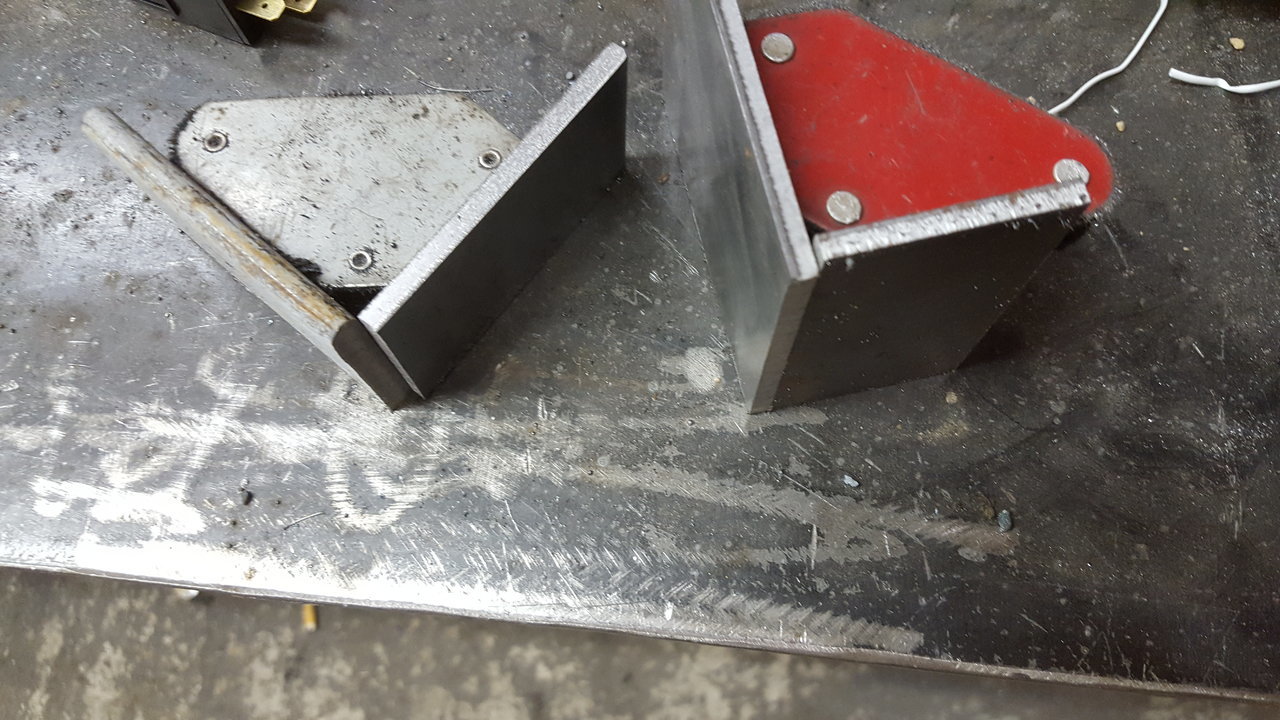

    Seriously though, I would've instinctively gone with setting it up like the butt joint on the right.
    Another detail learned.
    Thanks Jon.

    A little detail that my big brother and welder of many years never bothered to tell me about. At first I would bevel the back edge and butt them. But that does not leave much weld area, so then one day the light bulb turned on.

    It is very natural to set up the joint on the right, my teacher taught us to use the joint on the left for everything but very thin material.
    Also when welding the joint on the left it's easier to weld the inside first and then the outside, if you try to weld the outside first you're more likely (actually, very likely) to blow through.

    Use lower heat and or whip through the middle faster. I roll past the edge a bit also so that I don't melt the edge off and have an unsightly corner after grinding.

    With which process?
    With dual shield (What we used most with that joint) that would be the best way to do that
    With MIG you could do smaller/faster circles
    With 7018 I would tend to run stringers instead of a weave, or at least run stringers for root and hot and then cap it with a weave.

    MIG. Haven't stick welded in about 20 years.
    Dual shield typically only used in structural? My brother's shop uses it.
