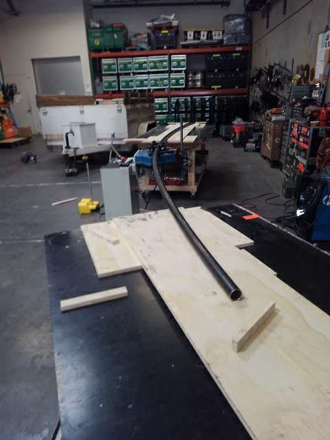

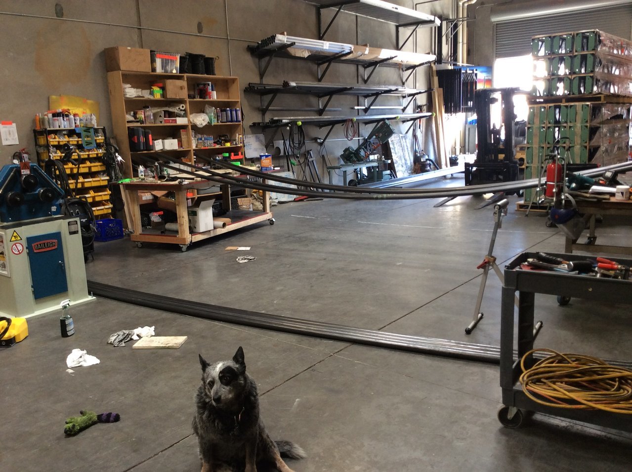

    Finally got to play with my new roll bender. I have to roll 12 21' 2" schedual 40 pipes to make 4 92' circles. Got 5 done today, my goal tomorrow is to finish the rest. They have to be perfect radius's to each other and form the circle exactly. Wish me luck.IMG_2553.jpg

    Interesting. I've been looking into using one to bend aluminum pipe for small boat gunnels. Please show more when you have time.

    Didn't really take any other pics of material when finished. Aluminum requires nylon does. The hardes part with a manual machine is duplicating the exact same radius on multiple pieces. I am getting the hang of it. I was also running 21' material, this is not the norm. The bender was expensive, but will pay for itself in a few jobs.

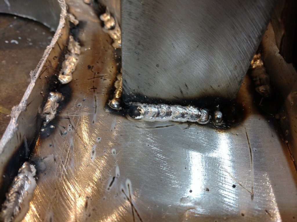

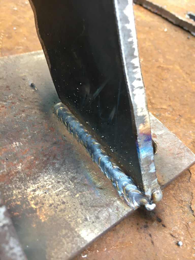

    My dads shop burned down a couple months ago. Lost literally everything. Even the electrical plugs. So all that's left is a cement slab
    Decided to build a racetruck while waiting on the old man to rebuild the shop and get electrical again so we can buy another welding machine.
    Decided to borrow a gay 110 welder to make some engine mounts
    Cranked that bitch all the way up to weld on some 1/4 lol.
    Wasn't smooth and not all the welds came out this good buttt I got a few good ones lol

    Not bad. Color me impressed.
    I so want to try out the new HF Vulcan machines. They are not in the same category of the original Chicago Electric craptastic welders.

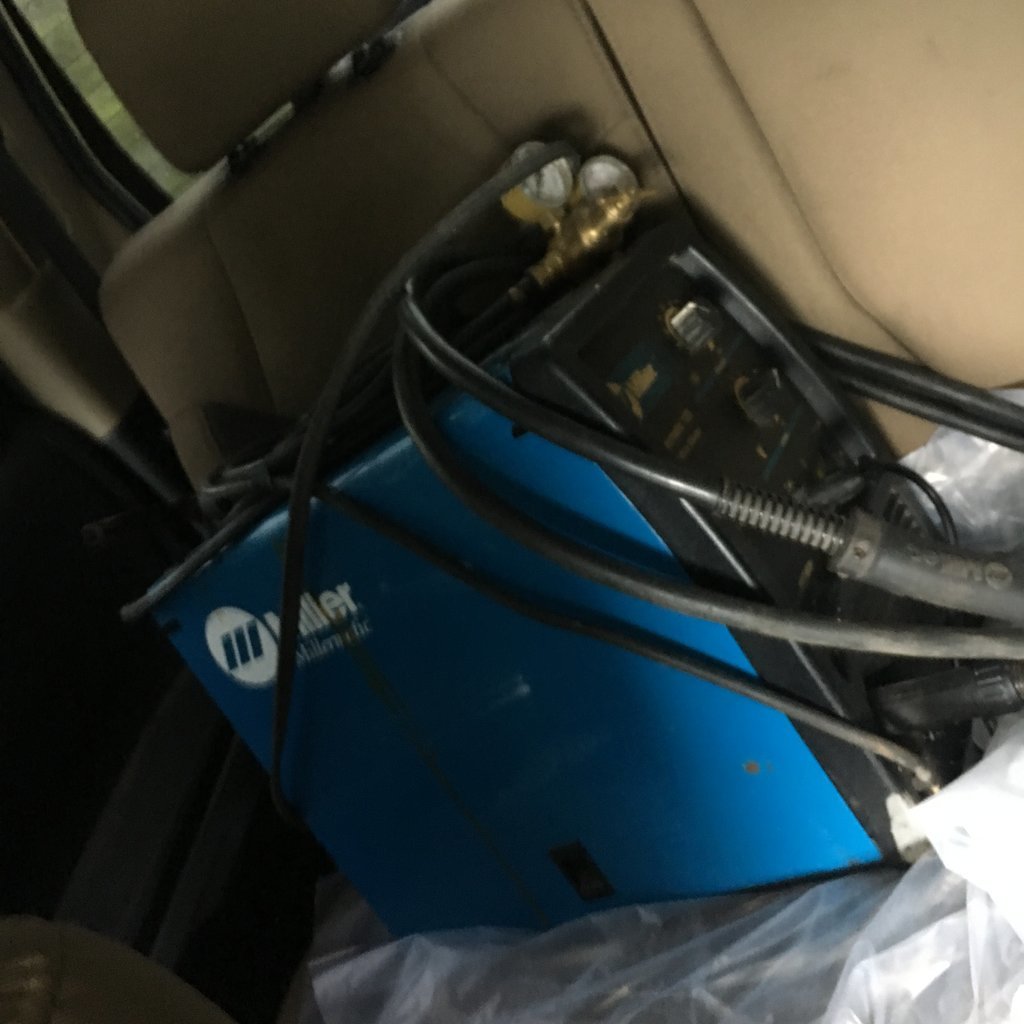

    This was the machine it was done with

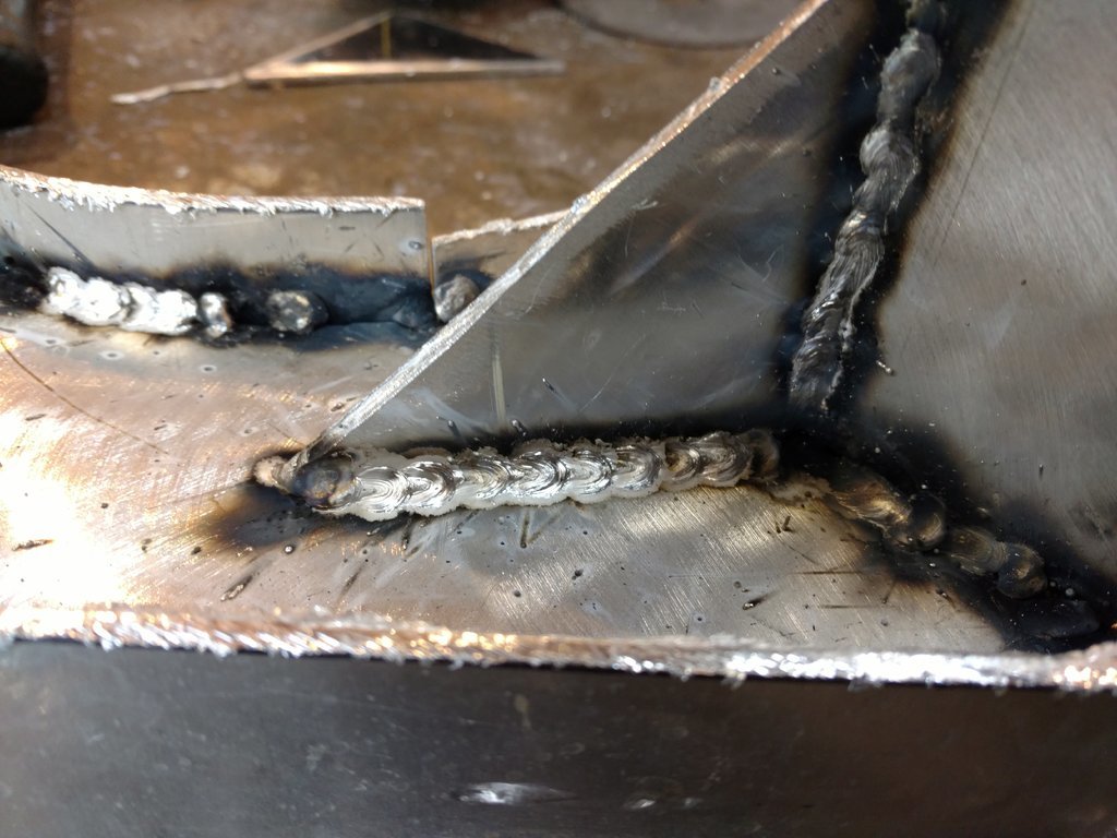

    I don't do a lot of aluminum MIG welding. Mostly iron.
    Feel free to critique my welds. Does it look like excessive soot around my welds?

    I have done zero mig al welding but i think i saw where u should keep the trigger slightly depressed at the end, enough for gas to continue to flow but the wire stops. Something something, aluminium solidifies differently than steel and the gas flow somethin something more.

    That's excessive IMO. Make sure your shielding gas (are you using 100% argon?) is working and has plenty of flow (like 35 CFH) and make sure to push rather than drag with a short arc. The smut is due to the magnesium, either in the electrode (5356 is high in Mg, which I assume you're using) or the base metal, combining with available oxides. You can try 4043 wire, that might reduce soot, 4043 doesn't have magnesium.

    I'll dial up the Argon. Im around 15. I am using 4043.

    With Aluminum, you must clean your material very well before welding. Wire wheel in a cordless drill works well, then clean as best as you can with Acetone prior to welding. Make sure your gas is up and slow down. Then do it again. Aluminum = clean clean clean. I stall when I come back towards the puddle before moving forward with each motion.
    Aluminum dissipates heat very fast, best to not have your material on anything that will speed up the heat dissipation. New fancy inverter machines will have settings for cleaning as the burn, but these machines are very expensive. Syncrowave 250dx or any dynasty machines have all this. My machine is a Lincoln precision tig225, it does not have all those bells and whistles, but I am just fine with what I have.
