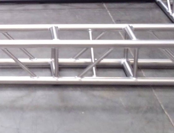

    No black soot. Pic taken after removed from jig and placed on the floor with no cleaningIMG_2561.jpg

    Impressive. That was welded with a spool gun?

    That was a spool gun. When building truss, I tack it all together with the tig, then spool gun it. It would take way to long to tig up all that truss. In my work, I mainly only use the tig to tack aluminum, and to do stainless work. I don't do offroad or car stuff anymore, if I did, I would use the tig more.

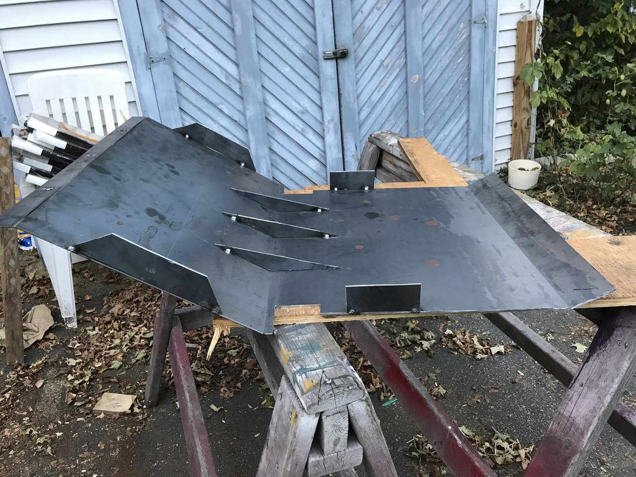

    Cut an access door in the firebox, played around w an idea for the latch, and tacked some reinforcement to the skid plate.
    I had been super busy for a month or so but I’m starting to find time to play again.
