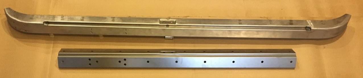

    And this is what Im needing it for (this time at least)...rear sill for a FJ40. Its really a pretty crappy design by Toyota and pretty much every factory rear sill is rusted. The rear bed basically sits (barly) on the larger piece then the cover piece goes over it and "sandwiches" the bed to the main part. But it all attaches pretty much via plug welds so cant really use regular primer. I do plan to use a seam sealer or something and not leave the pieces open like they were from Toyota. Toyota just did the plug welds then painted over it.

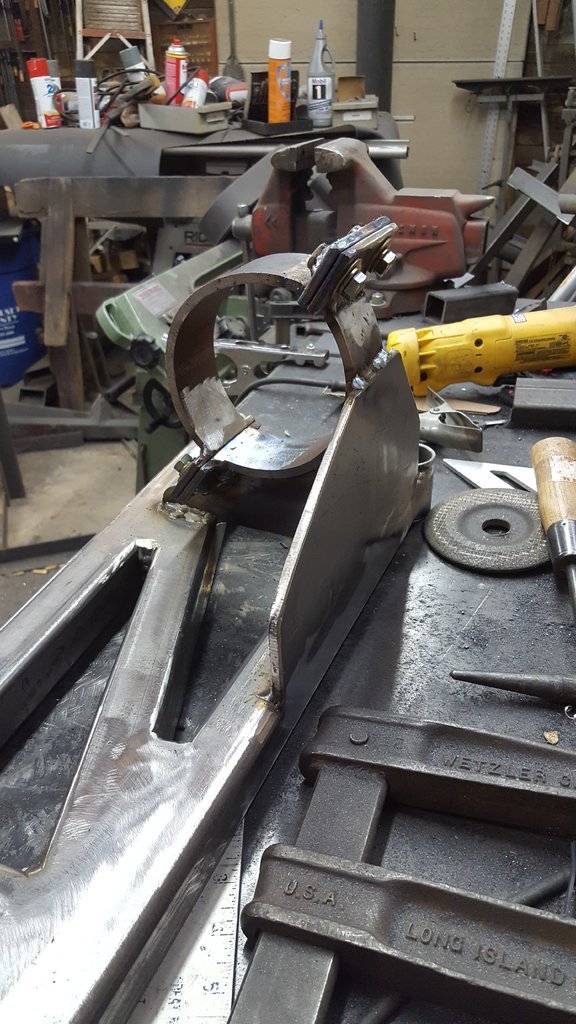

    Ladder bar in progress for a friend.
