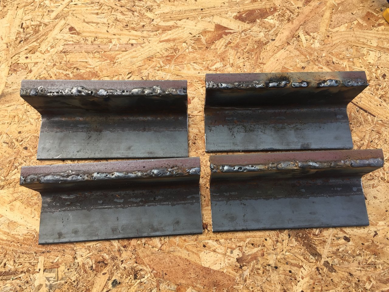

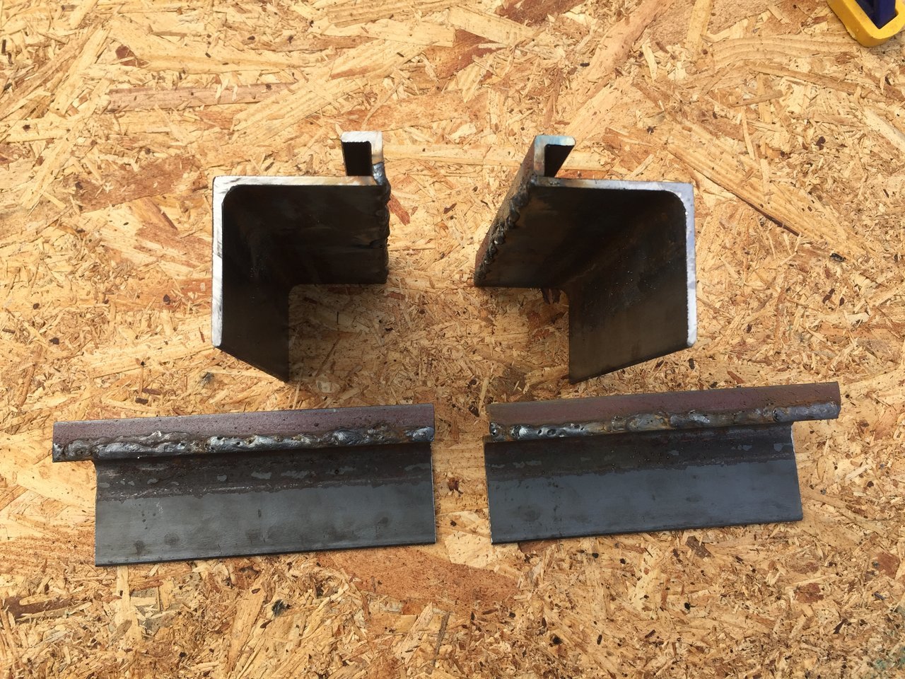

    Awesome! Thanks guys. I'll look at that tomorrow. Planning to cut up some more practice pieces.

    Im a novice also but looks like your wire speed is too slow or you are moving along too fast. Also gauge the metal. It helps to match the dials to your metal thickness. I would rather go a little hotter than not hot enough, but you dont want TOO hot to burn through.
    https://www.bernardwelds.com/tips-for-avoiding-common--p152077#.WfPszFtSyUk
    backcountryj[QUOTED] likes this.

    also your wire feed needs to operate smoothly...if its sticky or slipping it will be spotty inconsistent welds. at least on my machine it does that. when the tip starts getting clogged.

    I followed the guide on the machine for my wire speed and heat setting. Although there's no dial for heat on this little machine, just 1 & 2; high & low.
    I'm sure I was moving too quickly. Gotta get back at it.
    wilcam47[QUOTED] likes this.

    it takes practice and realize flux core isnt that pretty anyhow. If you can add gas to it, it cleans up welds. I always try to think of filling in the gaps when Im welding something. If look back at the weld just run the wire feed backwards and fill in the gaps and steady fwd to the end of your line.

    The important is to understand just what is happening and what needs to happen .and what you need to do to make it happen
    All our eyes are a little different with a low output machine like that I need the autodark hood set as low as it will go.
    Make sure your cover plates are clean they get dirty over time .
    Set yourself up to be very comfortable
    backcountryj likes this.

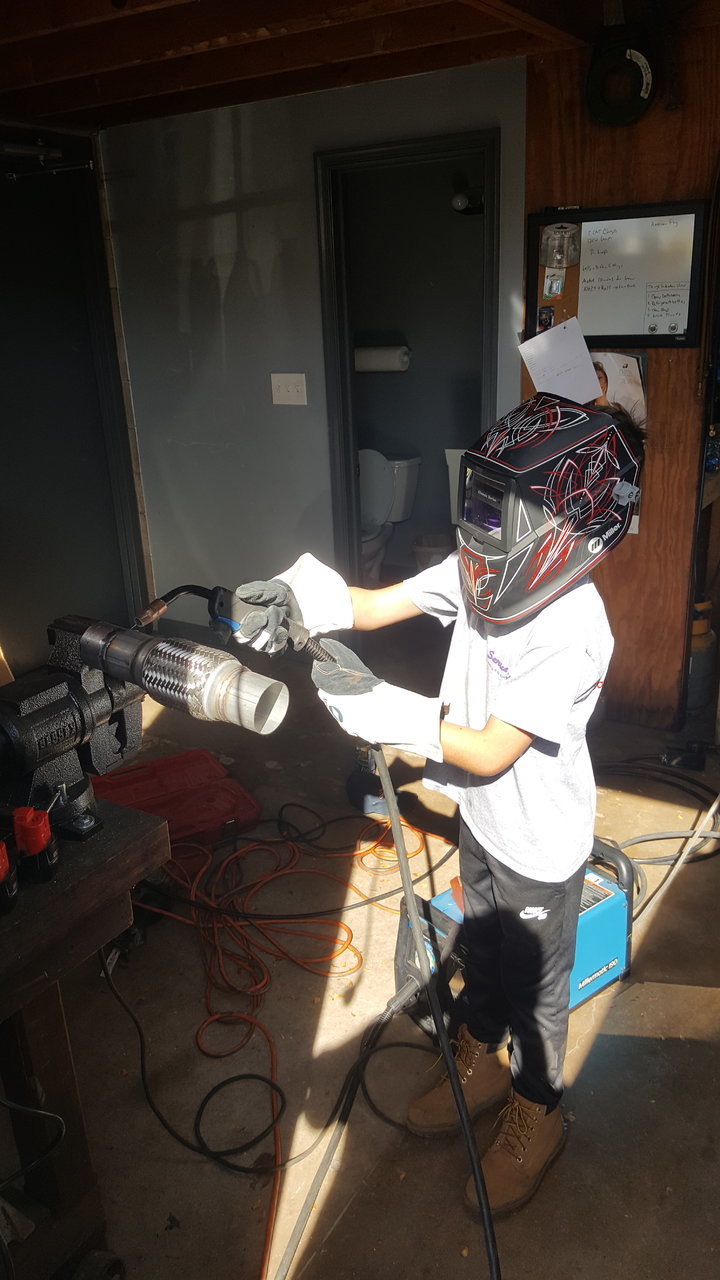

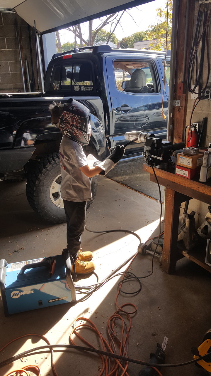

    Let my 10 year old nephew try. We let him try everything. Later he was cutting and threading pipe.

    I would if I knew how to. Just got back into welding and fabricating myself so for now it's MIG.

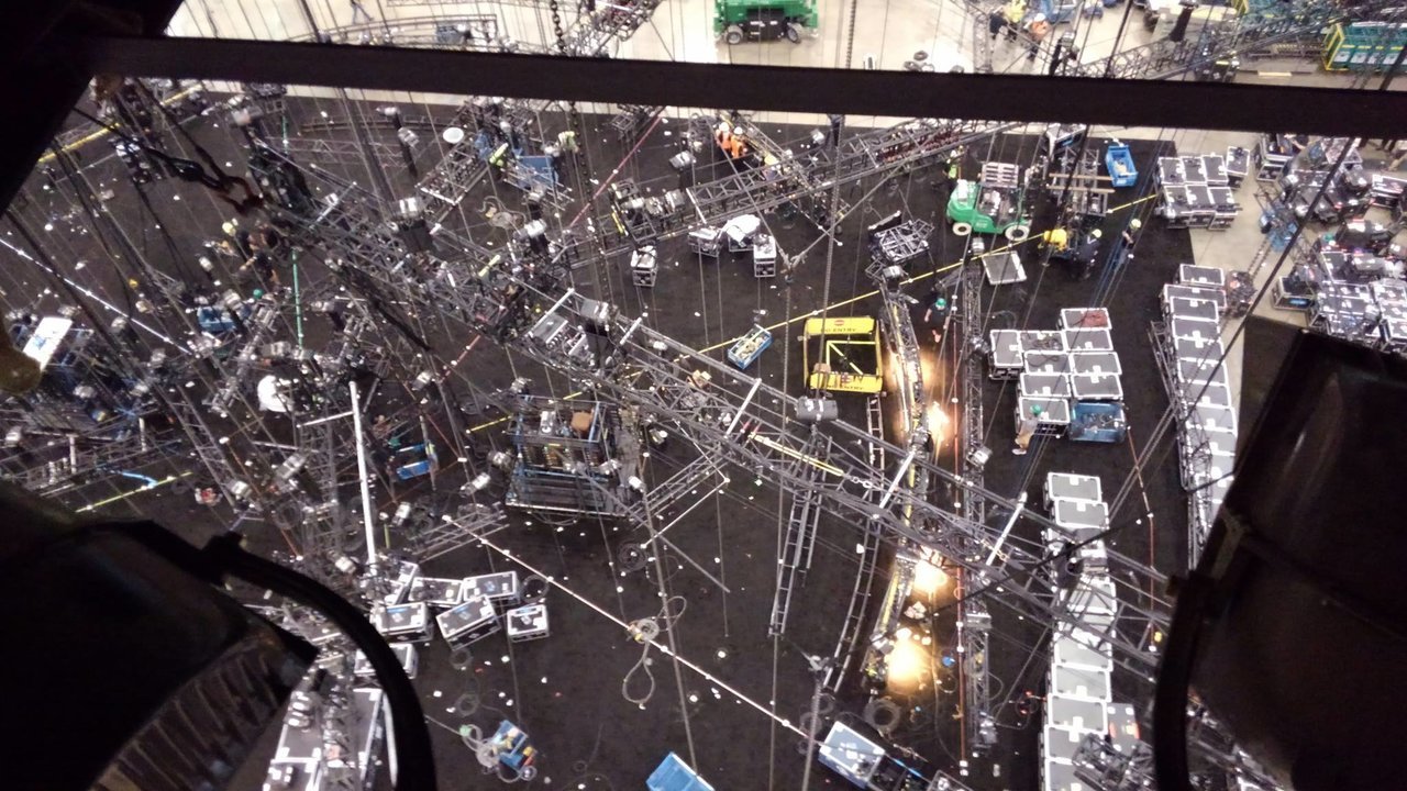

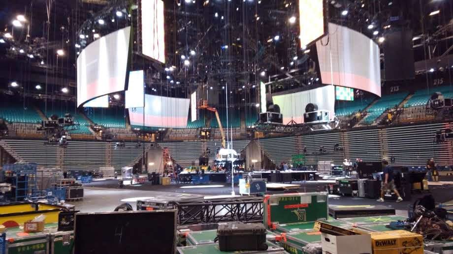

    All our truss is Tom cat, but I am very familiar with showrigg and the owner Eric. The show rigg shop in Vegas is about 20 times bigger then the one in Gardena, I think Eric has 6 buildings now, and is right down the street from my shop. I do some stuff for Eric, but it is mostly smaller one off stuff. They have a big fab shop, but are way more of a production kinda shop. I bet showrigg has over 250 employees at there vegas compound.
    We rent stuff from showrigg sometimes, but for the most part, our stuff is fancy corporate events, we need clean new looking clean truss because a lot of it is exposed and visible, and showrigg truss looks like it has been dragged across the highway from Denver to LA. I'm not doing anything at Sema, but I did just send a bunch of stuff out for GM, Acura, Honda and Subaru. I am not a Rigger, I am the fab guy that builds what ever the rigging industry can't get off the shelf. Below are pics of the kind of corporate events I deal with. For the most part it is all large stuff. These pics are a corporate event at the MGM grand arena. Over 400 points, 180,000 lbs hanging from the ceiling. All LED video walls are automated and move up and down and side to side. Actually very complicated set up with a shit ton of coordination to pull it all together. When it was done, everything was removed and out the door in 24 hours. Only 25% of my stuff stays in Vegas, I send stuff all over every week. Problem I have is that it is hard to find skilled labor in Vegas, and I can barely keep up without killing myself.

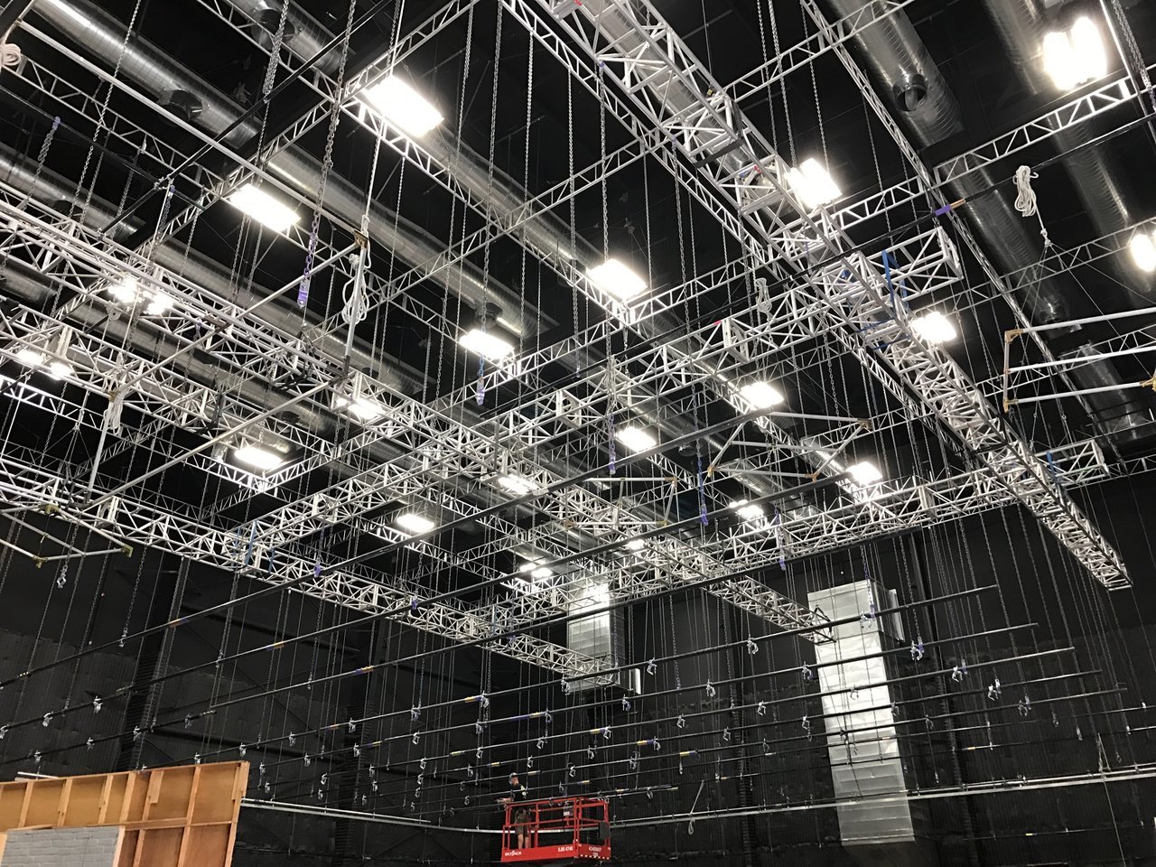

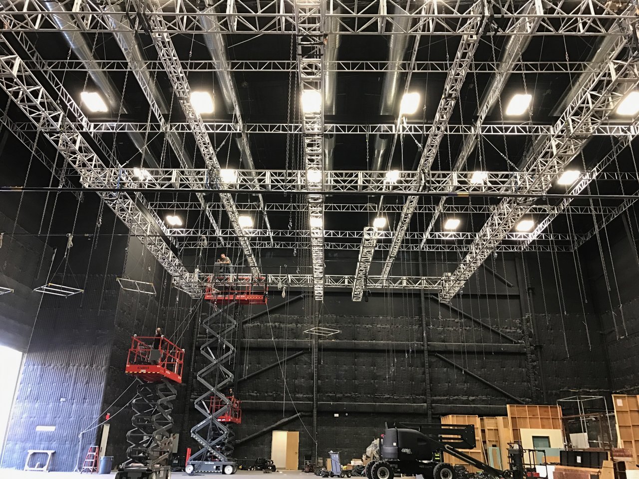

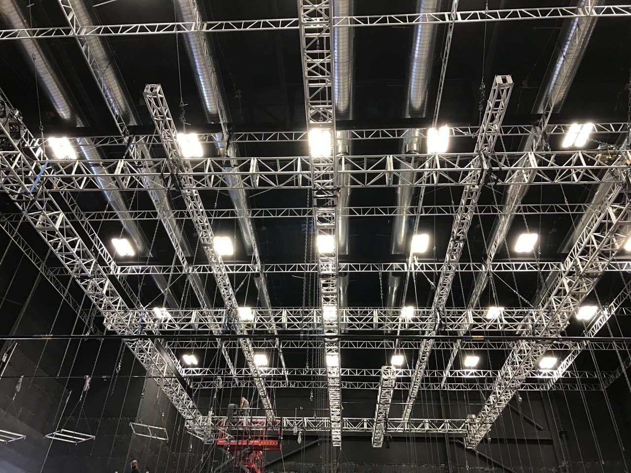

    We just did this little truss rig in a stage where there was no permanent scaffolding so we could hang our entire pipe grid and lighting cables off of.
