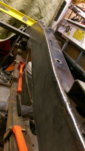

    Make it fit inside (or pretty close to inside) and weld the edges.

    a friend of mine just said the same thing. Makes sense using the steel for strength vs my welds... is 3/16" too heavy for this application? Maybe 1/8?

    Inside. Could probably even get away with stitching your piece 4" on 12" to get good surface area without having to kill it with weld.

    Frame is 1/8"....least where i checked by the rear leaf spring hanger. Id use either 1/8" or 10gauge (id lean more towards 10gauge)

    I tried to do mine so they fit along the edge and left room to lap the weld to both pieces and make a nice rounded corner.

    I understand inside... but I feel welding will be more difficult. Thinking what @Whitecloud said down here makes most sensevvvvvvvv
    No way... it's gotta be 1/8. Flimsy and weak

    You bevel the 4" stitch sections before you flush mount it. Then fill the stitch sections tying into the C channel.

    If it was me boxing in that frame, I would make the plate just a touch bigger than the frame.
    The bottom I would place the plate inside the frame with enough of the bottom frame piece sticking past the new plate to run a bead. This gives you an inside angle weld.
    The top I want the plate to run past the top of the frame so I have another inside angle weld.
    So what if the inside plate is not quite vertacle.
    I'm lazy and will do anything to keep from welding upside down.

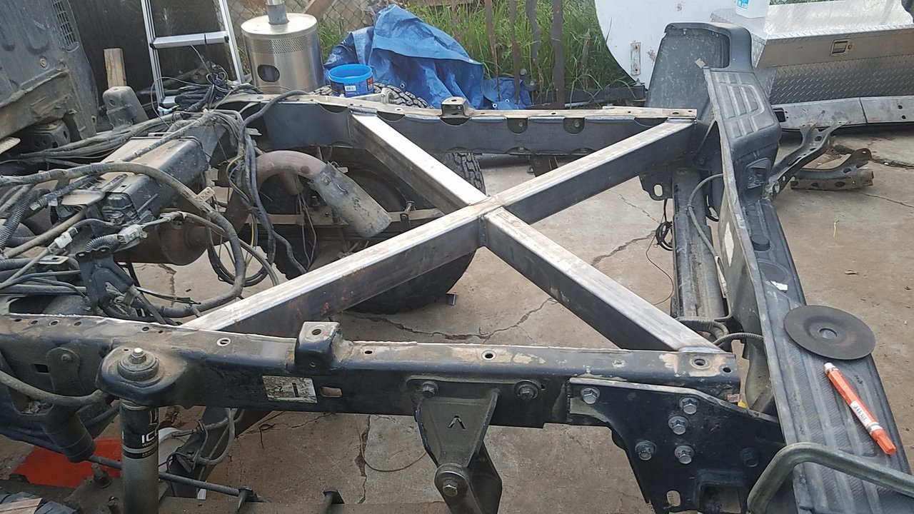

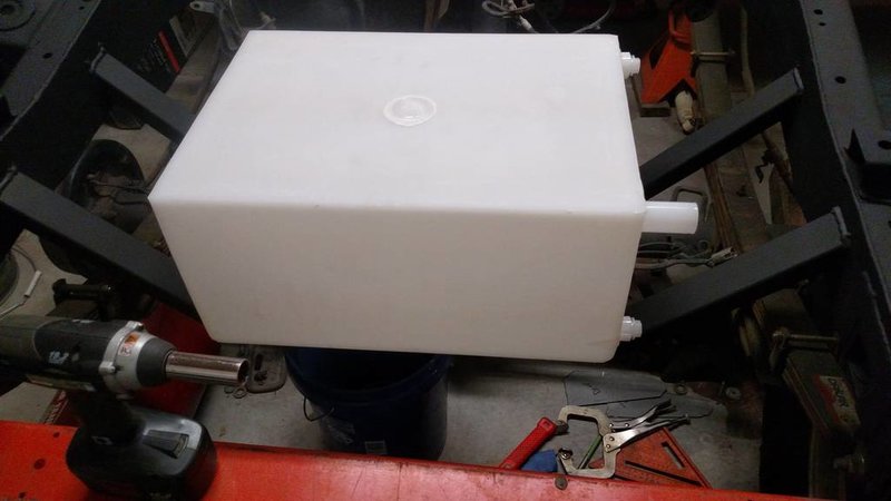

    Worked for me. Haven't had any issues. Check my build thread and pics. Have lots of them up there. Rebuild the cross members also, including the rear gas tank mount.
    Cross member mounts...
    Frame plate......
    Water/air/skid mounts....

    Forgot to ask. Are you doing this for strength or to seal it up? If you're just sealing it, go as light as possible. If for strength, you deff don't need to box the entire thing the whole way.
