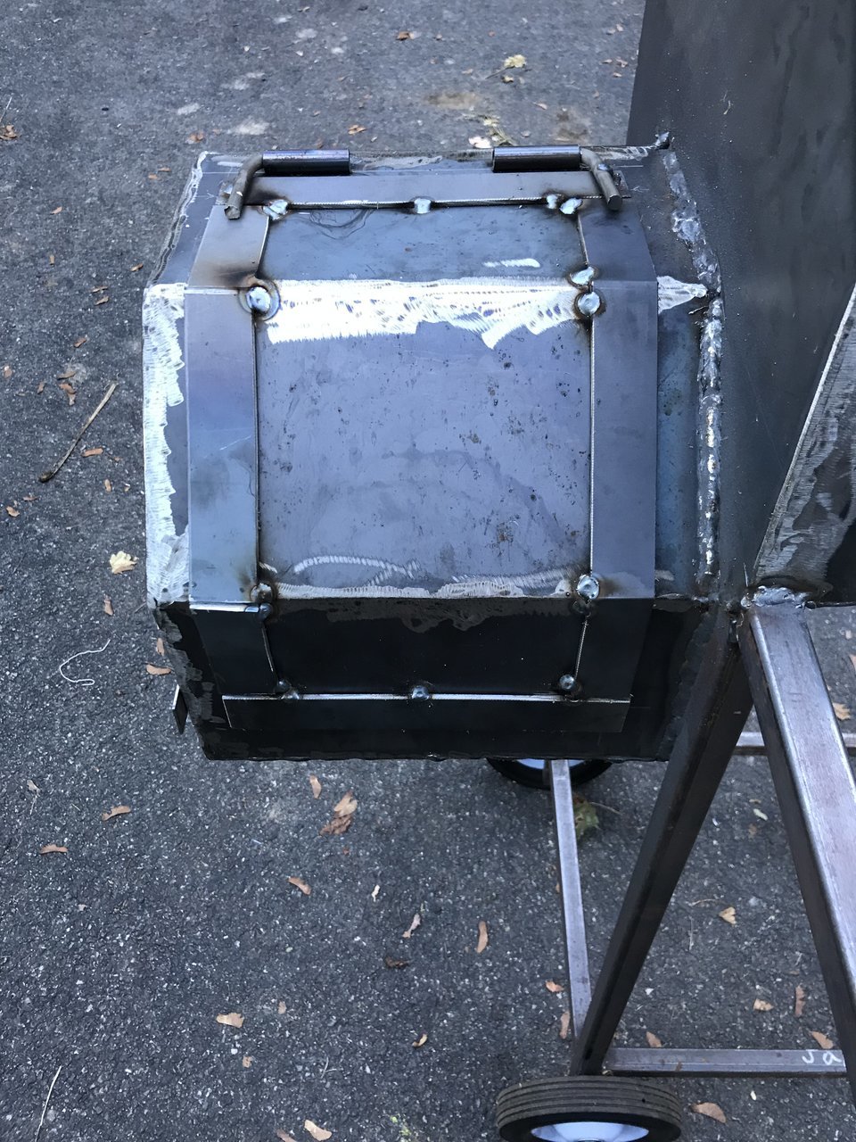

    So I got some new flap discs to clean up my smoker, but a lot of the surfaces are not cleanin up with the disc.
    I did wipe them down w acetone to clean them, then wire wheeled. I think I just rubbed acetone into the metal by wire wheeling it...:anonymous:
    The grinding wheel brings it to bare metal, but isn’t as nearly as polished as the 120 grit flap discs.
    I’m just trying to understand what’s going on. Did the acetone / wire wheel burn the bridge for using the flap disc?
    I’m hoping the paint will even out the surface? That way I don’t have to grind, then flap wheel

    The acetone evaporates. It's not going into the metal. In regards to the flap disc, shouldn't matter what you go over. A flap disc should smooth out bare metal until the disc is warn.
    If you're using a flap disc over old paint that's a different story. You can load a flap disc with paint. In that case a wire wheel is best used first, then a disc.

    95.5 OME
    Thanks for responding:fistbump:
    The metal hasn’t been painted. I bought it fresh from the supplier. I think it has only had stuff on it from the supplier so it won’t rust.
    The surfaces that I hadn’t rubbed w acetone seem to be cleaning up fine. Doesn’t take much pressure to reduce it to bare metal.
    I don’t understand why it’s behaving like this:notsure:

    They’re 120 grit from benchmark abrasives.
    They’re cleaning the tube and angle fine, but not doing much for the 10 gauge plate.
    I’m just trying to get it all to bare metal so the paint sticks well.
    None of the metal is rusted

    Hmmm I think it’s all mill scale:(
    Blueish Gray is what google is coming up with. Another link I read was that flap discs just gloss over mill scale. God this stuff is evil
    It looks so consistent I figured it was a coating.

    I've had good luck using "The Works" toilet cleaner. It is Hydrochloric acid (weakened), but it does cut the mill scale. I use a pressure washer to remove the acid and liberated mill scale. I mix it 50/50 with water.
    It will off gas and it will bring you to your knees if you get a snoot full. Do this outside.

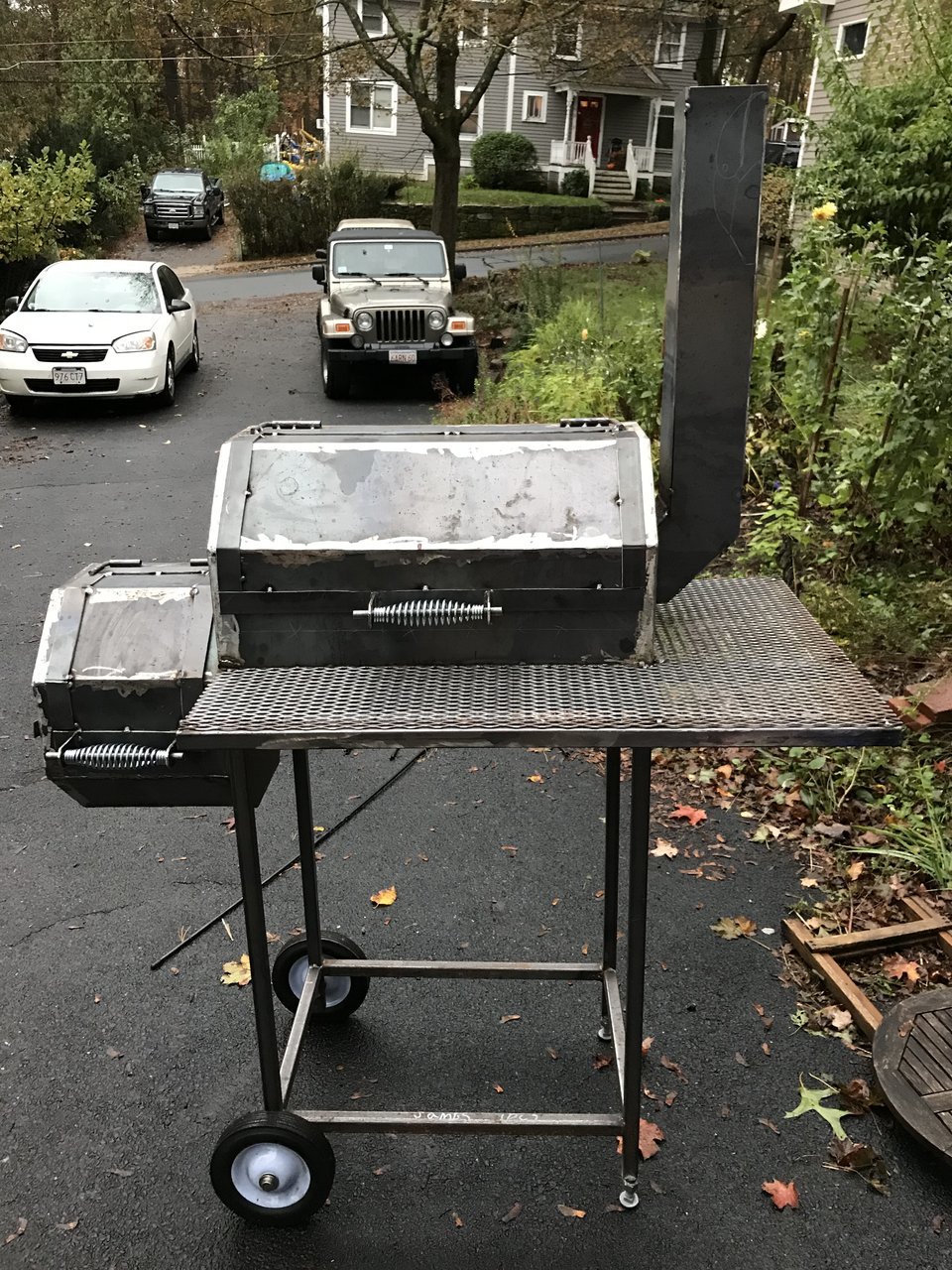

    I went to the garage to snap a pic, but it’s too dark out.
    Here are some other pics until the morning. I’m guessing it’s mill scale.
    I see why people hate it.
    So on th second pic you can see where I ground down the welds to clean them up. The rest of the plate is not shiney or lustrous. More of a plain smooth blue / gray.
    I think I found my new enemy.
    I may try to rub it clean w some chems tomorrow. Or just grind forever

    Yep, mill scale.
    Hit it with HCL, rinse, watch the whole thing flash tarnish, then hi temp paint it.

    Just wheel her off to you see silver. I have fucked up wrists because of the pipe welding trade. But the attention to detail pays off. You'll get it.looking real good though. 90% there
