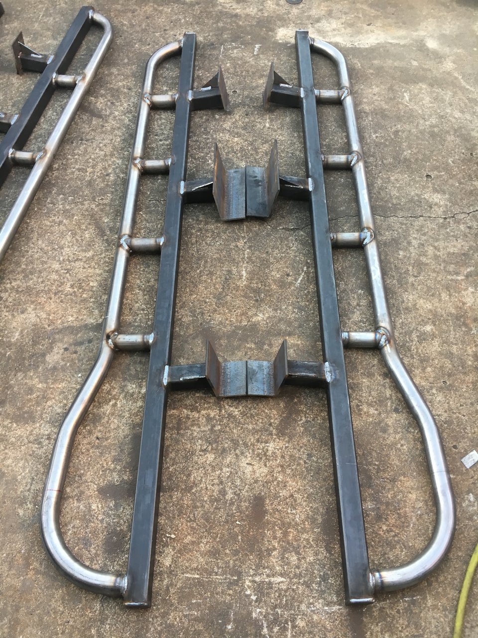

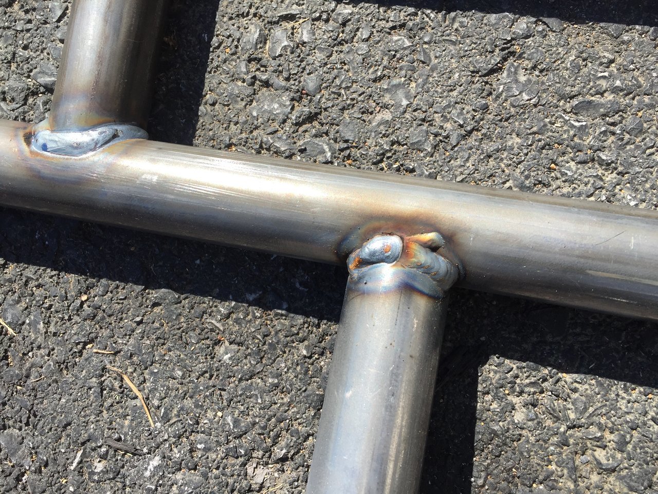

    I miss welding. I use to be a production welder/fabricator for a small SXS offroad company and it was one of the best jobs i've ever had. I do not miss busting my ass in AZ heat welding 8+ hrs a day. I was shoe'd in by a good friend who taught me the basics and I was lucky enough to hover over him for a week to learn the ropes. Once set free I found myself heavily into Mig welding.. I did have to play grind bitch for a bit which made me become a better welder as i fucking hate grinding and/or deburing. With-in a few months I was one of the Top welders @ the comp and my production numbers weren't the best & def not the worst but my welds, form fit and function was above everyone else. Its amazing how much of a difference in something fabricated is when the fabricator takes pride in every thing to produce that product.
    During my employment at this fab shop I found myself stuck with the ugliest/least liked weld machine & table.. Both had seen lots of use with very little care/maintenance the last few years before my arrival and I revived the table & machine after some time.
    Mostly welded 1 3/4" .060 and smaller/thinner. My machine was a Miller 350P and everyone hated it and loved the miller 252's.. Granted the 350P had a weird bernard gun that no one liked.. Either way heres some pics of my welds.

    Nice Welds. I like how you layed them smooth vs stacking... Much Harder to do imo.

    Each day the material would weld different, Being production i'd have to keep consistency as i would have to weld up a left or a right side too.. So i'd review gaps and after time knew where i was going to have gaps with what ever product i was welding and if the gap was tiny and machine/material was metling good i'd weld smooth, if i had gaps i'd have to weave and apply a pattern and make the weld bigger if one side had a small gap and other matching part have a 1/4" gap.. you know.. The hard part was 180* welds that had to start at the bottom and run up word back to down ward and so.. keeping weld convex and uniform.

    Exactly. All the little details. Takes a lot of practice to get consistently good at any position/fit thrown at you. They say "get comfortable" I say just weld it!
