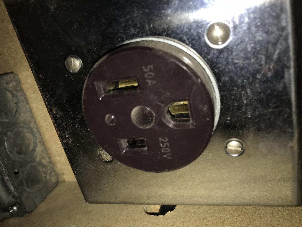

    Quick question before I spend a bunch of money — just moved into a new house looks like it has 200 amp service and there is a 250v 50a plug in the garage.....
    Am I good to go for a hobbyist setup?

    You would want to know what the breaker is good for and not just the plug. The stamping on the plug just let you know that plug is good for up to 50a. Also what the wire is rated for as well (if you can tell at least) just to be safe. Ive seen people put 50amp plugs on 20a breakers which isnt to big of a deal IMO. Whats an issue is when they do it with 14-16 gauge wire....

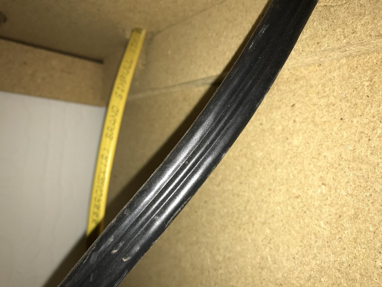

    How do I know what the breaker is good for? On the breaker box it says 200amps but I have no idea what the wiring to the garage is.....what am I looking for ideally?

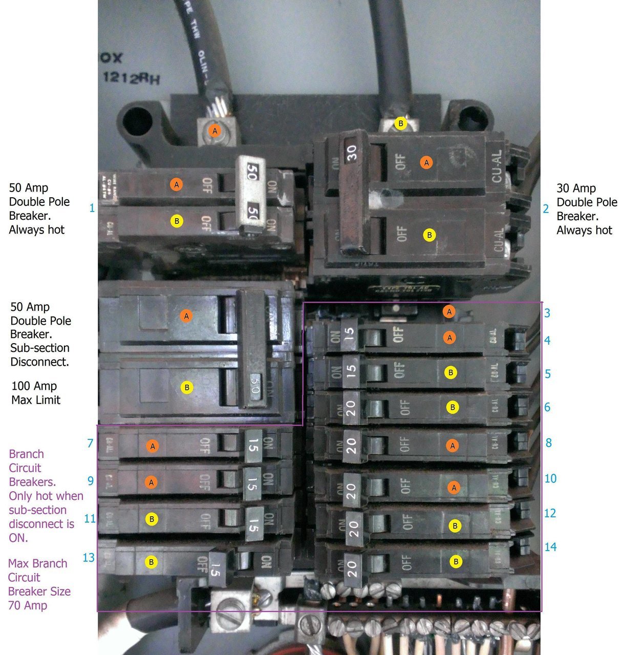

    In side the box you should see this type of array, what you’re looking for will either be 1 or 2, I’m not sure if it’s typical for people to have them wired to always hot or a disconnect.

    You would be looking like in the picture 95 taco showed. A 220v breaker will be bigger and have two "linked" switches generally. If you have one labeled "range/stove" or "washer/dryer" you would be looking for a similar looking one to that. It will say on the circuit breaker what it is rated for.
    As for wiring it depends. If its a newer place with romex you can base it on the sheathing color of the wiring. I believe (double check) its orange is 10 gauge, Yellow is 12 gauge White is 16 gauge. Black is usually smaller than 10 gauge (6?). Another way to check would be if yo uhave wire strippers with the sizes on them...turn the breaker off to that outlet, take the cover off, and see what size stripper fits around the individual wire and that will give you the size.

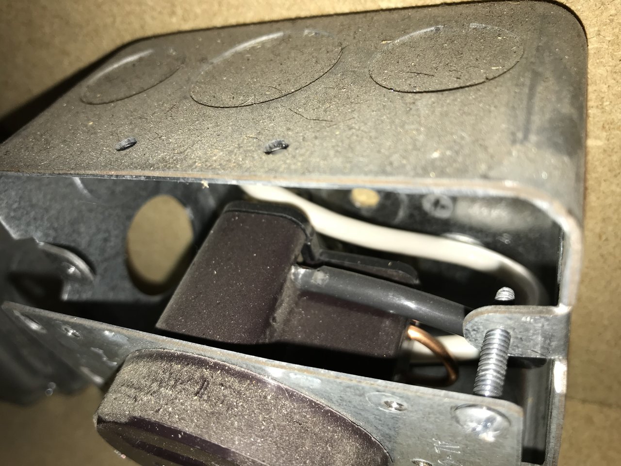

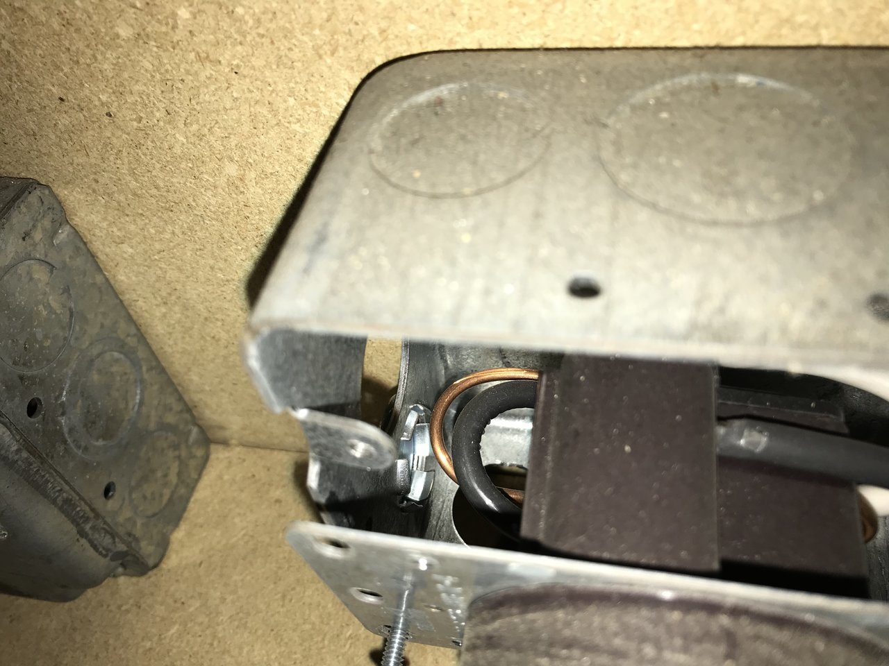

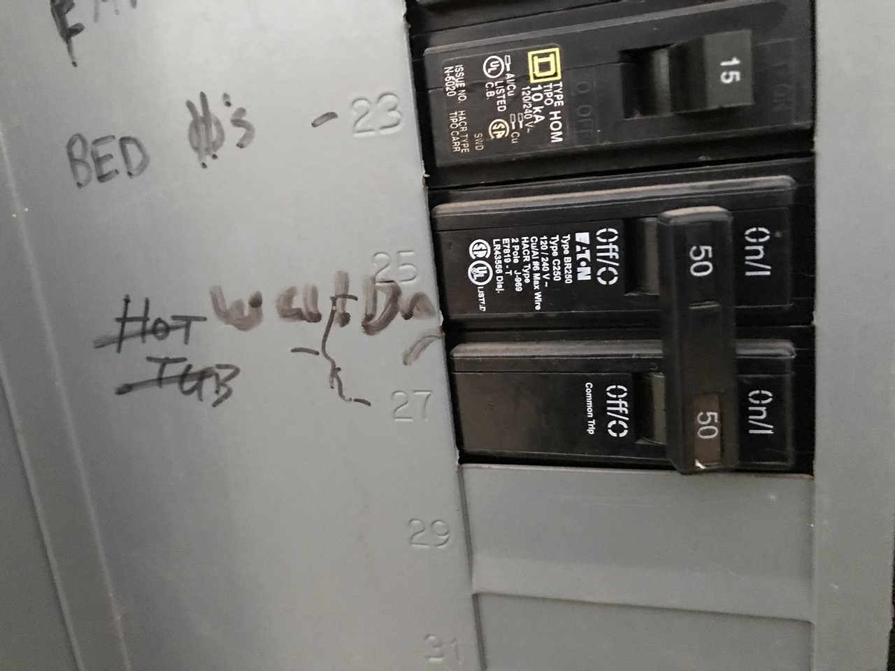

    So here is what I found. That plug is attached to a 50 amp breaker via heavy gauge wire that goes directly out to the main breaker box (only like a 18-24” run) and after pulling the cover on the plug it looks like 10g wire based on my eyeball assessment looking at a wire stripper. Good to go?

    Just to make sure I understand you right...the outlet to breaker wire run is only 18-24"? Yeah you look fine to me...but Im not an electrician either :)

    If it is 10 gauge, then the breaker is too big.

    What should the breaker be for 10g wire — 30a?

    Yes. 6 gauge for 50 amp

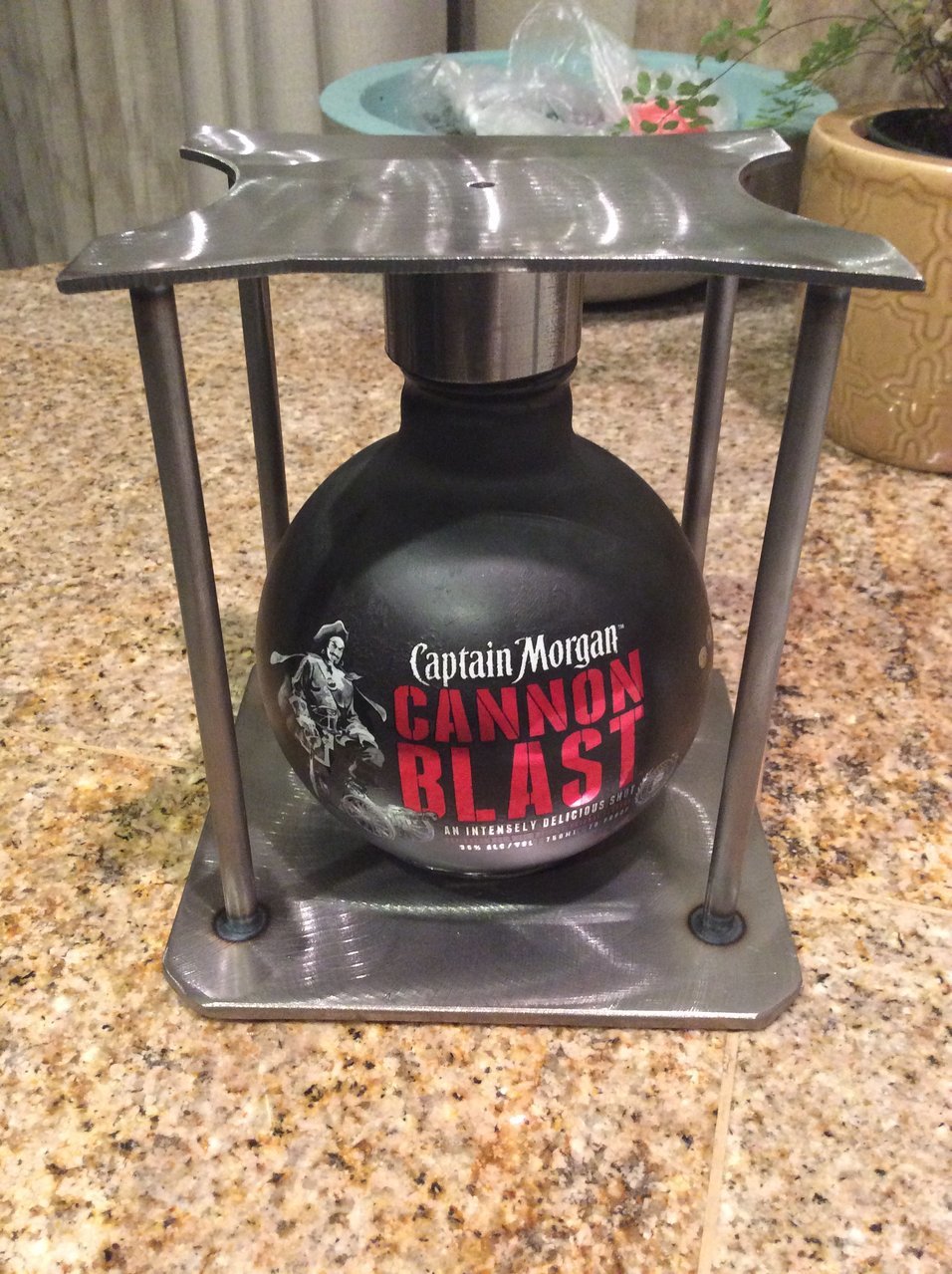

    Present I made for a coworker who knows nothing about metal working hehehe.

    A Rum chastity belt! Damn unique I must say.
