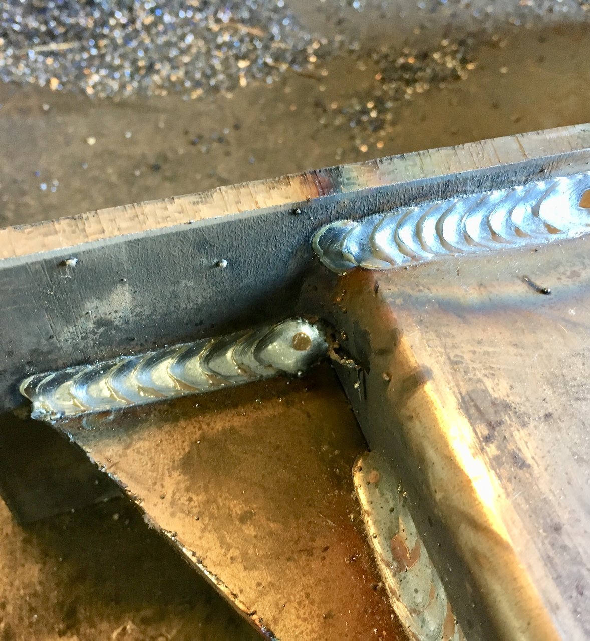

    Shmellmopwho
    Shmellmopwho Well-Known Member Vendor
    Apr 10, 2014
    #127399
    11,682
    Lomita CA
    2013 White DCLB TRD sport
    Bunch of stuff
    Just like the way this one looked. Was trying to trace the puddle a little closer and liked the way these turned out. Gonna keep trying to get better

    Cursive e?
    Back a forth?

    Very nice!
    Your welding technique is very close to mine. I don't like a lot of welding meterial on my welds.

    That had to be straight, move, pause, move.
    I like it because it is quick and uses no extra, unneeded wire.
