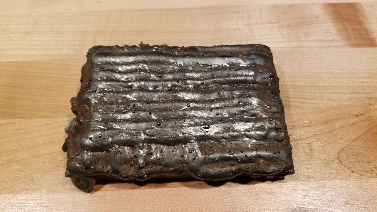

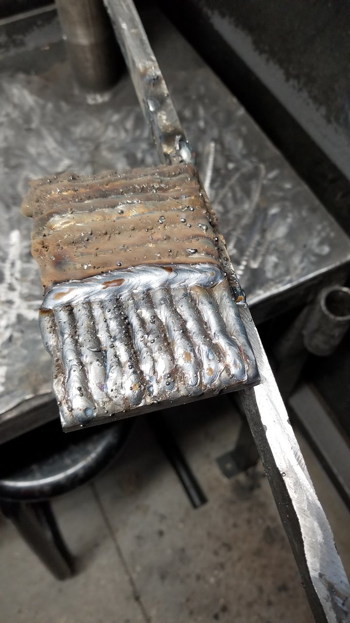

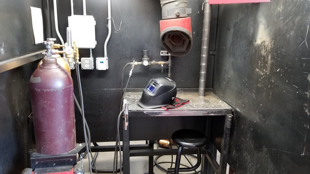

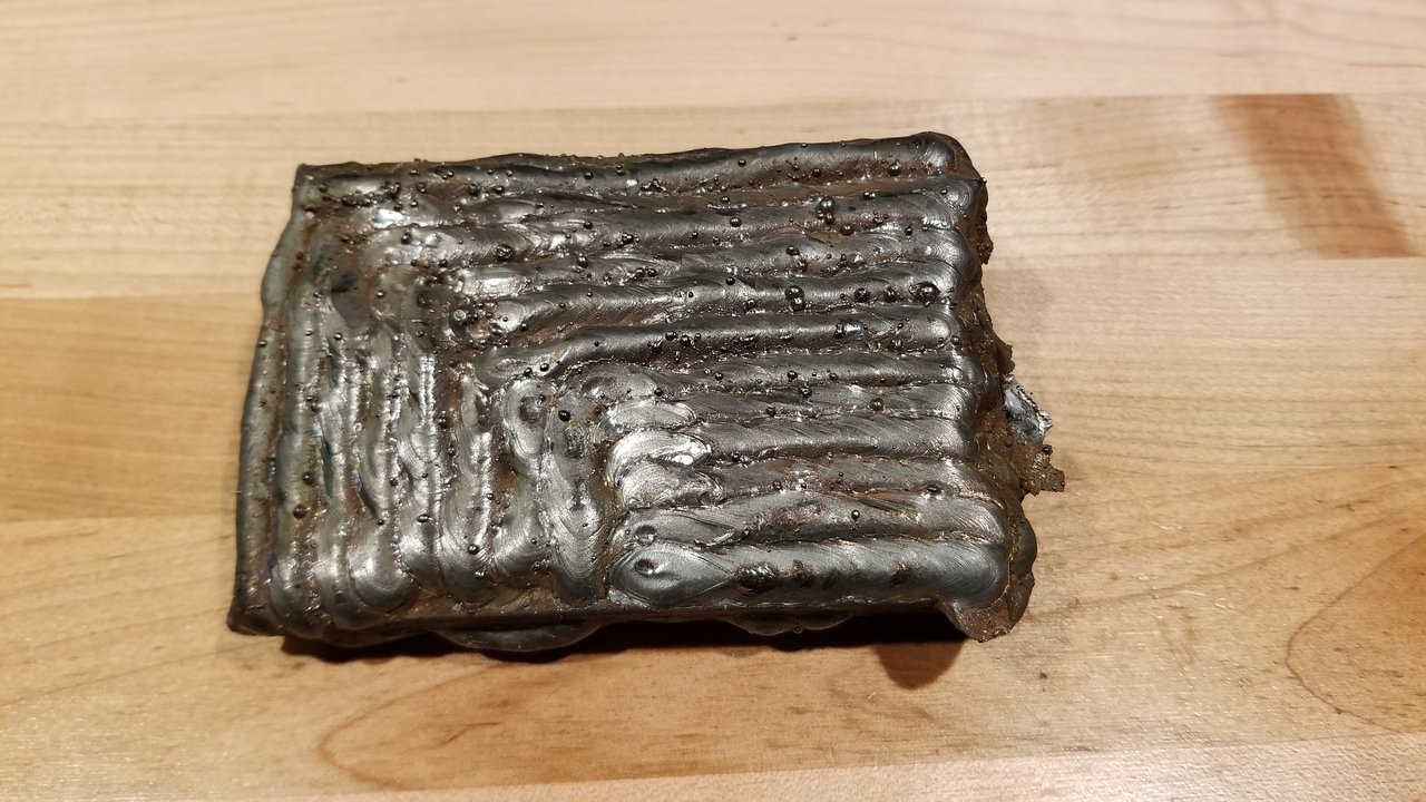

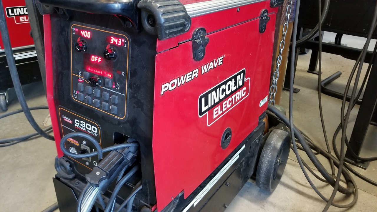

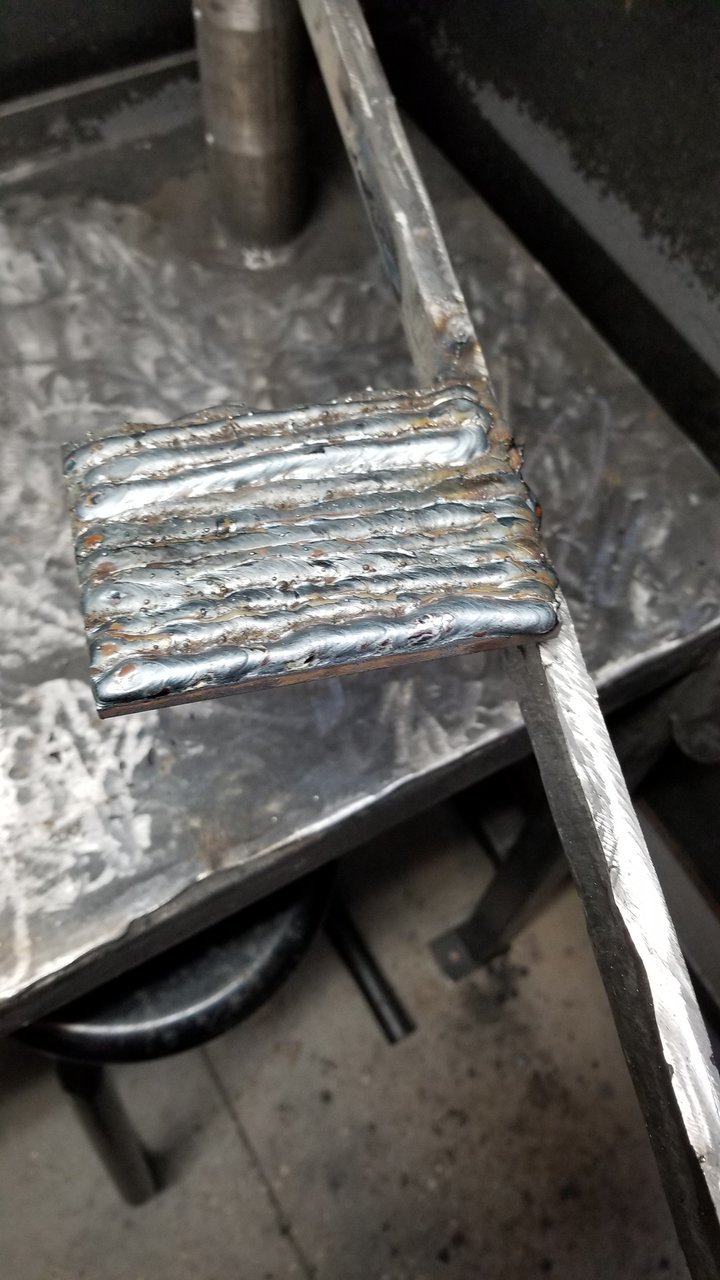

    First day of welding class at the local community college and I had a great time. I've always wanted to learn how to weld ever since I built a CJ5 12 years ago and had to farm out all the welding. Now my Tacoma needs a cab mount chop and weld on alignment tabs, so no better time than now to learn a new trade. I have zero welding experience, so go easy! Today the instructor gave us all a coupon and said we would be using it for the next 2 classes, so basically weld the hell out of it. He showed us some of the basics of the machine, then turned us loose to experiment. My initial welds were pretty rough, but I began to get the hang of it (sort of) after about an hour of making passes. He told us he wasn't going to critique any welds until next week; the goal of today was to get everyone up and running. I'm very much looking forward to laying down the proverbial stack of dimes! For now, I'll settle with globs of weld. :)
    Today we used what the instructor called the "shitty gas" 75/25.
    Most of my practicing was at 200 amps and 19.5v with .45 wire.

    Running straight beads on the first day? :thumbsup:

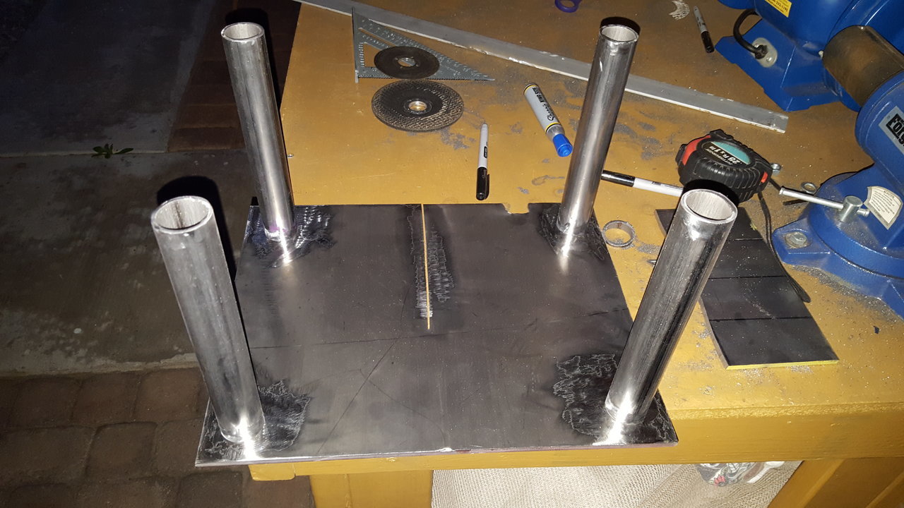

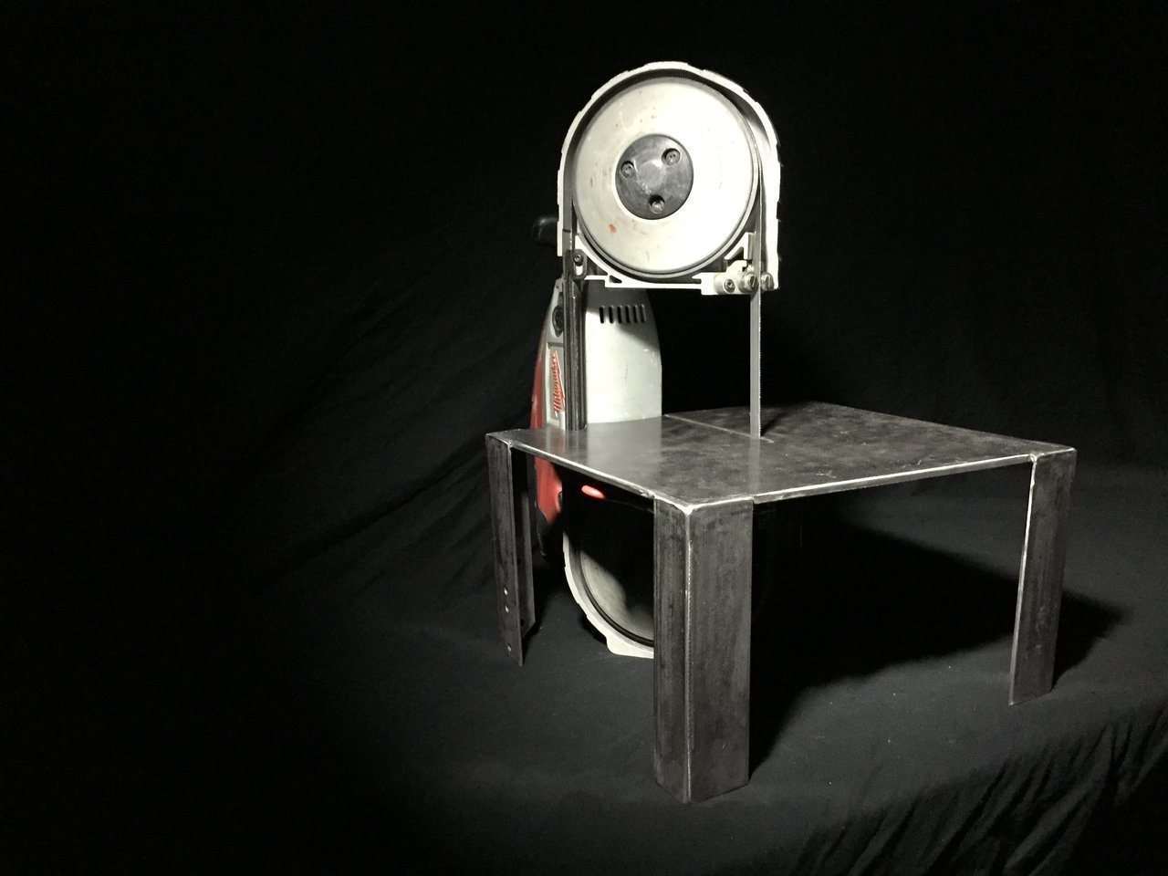

    Portaband stand in the works...

    @Rakso
    Drill an 1/8 dia hole at the end of your blade access slot. For easy chip escape and also to keep the tooth set from rubbing on the steel.
