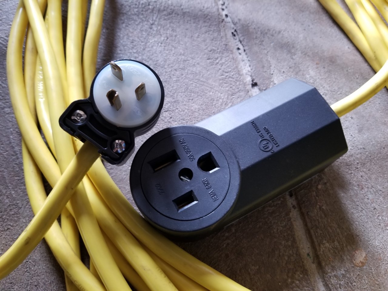

    I run my welder on something similar:
    stairgod likes this.

    I'm confused. You go from a 20 amp 120v plug to a 50 amp 240?
    Drainbung likes this.

    Yes, it's a 20A 240v circuit. I used that 50A receptacle because that is to match the 240v plug the machine came with. The MM211 pulls less than 20A anyway.
    Cid and Drainbung like this.

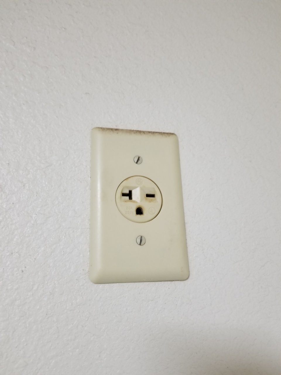

    It's actually a 240v receptacle if you look closely, so you can't plug any 120v stuff into it.

    You are right. I didn't notice the orientation on my phone screen. Zooming in, I see there is no way to plug a 120v plug into that.

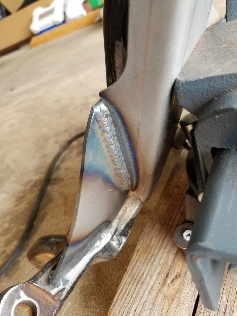

    Sliders are tacked on just gotta burn them in and done.
