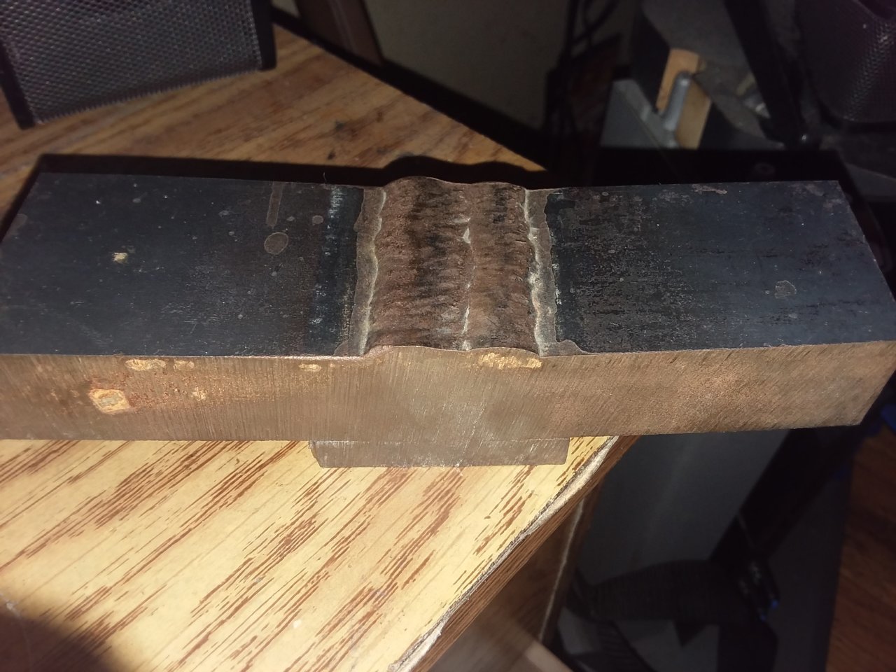

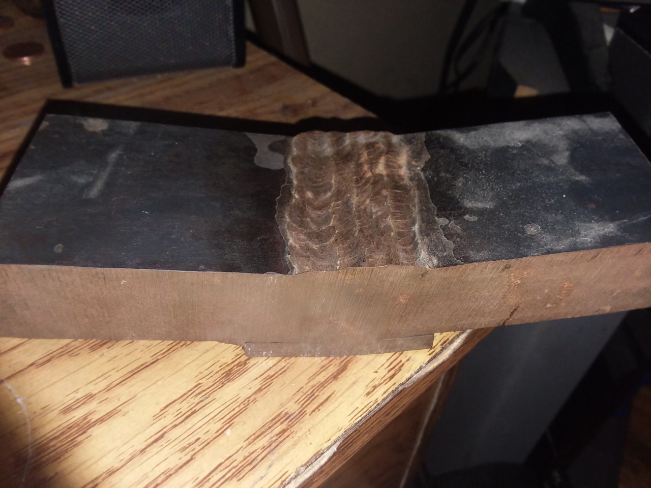

    Here arevsome pics of when i was getting ready to take my awd d.1.1 cert test.
    First pic is overhead stick with 7018 rod a 1 in v grove
    2nd is fcaw overhead on a 1in v grove
    3rd is vertical mig on a 1/2in v grove

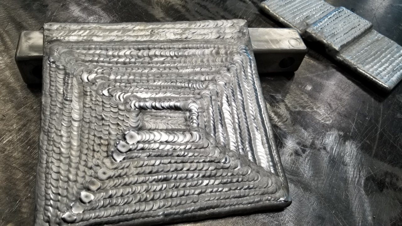

    Any advice from the pros?
    Just practicing some pedal control and dab techniques

    Looks good to me. You are far more consistent than I am.
    What thickness aluminum you welding on? Tungsten size? Filler size?
    icetreye[QUOTED] likes this.

    1/4" plate
    1/8" E3 tungsten
    1/8" 4043 filler
    stairgod and Titus94 like this.
