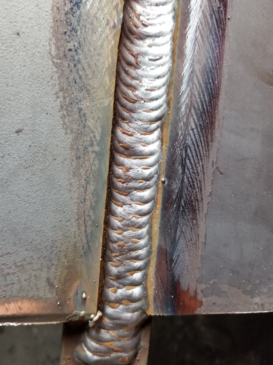

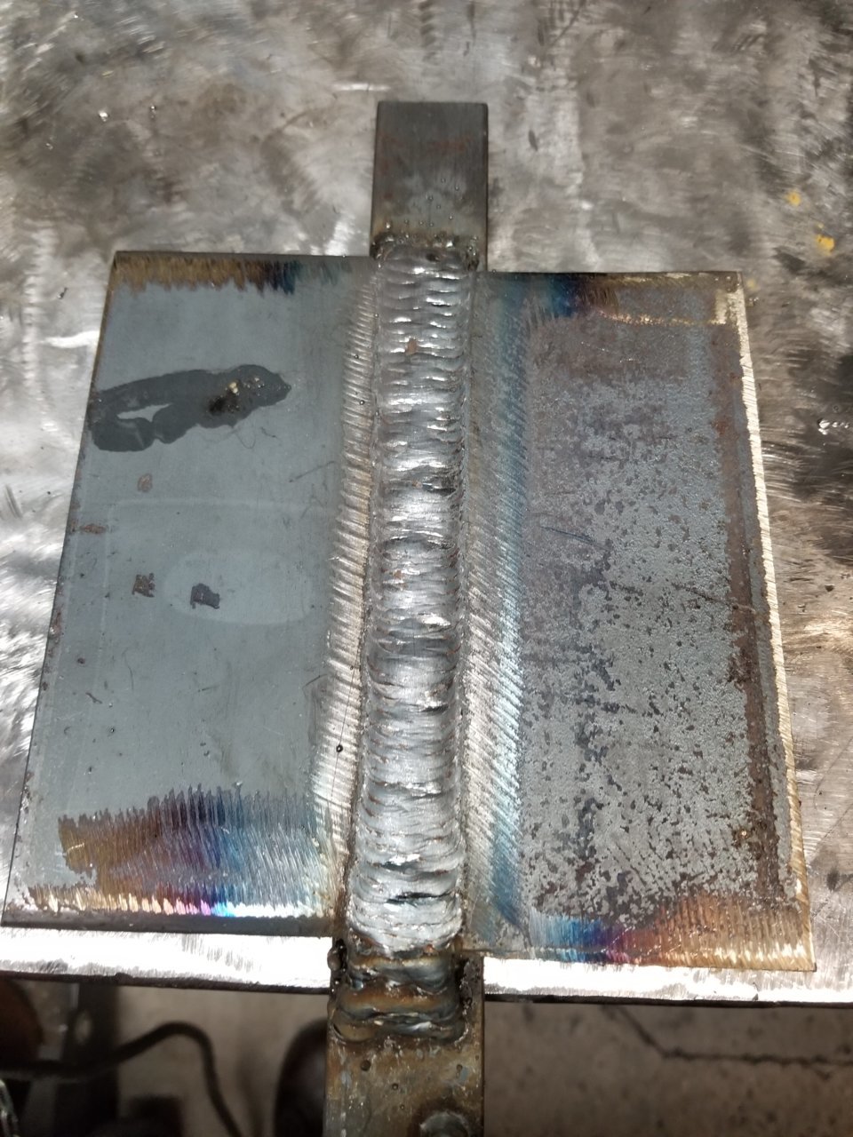

    Practice, practice.
    Vertical up, 3 pass on single v with 1/4" gap.
    2 passes:
    3 passes:

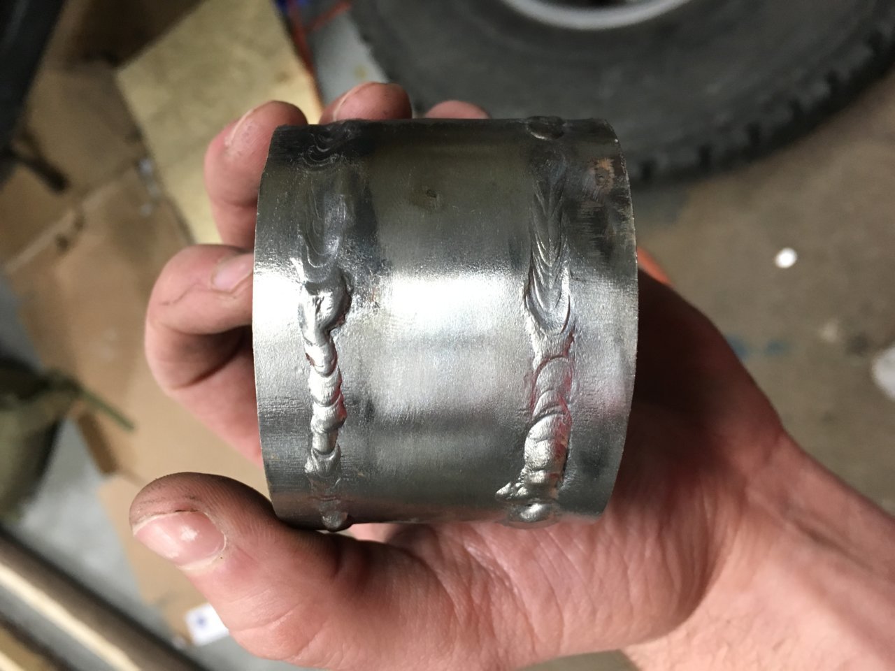

    Practicing tig on some stainless tubing today. Only had one ugly burn through

    Thanks man this was my first attempt at tubing it’s definitely a little harder

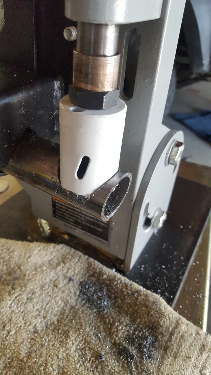

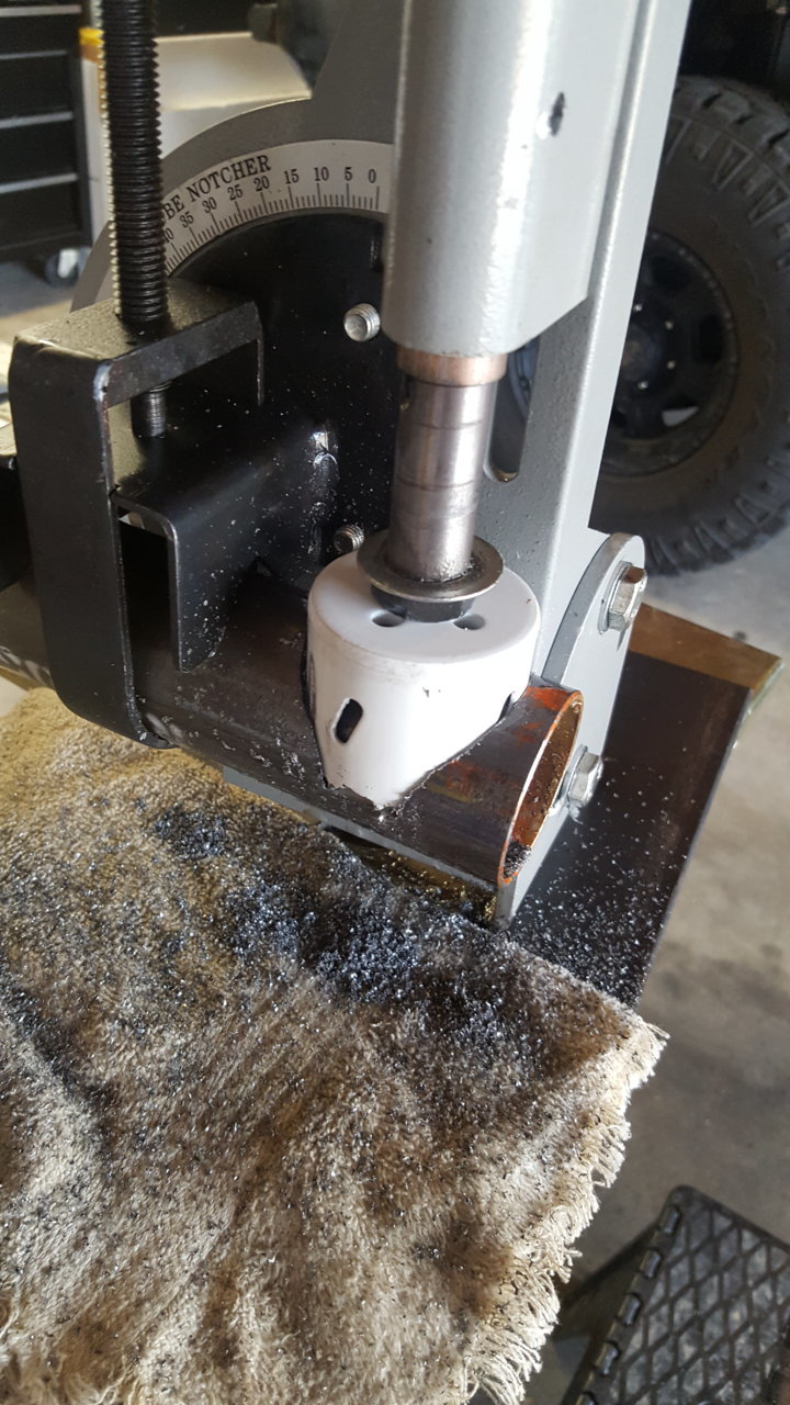

    Notching with cheap tools today

    Is that the HF notcher?
  12. Apr 22, 2018 at 6:51 AM
    #8292

    I'm gonna go out on a limb and guess "yes".

    Mee to just was curious, I was thinking of getting the bailegh one but I though about it and sense I now have a plasma cutter I'm thinking I could trace out the notch and cut it with the plasma? ? Is my logic flawed on this or does that seem plausible ?

    Yes

    Tip for you. Only notch part of the tube. So cut the tube to length first then notch. It will save the hole saw as you are only cutting half as much material. Plus you will not have those very thin pieces that will burn back as you weld it. And use lube. I use lube for broach bits.

    Very plausible. There is a site that you can print notch patterns from somewhere on the web(forgot the name)

    Yeah I was just testing it. The notcher sucks and the hole saws are garbage. :rofl:
    But for $50 total and a few notches I gotta do, fack it.
    I'll probably buy quality hole saws later. I can make the notcher work better with some adjustments
