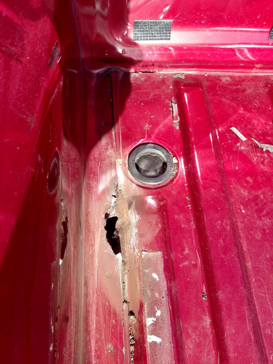

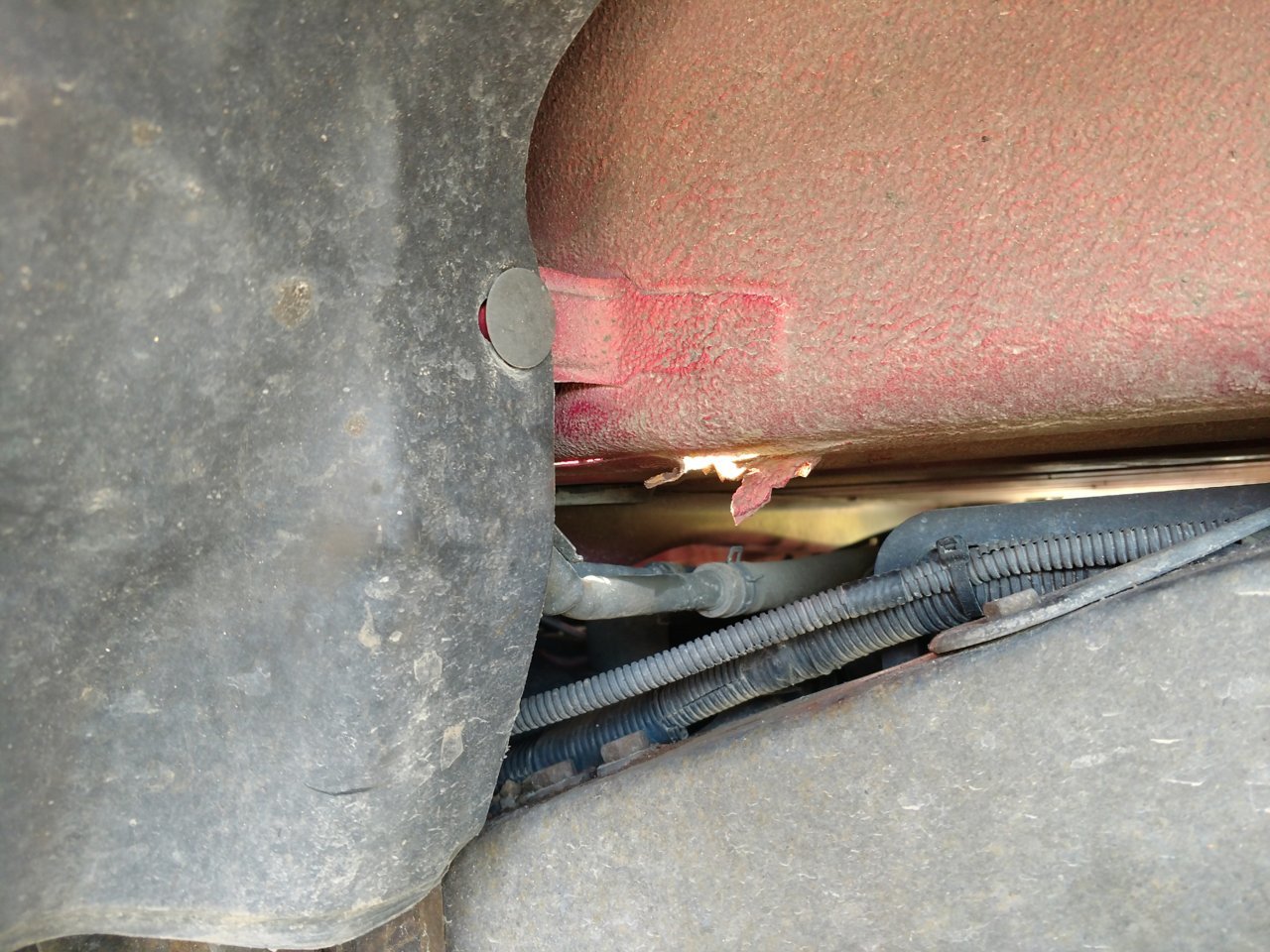

    Also, question for everyone. What are peoples thoughts about welding near the gas tank, gas lines, and brake lines? What precautions do you all take when around those areas?
    In my preparation to apply Raptor Liner this weekend I found a smaller sized rusted through hole (see below). It is on the driver side, up near the cab (dbl cab). I will be cutting it out and have thoughts to weld in a 16ga steel patch. However, as you can see in the pics it is above the tank and close to what I believe are the brake lines to my rear wheels.
    Rather than weld/tac in the patch, I have also had thoughts to rivet it in or some epoxy as the Raptor liner should fill in any gaps and once cured should be pretty solid.
    Any thoughts appreciated.

    doing tacs should be fine you dont want to burn through the thin metal anyways. you could put a wet towel under there to cover the lines

    And a second person for fire watch.

    And fill the tank up. Remember, liquid gas isn't that flammable but the vapors are. I'd probably just hose the area off before I welded. You shouldn't be getting that much radiant heat from welding that thin of steel.

    Thanks. Those are all the thoughts I had as well, just being over paranoid I suppose.
    I do have some spare plate laying around that I could also put in there as a barrier, and also saw another good suggestion of putting a fan under there blowing away from the weld area to disperse any vapors that may be leaking in the area. But realistically, if you ain't smelling it then there isn't enough vapor potential to catch firethere that would catch fire.
    I think my plan of action will be:
    1-fill tank up before I go home to complete the task
    2-stuff a wet towel up in there, and potentially a piece of plate for extra insurance.
    3-person on fire watch and extinguisher duty
    4-tac up the patch in enough places to structurally hold
    5-raptor line it and call it good
