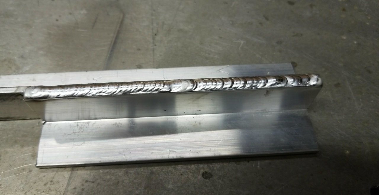

    Had some time for some edge welding practice. 1/8" angle. Thought it looked decent and didn't melt off the edge.
    20180518_220626.jpg Bend test however showed lack of fusion. So back to practicing I go.
    Edit:. 3/32" 2% Lanthalated electrode, 3/32 5356 filler, 105 amps but didn't go full pedal.

    TIG on Aluminum is one of my least favorite things.
    stairgod[QUOTED] likes this.

    MIG with a spool gun is awesome! Once dialed in, you can haul ass. 100 percent duty cycle. No stops needed.

    Our work welder doesn't require a spool gun for aluminum. My world is stainless though.

    Fun and potentially aggravating as hell.
